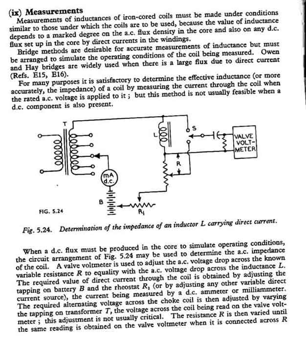

Isn't better to measure it under conditions similar to which the choke is used.
I read this to Radiotron D Handbook.....
Do you have it? (pg250)
It says that "the value of inductance depends to a marked degree on the ac flux density in the core and also on any dc flux set up in the core by direct currents in the windings"

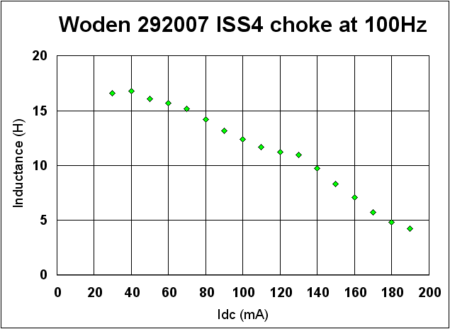

You are absolutely right - a test should as closely as possible replicate the conditions of use. And as RDH4 says, the flux in the core of an inductor markedly changes the inductance, so you need to be able to vary that. But that's down to current not voltage. Here's one I measured earlier...

I had in mind the circuit in the RDH (pg250). Do you have the book or scan it and post it?
ok that's not possible when measuring a choke with a bridge.
I do have RDH4 but it's a bit difficult to get at just at the moment.

Not to much difficult to build it!
What do you say? Or buy a Marconi bridge?
I allready own a Variac that I can use it at the place of the transformer. I only need the variable resistance and the variable current source.
It's not difficult to build, but it will be cumbersome. One problem that Langford-Smith didn't mention is that he's passing DC through his mains transformer. Most transformers don't like that and respond by saturating, distorting the AC waveform being applied to the choke, and causing a measurement error.
The Marconi bridge isn't very good at making inductance measurements of iron-cored inductors, but not because you can't apply DC (you can). The problem (and I was only made aware of this recently) is that it doesn't provide enough AC excitation, and that gives low readings. As an example, the same choke, with the same DC conditions, might only measure 12H on the Marconi, but 18H on an instrument capable of applying a larger AC excitation. You can't get around that with the Marconi because of the power limitation in one of the resistors in the bridge.
