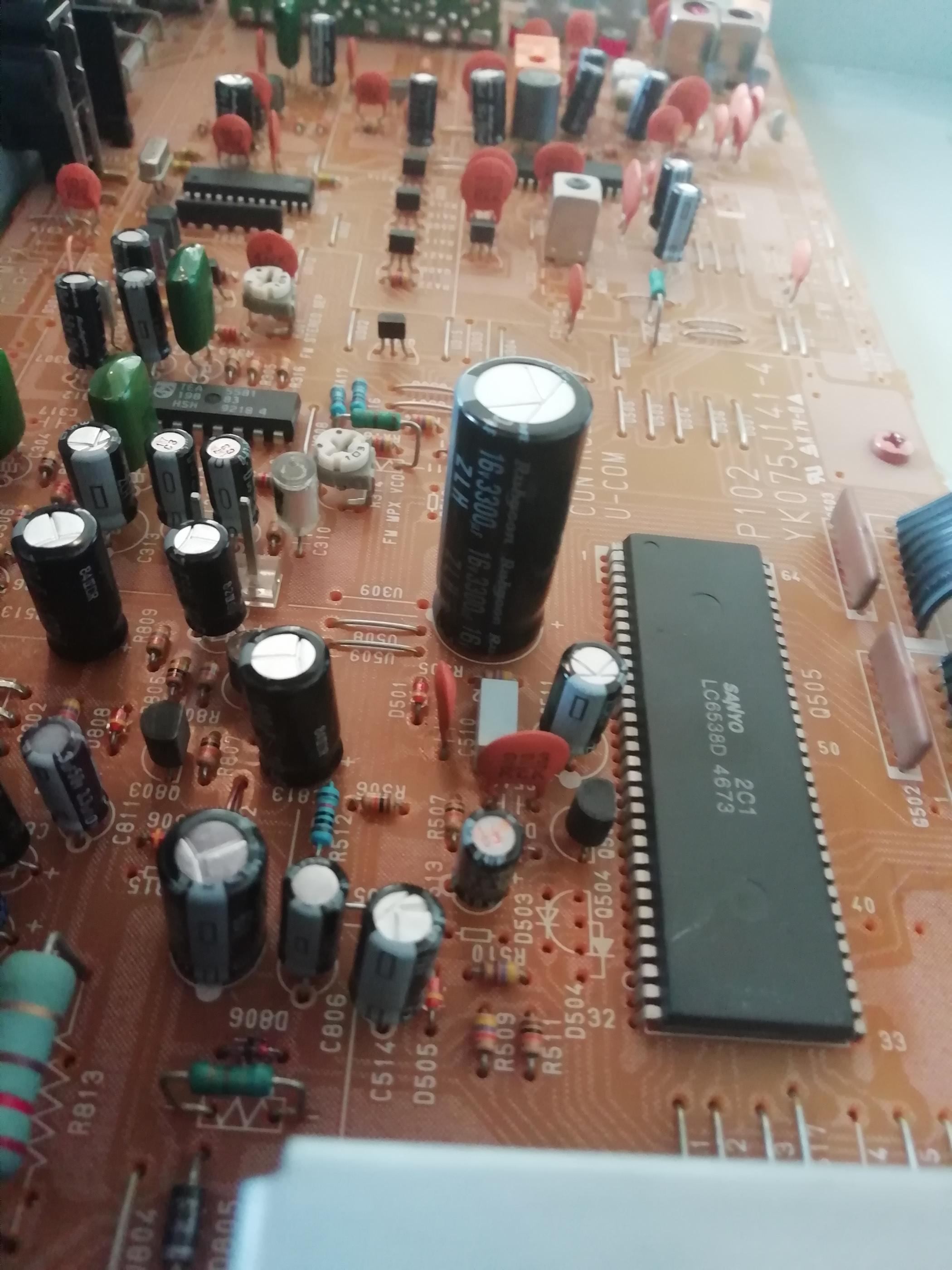

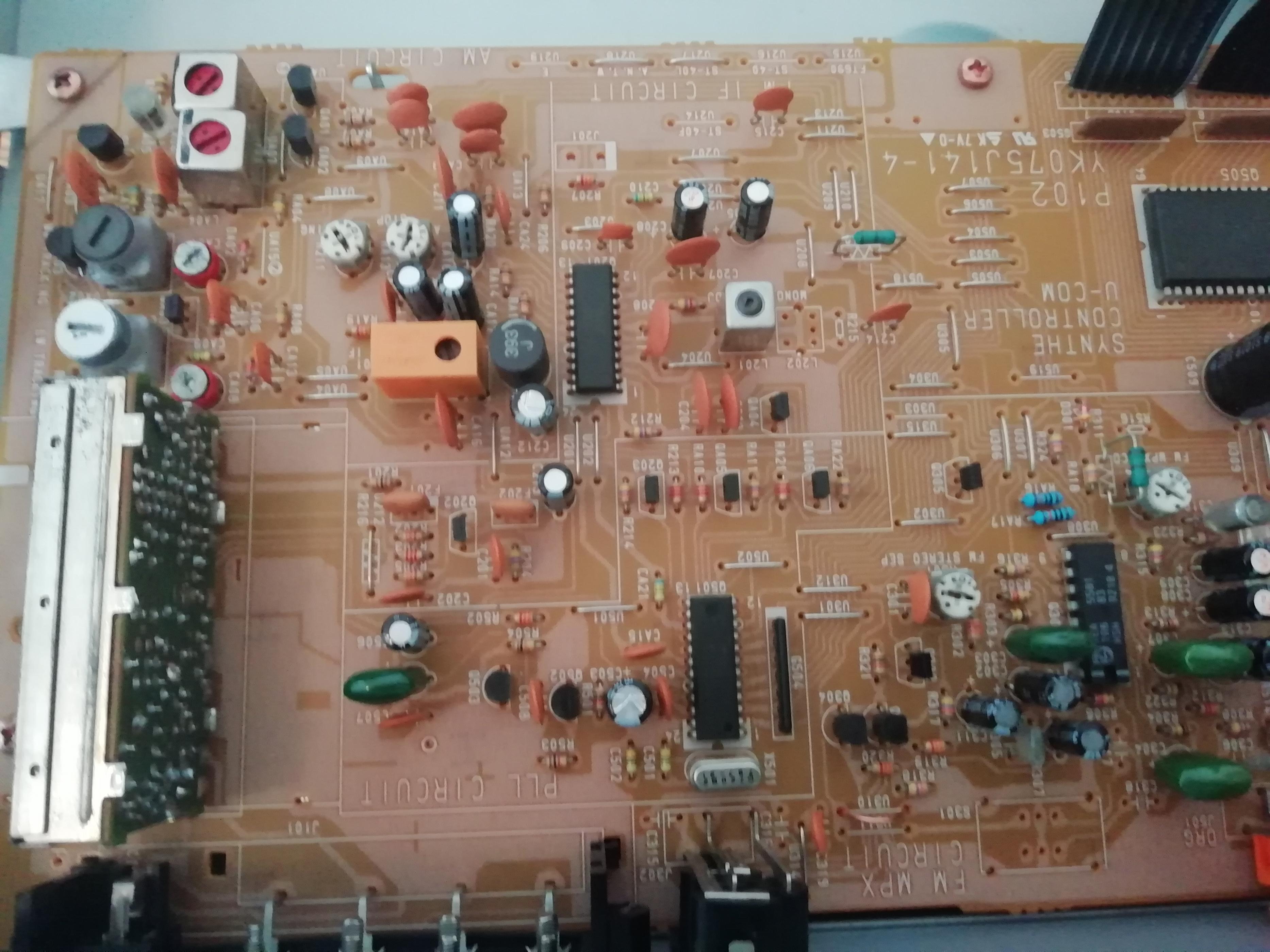

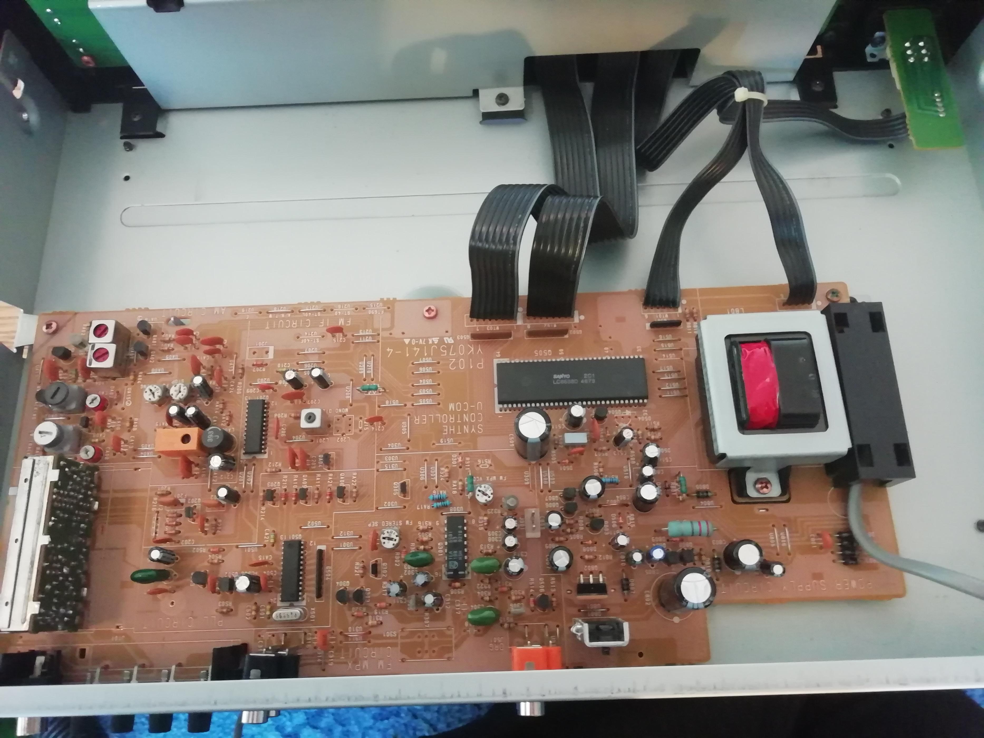

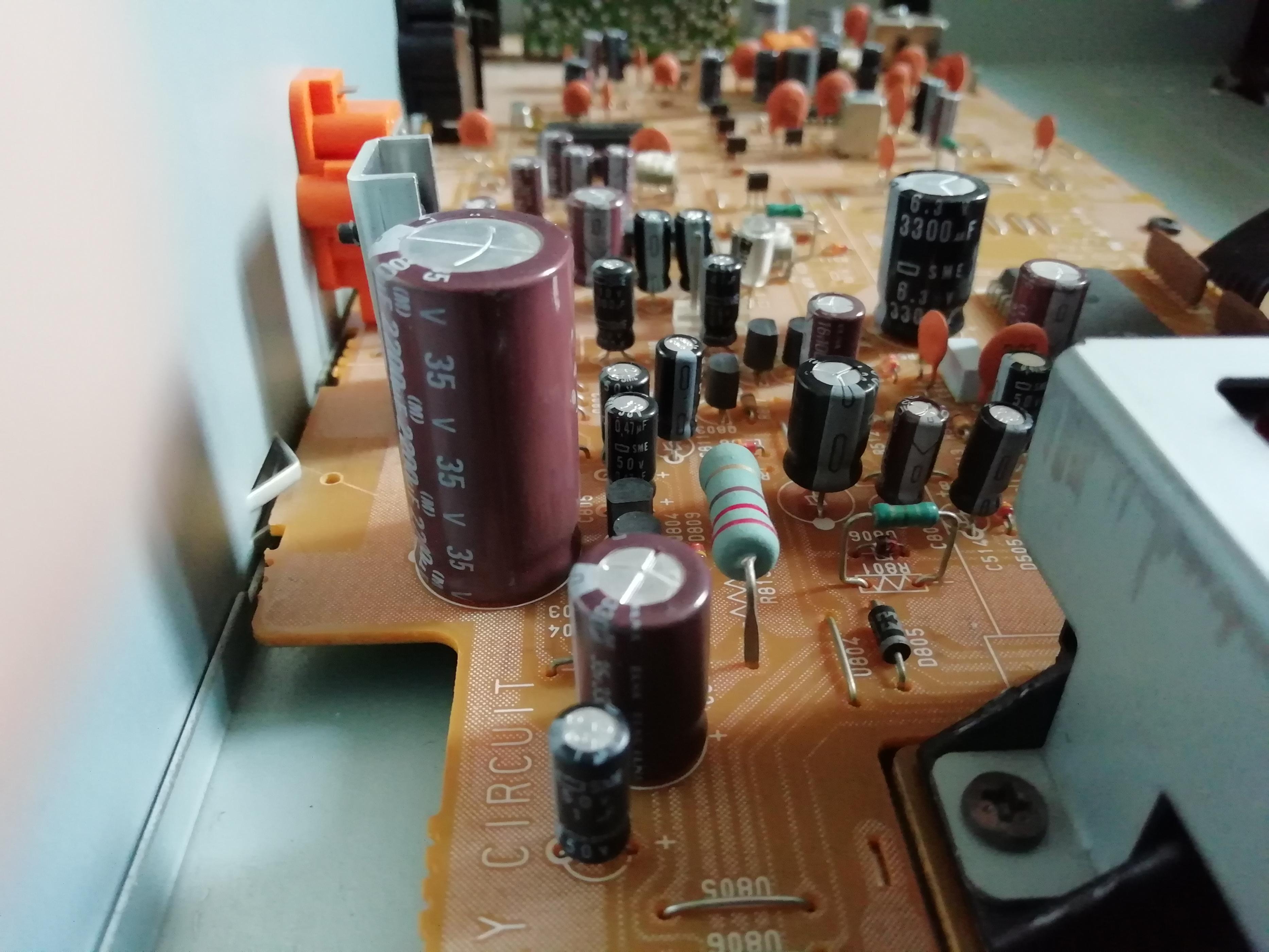

Hello all,
I recapped my tuner just to gain experience and I'm really pleased with the results.
I have not spent additional money on the unit only used the parts I've already got. Most parts were new or pulled from other equipment I didn't need.
I was wondering if anyone can guide me on how to improve it to gain experience
Ive not adjusted the pots or won't be changing ceramic capacitors as I've read it's not a good idea
I have replaced:
PSU caps with some Panasonic FR/Rubycon low impedance/nichicon PW/1 blue Elna and 1 Jamicon
Signal path caps with Rubycon YXF/Jamicon
Reflowed all joints. Transformer reflow got rid of lots of noise and maybe best improvement.
Replaced a few resistors that looked dodgy
Adding dampening under board and under top cover
I changed 4 0.1uF electrolytic caps for the green plastic caps, is this a good idea? I was thinking of changing the remaining five 0.47uF electrolytic caps to small Wimas, is this a good idea?
This is part of my second system so no biggy but appreciate any possible advice, thank you

Fiddling with the innards of an FM tuner is not a good idea unless you know enough about RF circuitry and have the necessary test equipment. Simple changing from one capacitor brand/type to another may do nothing, do damage or (occasionally) make a small improvement. However, you can be sure that the more time and money you spent on it the more happy you will be with the outcome - provided that it still works.

Hello, I have an ST-54L tuner that I also modded some time ago. However, I must say, it was totally worthless, singe all stations brodcast crap music, except perhaps one or two classical programs.
Nevertheless, here is what I did:
I replaced the rectifier diodes to fast (Schottky) types. Also replaced the voltage regulators to low noise types. Replaced the supply filtering electrolytic capacitors to bigger (and hopefully better) types. Strangely all these changes resulted in audibly higher distortion, but it improved by now.
I made another change a couple of years ago: I replaced the two ceramic IF filters and the transistors (better said bypassed the IF circuit) with a piggyback PCB with two 6-pole TOKO linear phase LC filters and the necessary driving transistors. At least it did not became worse, I could not measure it. It sounds good, as before.
The biggest improvement I did is I mounted a ring dipole antenna in the attic. Now I get bigger field strength with is good for S/N.

I understand the antenna is the best thing to improve and got a new aerial before the recap to try eliminate the noise. It improved yet later found out the noise was coming from the transformers solder joint or the 3300uF 6.3uF capacitor with I found leaked and smelly fishy, not sure that was the cause of the noise though?

Changing the power cable will not change the sound, unless the current cable is faulty. The cable from the wall to the device is supposed to be flexible.

I changed those green mylar caps the other day. I could tell the old Elna caps were not at their best by putting in the mylar caps but sound was too excited and fatigued. So I replaced them with Nichicon fine gold 0.1uF e-caps. Sorted that out.
Today I've replaced the remaining 5 original Chemi-con SME 0.47uF caps with Wima MKS2's 100v, two in PSU and 3 in FM curcuits. Also 2 Rubycons were replaced with new lower esr caps.

I'm sorry to be a wet blanket but changing capacitors ahead of the detector cannot possibly affect thensound other thsn by improving selectivity or sensitivity or helping the limiter remove noise. There is no audio to improve until the detector detects it.
