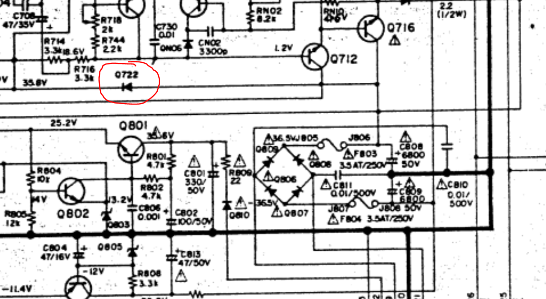

Hi everyone,
After repairing several amps and other hi-fi stuff, nothing yet has stumped me apart from this Marantz! Anyway, here are my findings so far. More to follow tomorrow morning (UK time):
1. Voltage on cathode end of Q722 = 2.66V
2. Some DC voltage readings compared with schematic drawing:
a) Should be +36.5V at Cathode end of Q809, my reading is: 22.5V
b) Should be -36.5V at Anode end of Q806, my reading is -34.2V
c) Should be -28.8V at collector of Q812. My reading is -29.5
d) Should be 36.5V before R801, my reading is 36.3V
e) Should be 13.2V at emitter of Q802, my reading is 3.8V
f) Should be 14V at base of Q802, my reading is 4.4V
3. both rail fuses are OK
4. Right channel at speaker terminals = it climbs from -3.0mv to +3.0mV at speaker terminals. (I measured mV not Volts as I incorrectly stated on my first reply)
Left channel at terminals is same result as right channel.
I'll search for a coupling capacitor and for an input capacitor tomorrow. I am also edging closer to getting a scope! It would make this much easier.

few facts beyond that transistors don't have anodes and cathodes but base collector and emitters (makes other class AB people confused )
The Marantz PM 250 features a mute circuit in the input of the amplifier to provide quite starting that will be ON 21 AND ON 22
Υou may remove those with their anodes and cathodes😀 to bring your amplifier to a no mute state and listen to music from .
Then by looking at the schematic you will understand that this is a simple circuit on the power supply with an RC to produce a start delay
Next to the first facts please add that capacitors inside that old amplifier DO not need checking All small capacitors inside your amp are only good enough to meet the creator ....

Thanks for the tips! Q806 - Q809 are rectifier diodes - not transistors so in effect, they do have an anode and cathode end as it were :0)
Marantz use Q prefix for both diodes and transistors which is a bit annoying.
Anyway, on the basis of this, I presume I should be de-soldering transistors QN21 and QN22? Bloody hell - if all I have to do is just take out two little transistors then that's bloody brilliant!
I will do it tomorrow morning and report back. Thanks for the tip!

Any specific reference points to test for correct voltage on the pre-amplifier circuit? Like a diode, resistor reference, etc? I am still developing my knowledge of amplifier electronics so I'm not 100% where the pre-amp is located. I have an idea but it would be great if a reference point could be supplied also?
More voltage readings - collector of Q801 = 37.9V (should be 35.6V)
before R804 = 8.3V
after R804 (base of Q802) = 4.5V (should be 14V)
Emitter of Q802 = 3.9V (should be 13.2V)
before R804 = 8.3V
Should be full rail voltage. Is the diode open ?

Thanks for the advice everyone - I will check that diode shortly. From what I have measured on the rectifier circuit (diodes Q806-Q809) I cannot get +36.5V. I only get +22.5V.
