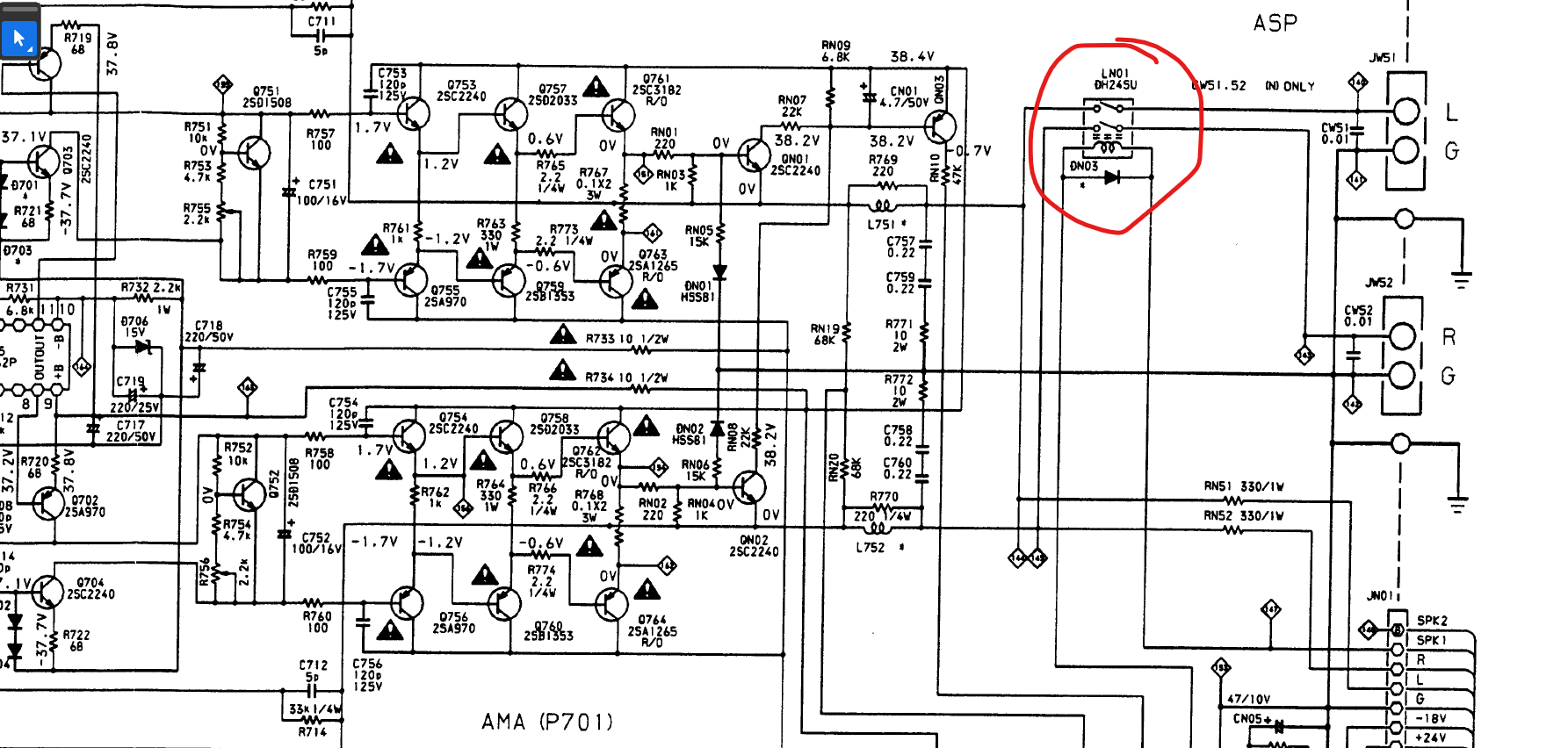

I think it is. I’ll explain how this happened: my Marantz amplifier is connected to two Tannoy Mercury m2 cherry speakers. The aux cable was set up to a 4 port digital to analog audio converter, which then was connected to my smart TV via a digital audio cable.Hazy thinking and I'm wondering if the speaker relay could be at fault
One day I turned the tv on, the amp and the audio converter. Then I heard a boom, there was no sound coming from the system. I turned it on and off and there was no ‘clunk’ sound like before when it was turned on.
I read some forums that this was to do with the relay, the only way I’ve been able to do these tests is to hold a small stylus on the relay so that sound plays through it.
If it is relay (which I think it could be) how would I rule out any other causes of this issue and also how would I fix this issue?

Looking at the circuit and the headphone feed is from before the relay. I'm assuming plugging headphones in also disconnects the speakers. If the sound is distorted/low/fuzzy on headphones then it is not the relay. If the sound is OK on headphones (and the speakers are automatically disconnected and so no heavy load on the amp) then it may or may not be the relay.
If you were to repeat the sine wave test but this time instead of measuring across the speaker terminals you were instead to measure to a point before the relay then that would be conclusive proof.
Low signal before the relay and the relay is NOT at fault.
Normal signal (so 4 volts) before the relay and a lower signal after the relay and the relay is faulty. You can see the relay and also the speaker terminals to the right of the relay in the diagram. This time you would measure between ground and L751 or R769 and L752 or R770 to the left of the relay. Those resistors should be easy to spot and measure to. Either end of the resistor would give the same result. If the signal is low on the resistor then the amp itself has a problem and not the relay.
This is the relay:
