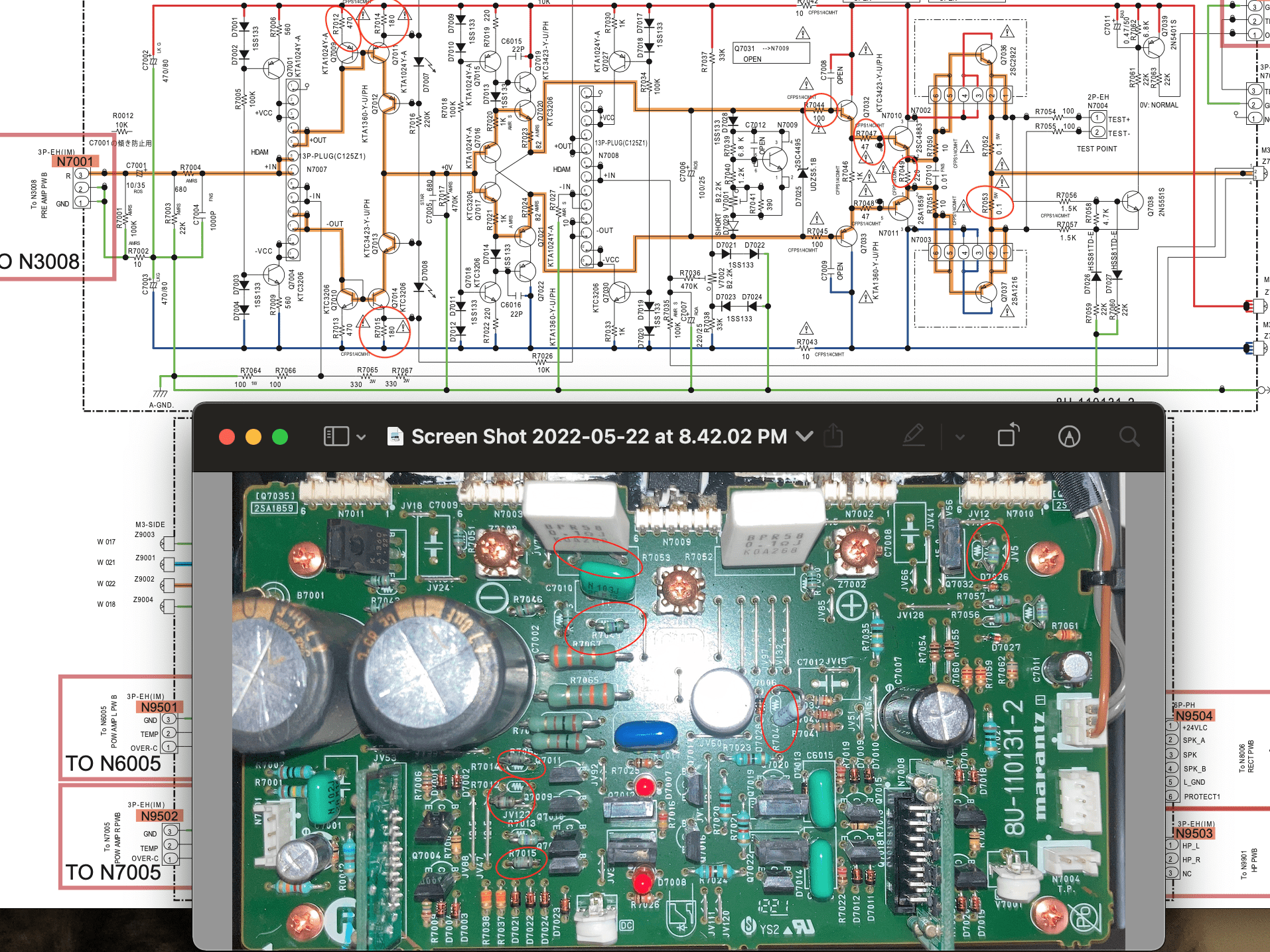

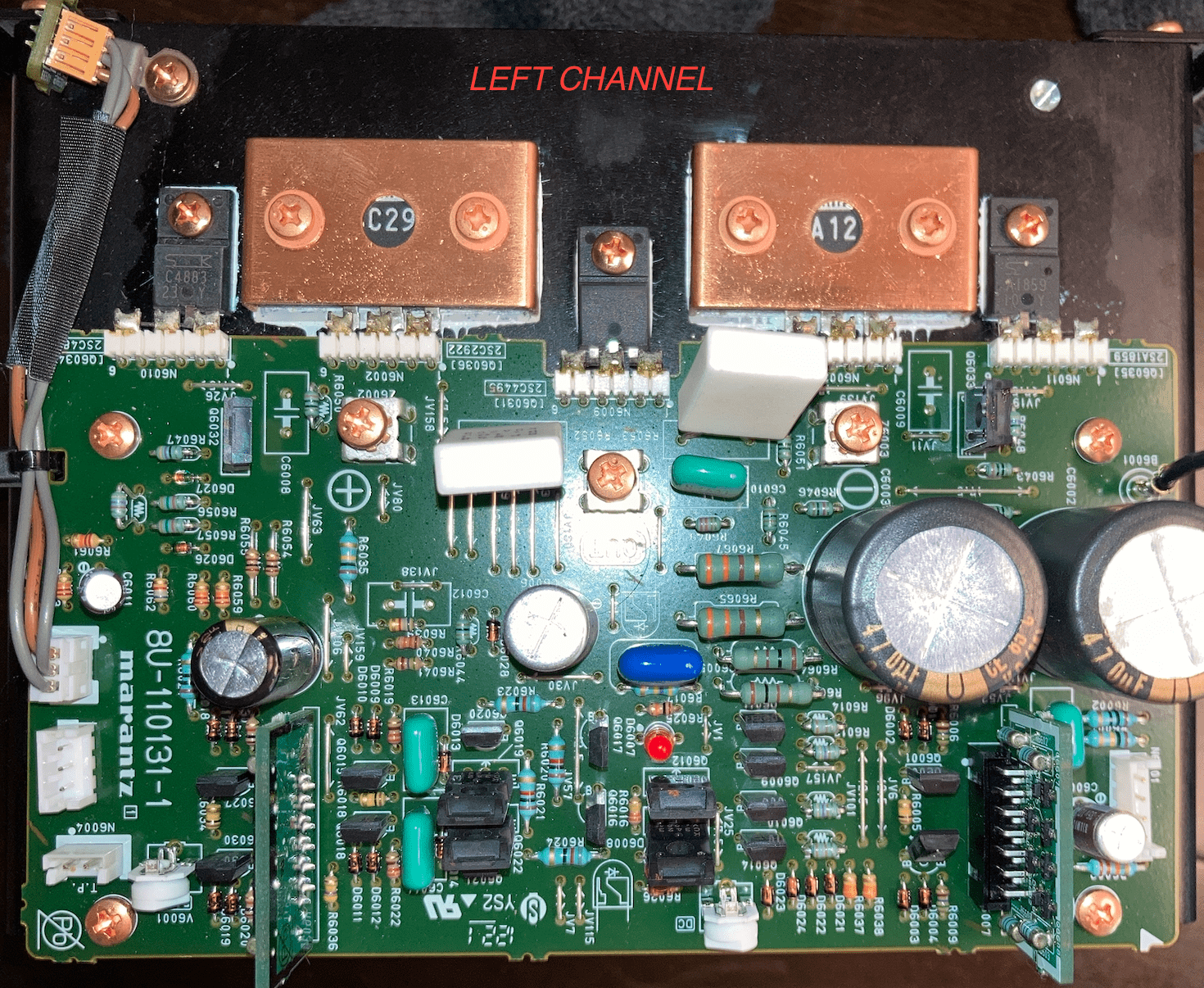

Hello folks,
I have a Marantz PM-11S3 that was purchased for parts with a bad right channel. I managed to turn on the amp to verify the left channel amp stage is working by measuring a 15mV idling voltage before the protection circuit puts the amp into standby mode. The right channel idling voltage was a whopping 9V before the protection circuit kicked in! I'm focusing on repairing the right channel amp stage. I am using the left channel amp stage and service manual as guidelines. So far I've found 7 resistors that were burnt, out of tolerance, the wrong resistor value, or in the case of R7053, broken (open). The back (foil side) of the right channel amp stage board reveals most of those resistors were replaced in a previous repair attempt, except for R7053. It is puzzling that some were replaced with the wrong resistor values. My plan is to replace all the resistors circled in red, and see what happens.
I have verified the driver and output transistors on the heatsink pass the diode tests (diode tests across BC and BE). I realize these Sanken devices are no longer manufactured and difficult to find, but for the moment I'm working under the assumption they are undamaged.
My question is in regards to film resistors that have been notated at "critical". Should I follow what's written in the service manual or what was actually manufactured?

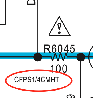

The service manual clearly states:
"WARNING:
Parts indicated by the ! (in a triangle) mark have critical characteristics. Use ONLY replacement parts recommended by the manufacturer."

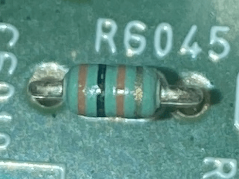

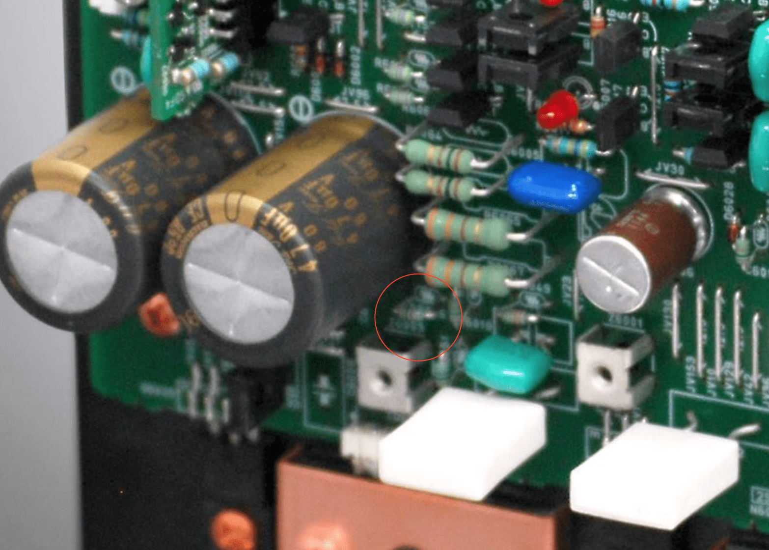

For example, on the working left channel R6045: The schematic calls for CFPS1/4CMHT, which is a carbon film flame-retardant resistor. In the photo, R6045 appears to be a metal film resistor based on carbon = orange/brown metal = green/blue. Also, I found a stock photo, compliments of Crutchfield, which shows what appears to be a metal film resistor.
Should I follow guidelines in the schematic or the manufactured part? Or are these actually carbon film resistors in blue/green?

Yes, those are flame proof resistors. Unfortunately, I haven't found the whole lot in stock under that manufacturer KOA Speer (CFPS1/4CMHT)Usually that means flameproof or flame retardant resistors. But it's difficult to tell from their appearance.

The marantz service manual match the amplifier. I have one. Remember those resistors fail for a reason. Doble check all parts with a meter before change parts. If you have skill try to test the VAS isolated from output to avoid more damages.

How do you know the resistor in the photo (R6045) is KOA Speer CFPS1/4? That's what I'm trying to find out. I haven't found one example of a Carbon Film resistor in green/blue. All seem to be orange/brown or a rusty red.Yes they are KOA Speer CFPS1/4. CMHT is just the form of the leads. Mouser have CFPS resistors in stock

The purpose is to protect the output and driver devices. This is why higher power resistors are not the best for that position. I think, that any flameproof 1/4W carbon film will fit in that location.Ha, ok thats the ticket! thanks 🙂 . Mouser only has 47 and 470ohm in stock. I'm trying to find 47, 100, 180, 220 and 470ohm in stock. Would you recommend these Stackpole resistors from Digikey as possible substitutes? They are flame retardant and so far the only one I can find in stock.Example -CFM14JA180R
