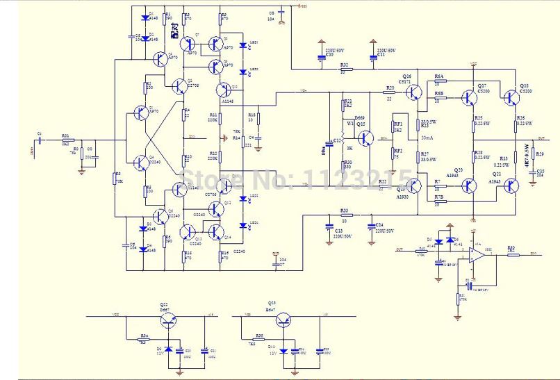

MA-9S2 Balanced version clone
Similar boards have been around for a long time. They are certainly not clones, as they are not balanced and the circuit is much simplified. Strictly for the adventurous.
The ones I have found on Ali Express are 99% similar to the schematic diagram from Marantz's service manual, they look like one side of a balanced design. Is there anything stopping me from buying four to put together as a balanced stereo version?

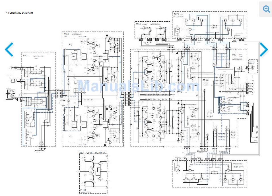

Getting a bit tired of this argument. How can the two be the same, when there is a ratio of perhaps 10:1 in parts count alone. And it isn't just the more outputs or the balanced topology. What do you think that little forest of HDAMs at the input is doing? Do you see the nested feedback?
Perhaps the Ali circuit works well but its semblance to the amp upon which it is supposed to be based is only superficial. Similar to the Accuphase disaster but perhaps even worse. With the Accuphase i put in some effort to simulate the theoretical performance of the Ali circuit and it was orders of magnitude below the original because of really poor design. Not curious enough here.
I have the kits as well....Looking at the traces on the PCB's, I'm not sure it will withstand the currents with loads lower than 8 ohm.
Also looking at the service doc of the original design, the circuit has been simplified to the absolute minimum and now is only a shadow of the original.
