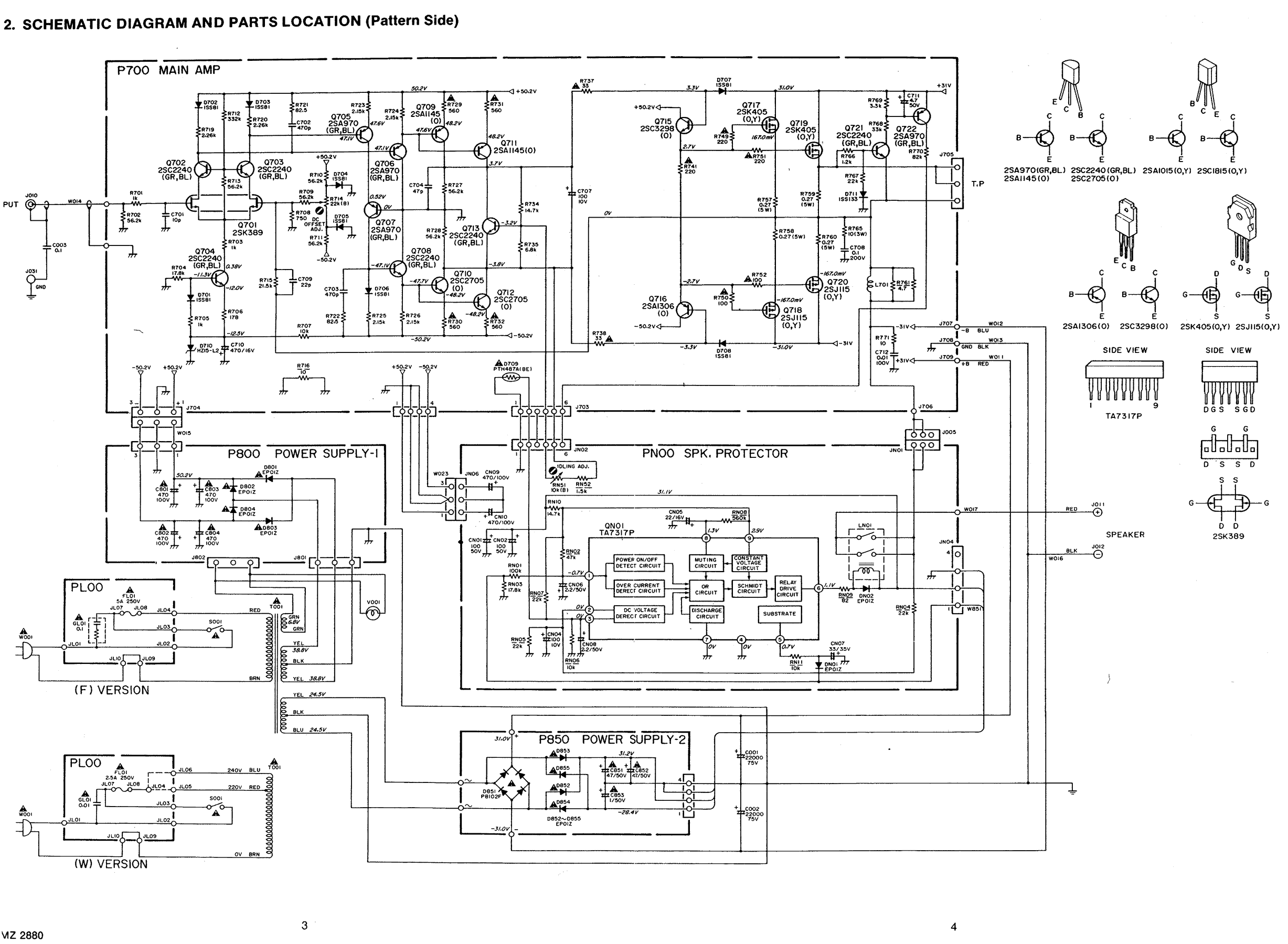

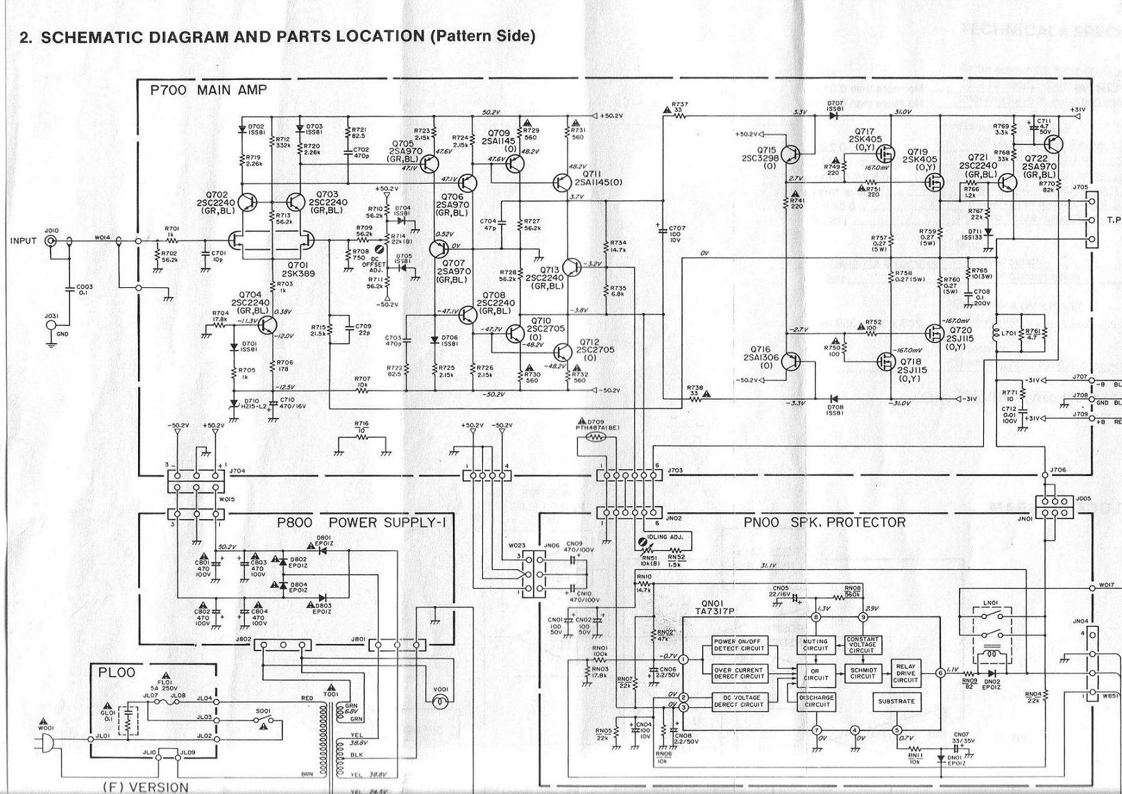

Strange things on those circuit diagrams, P-channel MOSFET 2SJ115 were connectet up side down and drawn as N channel.
naah
usual mistake
anyway - who's going to make da thing from scratch - is able to even ignore that type of mistakes
in any case - tnx for pointing that

and then I'll edit that drawing mistakes for Q718 & Q720 , and post edited schm here .....

The output-stage powersupply ended up, per pole, with the original 'ELNA for Audio' 22000/50 plus 2 times 2200/35 BG-VKs, a 100/50 BG-K, and a '1.47' uF SoniCap Platinum. Voltage-gain PS* ended up with, per pole, a 680/65 BG-F, a 100/100 BG-std, a 47/100 BG-std, and a '0.517'uF SoniCap Platinum. Both rectifiers are now sets of Fairchild Stealth diodes. Have replaced decoupler C710 with a 470/16 BG-VK, Rs757-760 and R765 with Mills MRA-5s, C708 with a MultiCap RTX 0.1/200, and will replace R771 and C712 when I remount the Cardas bindingposts. I have some UPOCC stranded 14g. wire coming to replace internal PS wiring; I'll use AQ's silver-over-OFC-copper spades on those. Captive powercord is a twisted pair of solid 12g. UPOCC copper in PVC with a Furutech FI15MER (rhodium over OCC copper) plug. I stand each amp on 3 Herbies Tall Tenderfeet.
The system now sounds breathtakingly smooth--NOT gritty or edgy--AND transparent...the best it ever has. This has been worth all the money and time I've spent on it. 😀
* The schematic show 3 times 470s per pole; actual was one 1000/63 ELNA per pole.

as I wrote in PM :
offset 0 - set with pot marked as R714
Iq - set to 167mV across source resistor (any of them) , with pot marked as RN51
if that's not enough - post pictures of amp in thread and we'll help
