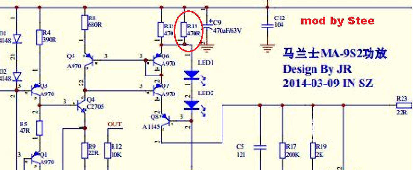

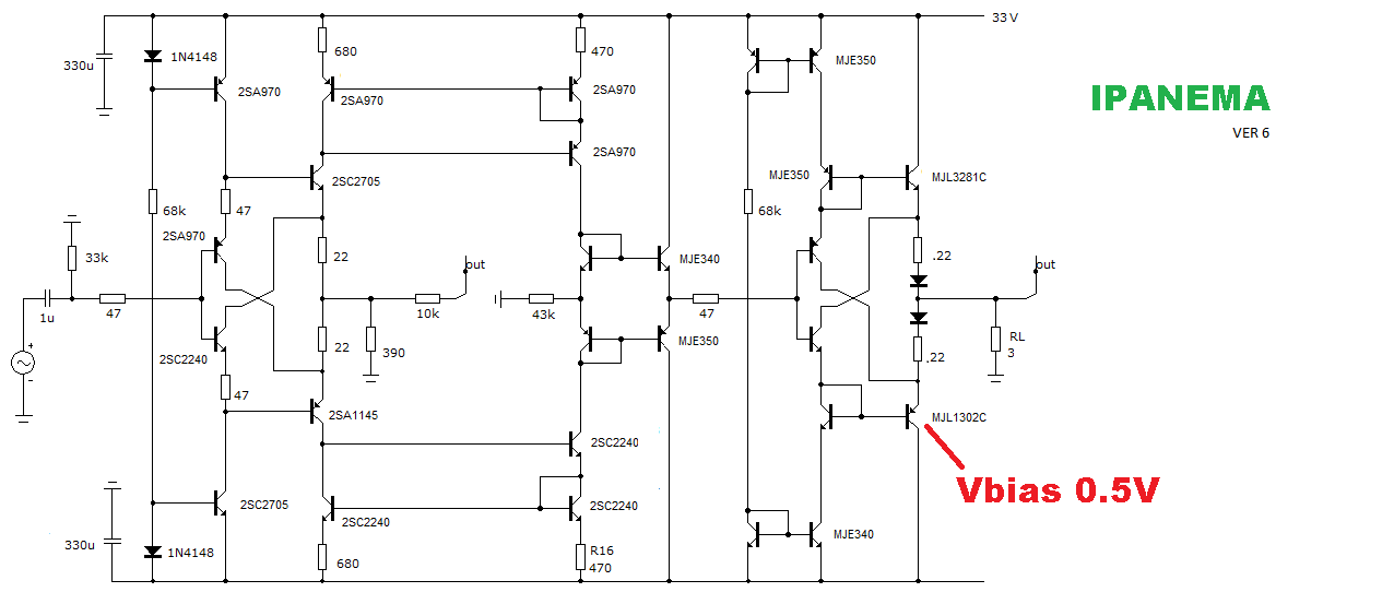

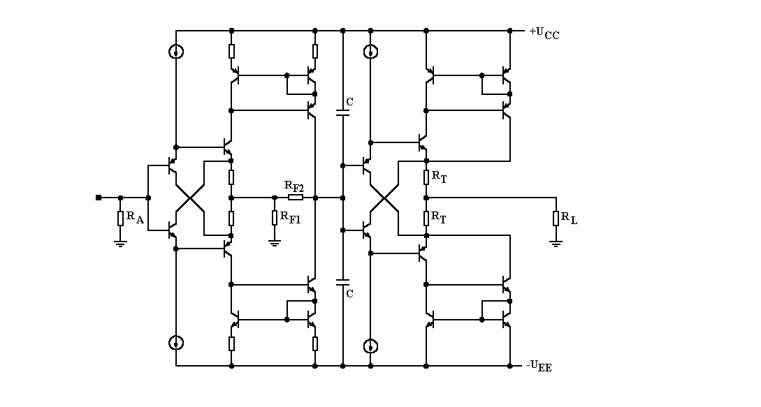

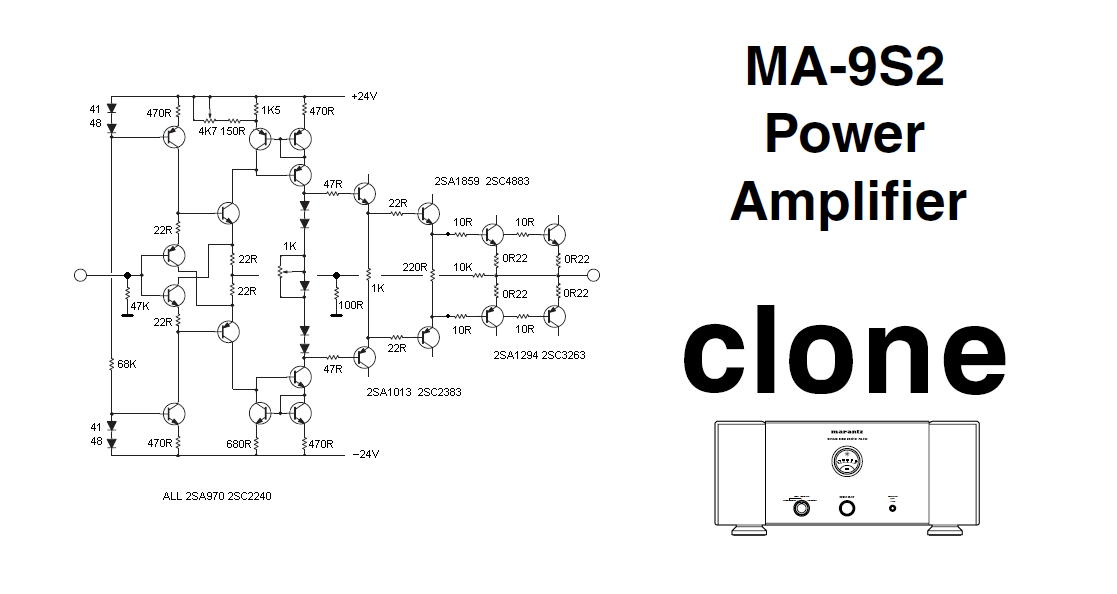

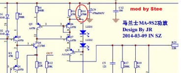

Marantz M9 clone in bridge
This project is intended for connection to bridge with input transformer
have diamond input solution and very low feedback (set to 40dB) 🙂
