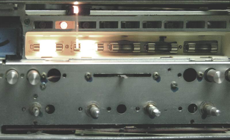

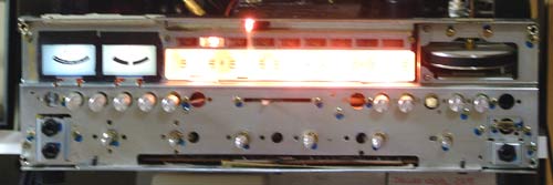

i needed bulbs for a reciever i got off of e-bay. found them at
radio shack cheap to‹x_Vao"7ýL¤ûsµj%`áÒK²P- 4QI8-¤wé7³kX+Þõžm ôÔÿÞ± KÒ“®ê"ÄÚžyóæy<&x;˜D³ûC¸šÝŒáÃ]|�×ðý�g‘ïf·ðS³Õ†™$…bš‰‚pßÞz½7'A¦sn)I{�fšÓ^ʶá*eFB®røn_sª dZ— úyÅÖ]/¦ IUæA" M ÝõÚ—p�»*�IDm–Yù«ê~_ ¥YÚ}×>kŸ�Ÿš‘{µ4Ž€o¦³Œæ4yI4›sú$Ä=UÖIé-§ ·%ízš>j?Qv¡?Ü×7'µOÓ(žŒÇý0nôÃé°MÆ“¸§áû_¨uùÜ"ŒãÉÇʤe4ùûÍÉt8F3‹8šÜΣðæz|ß�?¨LIAê¡d„ׯ(_SÍRW¨sCQÉ&„u™^ÿ9ì@»]>š©=�*H_F¿ÿOînƒhd>–ÀløiÆÃ°Íù’åJÈì�ß9äÿÀï[ɄΊ‡:„�5Ãr¢©y%‰fkjYíñÎð¹¸p †�L¬©|¶¾X˜ôÝúiB4¢8àÝ Bß�_ qÐÏ(Ô £Iή'·(DAŸaøŠ÷ªH©D6{® µÃj| YM½Â³’¢ö5žÂ1ÕJ«c€T›:Ó‰àâ¹Ö#û8=š$M%-ùÖì¼x¢»xjŽÈUx;Ø™ ø <Þ�ÉßvwÒÖ=±uŸ½V÷ÎA±¿(V}«Ô€Ç¨©þ¤G‹ôy%4VÌIò°”5hؤ;ƒóÁùhx ýI<š£î6ðà�œ¥Æ=ðmçÀ¶g>�Ÿ™Þ‡/s‘na¾´H]ïÔ‰æ�SÉ4œtx`'óçûUN:''vÀ–Z”O‡ÂÍlXª3gå&2Ê–™éœ-ÛÕæ²à×RÓ;T_ï<˜ ‰µÙõ0HB9W%IX±¬Æ%îî~¼¾x�~„³%’K°ISiiùbÖ;£œ¥)v\äP ´‘,“ ÞvdªàF‚c!wyüŒi8L“eÍ„xÅøˆ/–=L%B‰R]¯Xx¨Uo–<œ[±Âª“`ï™bùîqbÃ8Ç^°�9^ä�¸3ÆÒ™5áz:£@ÒœLiI4"dD�¢œ&ØÜŒ}.Pq‚‡ná0ʘ2WyÝÆ¶¡ª0¦2�¯A·F@ŠôÙC딩’“-*ñ"ÅÍá[ËÊd#Ê“ Íù“X»´�”Ø8¢©À"oþuÚ•¾QÌ mÅ~ªŸBý À]ÒE×û–+;â ó˨¤À6}Œ] ‚ÛƒyoCÊŸ(–TºŠ®Õ~@y�ƒ„¹¼%!TY_²Ò"ÇÛ>Á”¶Fµ ‘V³Ÿ Q— þ–=üOâêÒ×¶ˆpl Ô–•[...😉
Looks great. Where from?
I looked at All's site today because I need fuse lamps also. The 8V bulbs are $1.00 ea and $.85 in quantities of 10-up. Sorry for my error.
