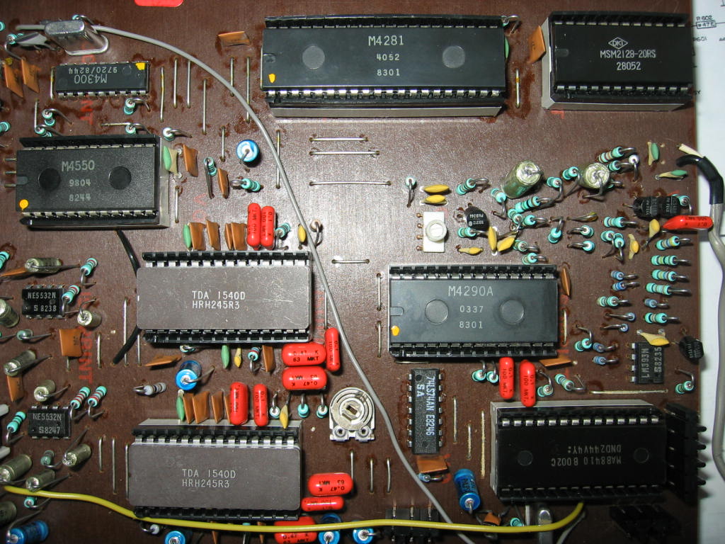

Hi again.
I've just had a look at the decoder board and it has completely different chips to the ones listed in the circiut diagram.
As my knowledge of electronics is limited to descreet devices, I have no idea what to make of it all.
I have attached a picture of the board, and here is a list of the chips that are on the diagram;

Apart from the MAB chip, the others appear to be completely different.
Any idea's?

Greetings!
It is normal, Philips 300\303 and Marantz 73 have two variants of execution, with the decoder from Philips with a set 7000/7010/7020 and executed on a separate payment with chips Sony, (the second variant more musical). Probably you have a scheme 2 variants? I can send you on e-mail service a manual of 1 variant.
