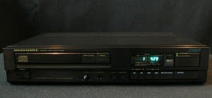

I have one CD65 player from Marantz.
Step.1. I want up the laser power ,but I don`t know from where.I work with cd,dvd roms,dvd-rw`s ,but in this case I can`t find the trimer for this.This player have a problem with the mechanics,but I can repair this.
Step.2. I can`t find any mods for this beautifull Marantz. I want maximize the sound quality,because I know that my player isn`t perfect in this situation.

I fix cd/dvd players as a job and if you need to turn up the laser that means its week which means it needs a replacement because it wont last long if its turned up

I think that I have a problem with my laser or with the motor ,but this is may be problem with the media.With one good disc- Verbatim Audio CD Vinyl my player start OK all times.When I listen this disk 10-15 minutes and play any other disk the result is that everything is OK.
When the first disk is Sony,Princo or any other brand,I listen one song and I hear one snap in the player+ error on the frond display.

Is this the laser? "1vo0055" it’s out of my Marantz cd-67(yours is a cd-65) I don’t know if it’s the same I think it’s made by Philips?

This is all for my player from google:
MARANTZ CD65 SAA7310 TDA1541 CDM4/25
MARANTZ CD65 II SAA7210 SAA7220B TDA1541 A CDM4/19
My laser is very different.I want know :
The laser regulator trimer is on the same laser or on the PCB.
If anyone can help me -fine!
The problem is: My Player work the first 20 minutes: can`t play anything,all media.I have only the red "ERROR" on the front panel.
The CD-Motor work,may be great I don`t know,I can hear the laser ,but the player is dead.
After this 20 minutes my player work great with all media. May be laser is very low and I want find the trimer.I know that my Player is produced by Philips-may be I have any soldering problem?

That is a very different CDM 12. CD67 is much newer than CD65 which has CDM2 or CDM4 ( if it's a CD65 Mk II ).

Guys Pls Help!
I think that I have a very big problem with the PowerSupply.
The transformer is very hot for 20 minutes+one big filtering capacitor - 6800uF/16V. Now the player is with one new 6800uF/25V and I have the old situation.All others parts are colds.I have many ceners in the PS Block.What is the probable problem in my case when any part mat be overload the transformer?
This help will be very urgent may be
EDIT: The player can`t work fine the first 20 minutes with any media when the transformer and this big capacitors are colds.After this 20 minutes the transformer and the capacitor are very hot and the player works fine with all media. I hear one very specific noise from the laser when the player can`t read,may because he try to read but without any result
