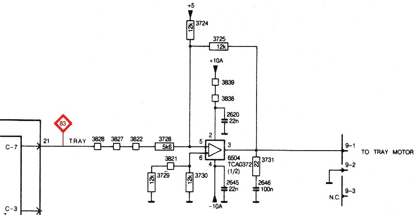

There are a couple of relevant parts from the service manual. Here's the schematic for the tray motor drive:

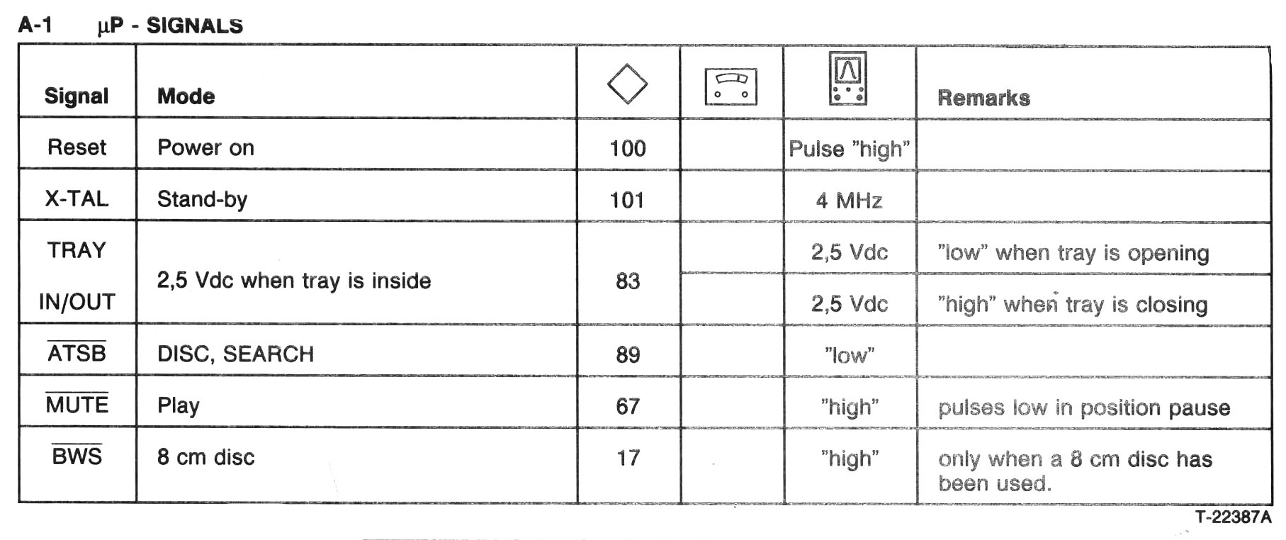

And here's the table including the expected behaviour at test point 83:
What I'm seeing from this:
  • When the draw is not moving the voltage at 83 should be 2.5V. This is probably some sort of square wave signal with a 50% duty cycle.
  • When the draw is opening this changes to near 0V, when the draw is closing this changes to near 5V.
  • And then the TCA0372 power opamp inverts this and cancels the 2.5V offset, somehow, hmmm ...
At this point I realised this schematic doesn't make sense. It's incorrect. Resistor 3729 is between 3821 and +5V, not 3729 and ground like it's drawn.
Anyway, here's what I would check:
PinIdleTray going outTray going in
6530 pin 212.5V0V5V
6504 pin 30V5.4V-5.4V
Another couple of voltages to check that shouldn't change:
  • 6504 pin 4: -10V
  • 6504 pin 2: 10V
  • 6504 pin 6: 2.5V
All these are measured relative to ground.
Let us know what you see.

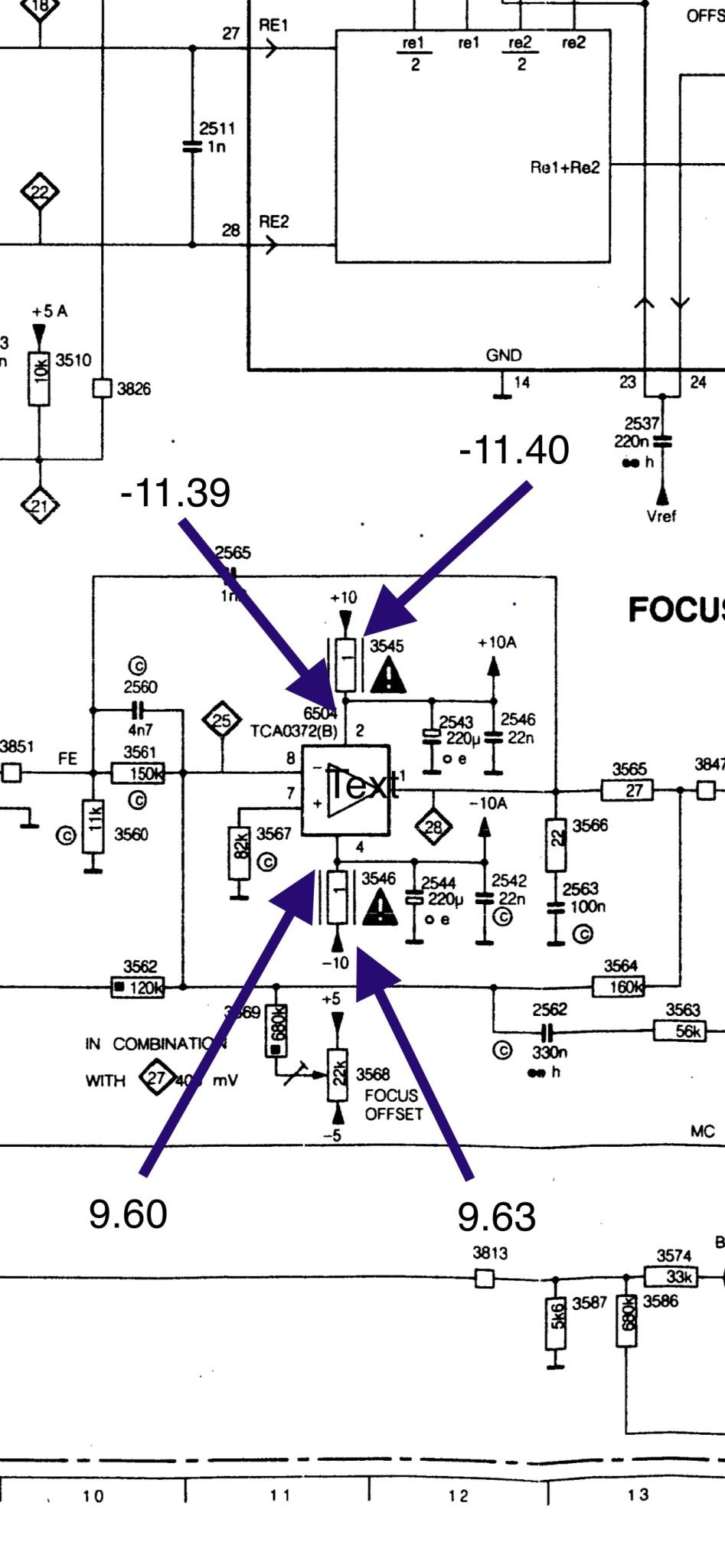

I’ve attached a screenshot of the measurements across the resistors as instructed.
There is no voltage changes at any of the pins on 6504 when pressing the eject button however the resistance between pin 5 at 6504 and pin 21 on the microcontroller 6530 is very high at 10 m ohm. Perhaps this is where the problem is.

High resistance between 6530 pin 21 and 6504 pin 5 is a problem. This should be 5.6kΩ, so I'd be checking 3822, 3827, 3828 and 3728 to see where the issue is. Also:

To confirm, pin 5 has a healthy 2.5v but drops to 500mv as soon as it arrives at 3728.
Also pin 21 has 328mv and drops to 0v when eject button is pressed.
Hope we’re getting closer. Thanks for helping.
Hi @amc184 Update on the above. I made an error measuring.
I should of reported that I have 2.5v on pin 4 and this drops to 500mv when arriving at 3728.
