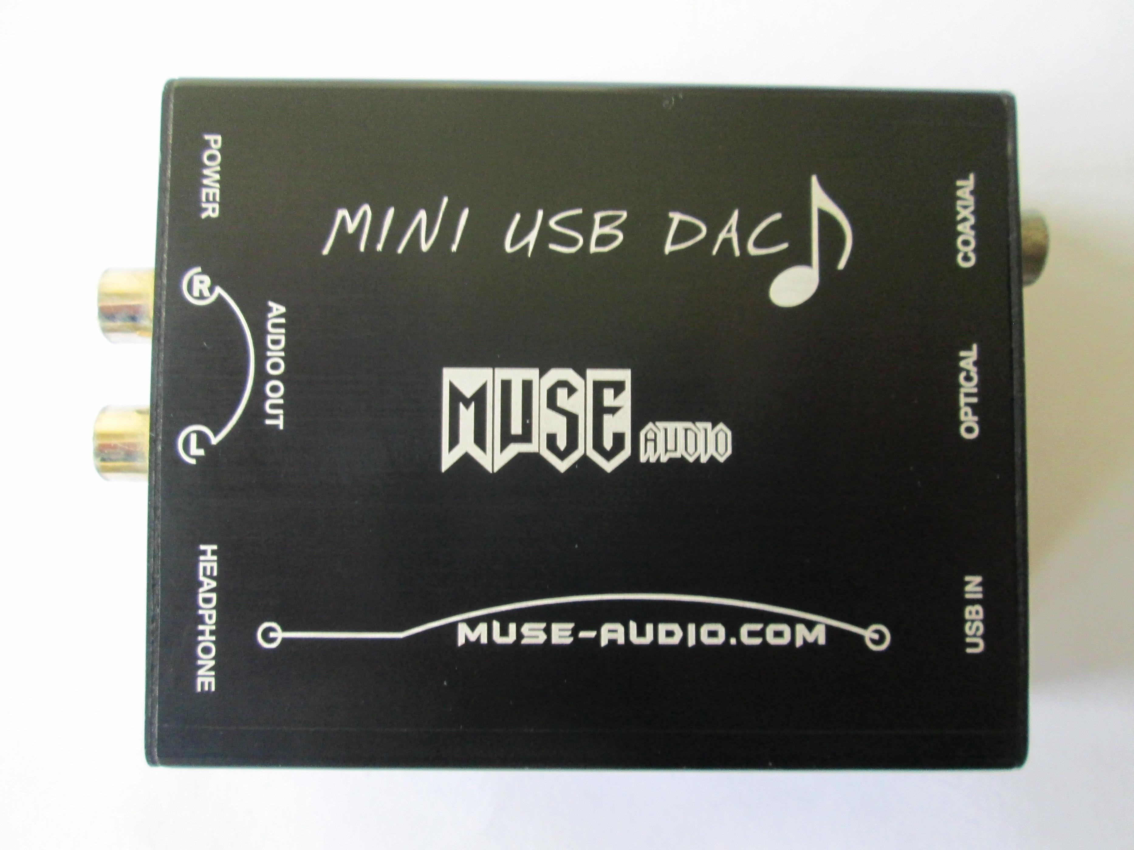

Why is the DAC in my old Marantz CD32 so much better than the stand-alone Mini Muse DAC that I use on my computer? I can rip a CD to my computer at 320 and it sounds like crap when played back through my Mini Muse DAC, compared to the original CD played back on the Marantz CD32. I thought digital music didnt lose anything when it was copied, that it was exactly the same? I don't have a digital input on the Marantz to compare my computers MPEG files through its built-in DAC. Is there a built-in program in CDs to discourage high-quality CD music copying? Is there some way to copy a CD to playback the exact same way as the original? I know there is FLAC which is better than MPEG for copying. I would like to know if anyone has heard of any new developments or hacks into the high-quality reproduction/copying of CDs? 😀
You might not be comparing apples to apples here. Is your Marantz feeding the same amp as your Muse Mini ? Computer DACs suffer greatly due to common-mode noise from the computer's SMPSU, in contrast CD players tend to have linear power supplies.
Yes, they're both feeding the signal into a Sansui AU-11000 amplifier, then DCM QED 1A speakers. The signal and power are both input to the Mini Muse on the same USB cable, there are 2 other inputs on the MM, a Toslink and a Coaxial but it makes no difference if I connect either of them up, the music sounds the same? There's no other power input except for the USB cable. I must be missing something here?
I don't think I've ever played with a Muse Mini but it could be quite similar to the Muse 4*TDA1543 right? DACs powered by USB power are normally very susceptible to the quality of the 5V, which from most computers is of abominable quality. By which I mean very noisy with PC-generated artifacts so that even mouse movements can be heard when feeding the DAC into headphones. Try using an external USB power supply with the same DAC, preferably one which uses batteries or next best, a linear PSU.
Yeah, that sounds like the best way to go, I just have to find how to re-route the signal from the USB cable to the Toslink input?
Something like this? https://item.taobao.com/item.htm?sp...8nbKs6p&id=42732879567&ns=1&abbucket=2#detail
or install inside isolated DC-DC, there are many choices from DCP0205xx or DCP0105xx series with some regulator ... I used it in my dac ..
I'm not sure that I can add another power supply to this DAC because the signal comes in on the same USB power supply from the computer? The DAC does have a Toslink input connection and a coaxial input but I can't get any info on this bloody thing so I'm throwing it out. I'm going to start looking for a decently priced DAC that is known to sound great.
redrooster, also be aware that the USB decoder in your Mini Muse - a PCM2704 - is mediocre, and this is a limiting factor in sound quality.
