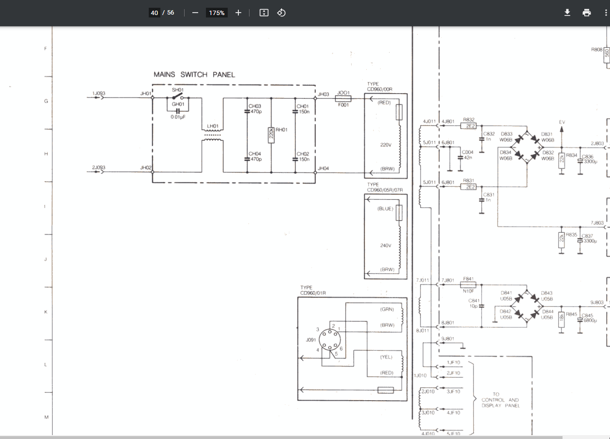

Hi all,

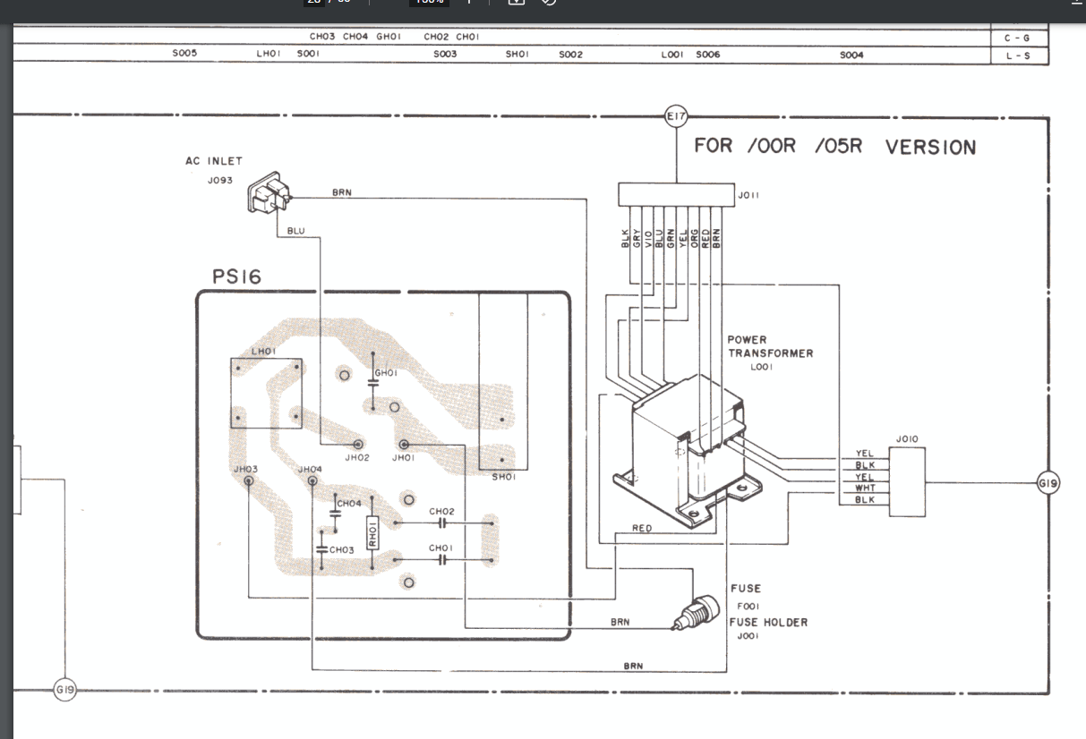

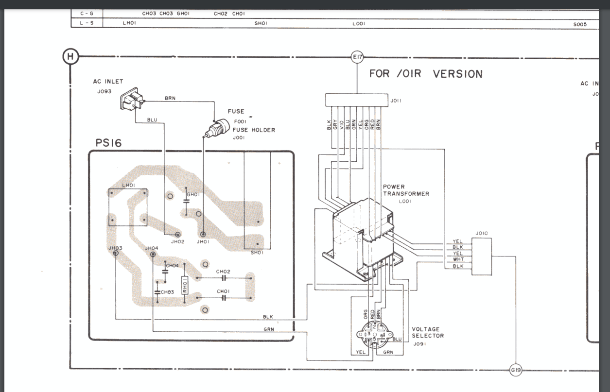

Sourced a UK model which has 220v and 240v operation. For it to work in US I used a step down convertor of 110v. Looking at schematics am confused and wondering if this would be as easy as rewiring or not. The transformer part is the same but I see the switch is different. Any guidance if I can wire it to 110v. The relavant part of the schematics is atached

I think the switch is not your problem. Please check the ratings as written on it. It has just a different PCB when used with the 3 wire primaries EU transformer but please check the ratings. OK, when that issue is eliminated there is the transformer itself. It either has 115/230V windings or it hasn't.
Just found out the EU version has only 220/240V selection so 110/115V is not selectable and the transformer has no 115V winding. Then the most elegant solution is to find a US transformer for the CD94. Or accept the step up transformer. See it as a curse for not buying local 🙂

Philips CD960 should be the same as far as power transformer goes, so maybe sourcing replacement part instead step-up transformer?
