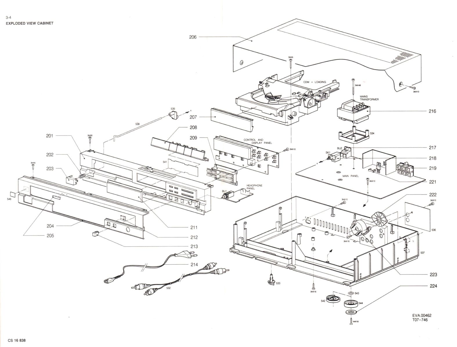

Richard, I've emailed the service manual to you. When taking the player apart, make sure you do it in a static safe way. In particular, do not put the mainboard down anywhere apart from on a static safe mat, handle the mainboard by the edges (avoiding touching the components where possible) and short the contacts of the laser mechanism's ribbon cable as soon as you unplug it. The easiest was to do this is to paper clip a piece of tinfoil over the end of the ribbon. These precautions are important, ignore them and you are likely to damage the player.
As for taking it apart, I'm not familiar with this exact player (though I have serviced many that are similar), but the normal order is:
- remove the top cover
- remove the front panel
- slide the disc tray out
- remove the disc clamp
- unplug and remove the laser mechanism (remember static safety)
- remove the loader mechanism (the frame that supports the laser mechanism)
- remove the mainboard, noting that it may be held in by screws accessed from the underside and back of the player as well as the obvious ones (remember static safety)
That should cover it, if you run into any problems, post it here, preferably with photos, and I'll give you more detailed guidance. Also, who are you planning to get the replacement electrolytic capacitors from? If you let me know I will be able to help you to buy the best capacitors for the job.

Again, I've got to stress that this player uses a CDM-1 Mk2, which is actually a CDM-4 variant. It does not have any servo PCBs attached to the laser mechanism, only the same brushless motor PCB used on other brushless CDM-4 variants (such as the CDM-4/11, CDM-4/36, CDM-4/53 etc).
I've posted the exploded view for a very similar player, the CD65 Mk2, which only differs in that it uses a slightly different loader mechanism (because it uses a CDM-4/19, not a CDM-1 Mk2). Some vital statistics for the CD 75 Mk2 for those interested:
- Laser mechanism: CDM-1 Mk2
- Servo chipset: TDA5708 / TDA5709
- Decoder: SAA7210
- Digital filter: SAA7220
- DAC: TDA1541
- Microcontrollers: MAB8441 / MC68HC05
As a footnote, I don't agree with the prevailing opinion that the Philips made axial electrolytic capacitors are significantly worse than those made by other manufacturers. They just happen to be used in a very critical application (directly filtering the drive to the laser diode) where loss of performance results in the failure of the player. The other electrolytic capacitors in the player can be just as bad, but will only cause a loss in performance, not total failure. Interestingly, the other capacitor that often fails in these players, the 1.5uF bipolar electrolytic that filters the radial motor drive, is a Nichicon. I replace these with a 1uF film, problem solved forever!

Hi,Again, I've got to stress that this player uses a CDM-1 Mk2, which is actually a CDM-4 variant. It does not have any servo PCBs attached to the laser mechanism, only the same brushless motor PCB used on other brushless CDM-4 variants (such as the CDM-4/11, CDM-4/36, CDM-4/53 etc).
