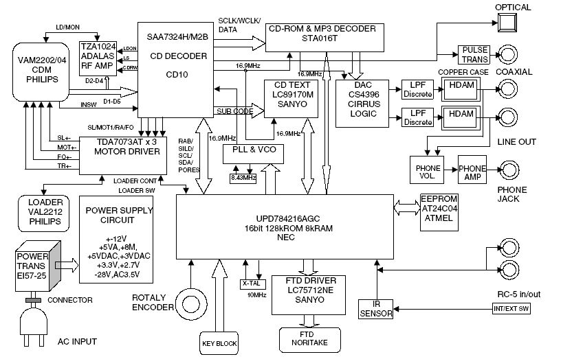

clock distribution is totally different. Dac's masterclock comes from the MP3 decoder's pll and that gets it from the CD decoder. Decoder again from pll with xtal and fed with scl/sda signals coming out of the CD decoder. Eh.
DAC has dig filter inside and output filter. Output buffer is 2 hdam modules in series.
I'm not throwing out my cd63😀
I get visions of the dac's clock being altered by the mp3's samplerate 😱 Not shure bout that though.
Anybody has one? Does it sound good?😕
Still wondering if it is that bad. Clock upgrade will be useless, you need to alter clock distribution for that. Maybe the mod here is to kick out the mp3 chip.
Dont know the dac.
Anyways, a picture tells more than a thousand words😀
There is more from where that came from btw😉
Dont know the dac.
Horrible architecture ! And they keep using HDAM modules that sound and measure worse than an average OPA134.
An additional PLL, VCXO based, just in front of the DAC chips will help.
