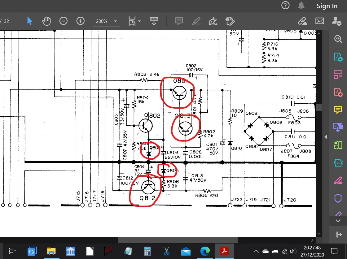

Both channels suggests a common power supply issue. So just looking at the circuit (and this is purely intuition without seeing it) and I would have a close look at the two 'series pass' regulator transistors and the components around them.
Have a really close look for bad soldering. Torch and magnifying glass if needed. The last images in post 1 of this thread show what they might look like where the solder cracks and forms a ring around the pins.

Look all around that area on the board for any signs of heat (which isn't a problem in itself) because that causes the joints to fail.
