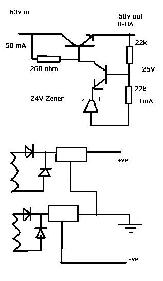

Traderbam, I think i know what you mean.. thats a nice idea this would eliminate the need for an NPN driver for the negative supply regultor.
I have made a diagram of my proposed regulator circuit and have added a diagram of what i thought you were saying in your transformer wiring post.
If you could check it out for me id be grateful as using all NPN's makes it a little simpler to design.
Do my values look correct for the upper transistor regulated circuit?
PS. the pass transistor is a darlington not the single transistor as indicated in my diagram.
Cheers
Craig
Cheers
Craig

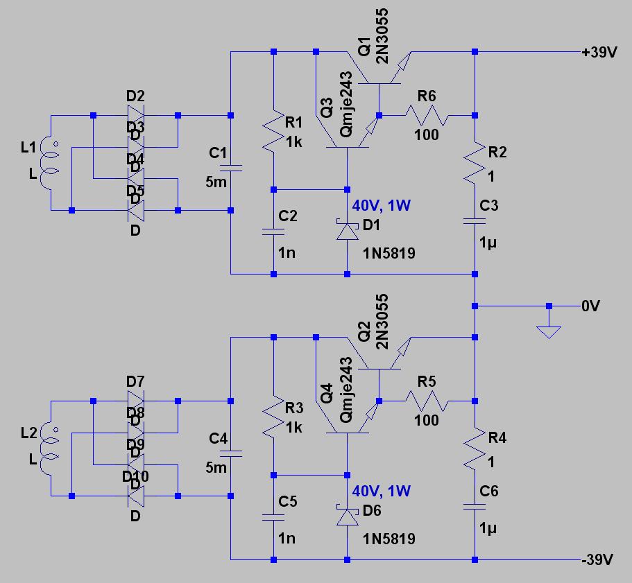

Craig,
Yes, that is what I meant. I've attached the sort of circuit I had in mind. This is simple, cheap and will behave itself.
The 2N3055s are beefy but slow so the R2-C3 are needed to smooth the output impedance at high frequencies. C3 should be rated at 63V or more. C2 should be reated at 50V or more. Use 1W resistors for R1 and R2 and a 1W zener. I'm not sure what transistors you have so I chose an MJE243 for Q3. Let me know what you'd want to use here.
To get more sophisticated will take more parts and careful design because you'll need a feedback system. I am happy to help if you wish to go this way. I think your Maplin modules will sound fine with this circuit.
BAM
BAM
