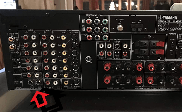

You absolutely can re-purpose an old AV receiver as you envisage. Just ensure that processing features (filters, effects, time alignment) are disabled or, at least, that they do what you intend them to do.
Ok. Thanks. What about to connect optical input off yamaha receiver to mini pc optical output? I really cant find any dsp programm for windows and really not shore if it works? This programm looks good but only for Linux https://t-5.eu/hp/Software/Pulseaudio Crossover Rack/You absolutely can re-purpose an old AV receiver as you envisage. Just ensure that processing features (filters, effects, time alignment) are disabled or, at least, that they do what you intend them to do.
More modern AVRs don't have analog multi-ch inputs, but fortunately RXV-650 has! It's YPAO settings have some options about processing, but they must be bypassed.
Tried to install on windows 10 but the program does not work. Just not strating installingThis seems to have good feedback:
https://github.com/HEnquist/camilladsp
