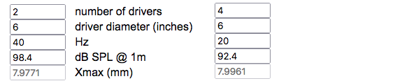

Since you plan to use the subs for mixing at frequencies below 100Hz, and you seem to value transient response, I'd suggest using sealed enclosures rather than Helmholtz resonant based enclosures like bass reflex or transmission line/Voigt pipe variants.the model is just a simple proxy, enclosure design is in anticipation of a tang band W6-1721 although for space I may have to go for a w5 and Im quite happy with both of those both xmax and general value
Since your SPL requirements seem modest, the 6" mid bass Tang Band W6-1721 may be adequate, four could reach 92dB peaks at 20Hz at one meter with no room gain without exceeding Xmax.
I'd consider flat to 20Hz a minimum for a serious control room application this century.
If you want +14dB peak headroom over 84dBA (slow) down to 20Hz, eight W6-1721 would be required.
You would need around sixteen W6-1721 if you wanted them to keep up with a 90dBA (slow) mix level.
Probably better to use fewer larger drivers if you want to hit full scale low frequency peaks without too much distortion- Xmax is ~10% THD.
If you are interested in accurate reproductions of other's mixes, I'd suggest stereo subs.
Reverse mounting the drivers would reduce their voice coil heating (which causes the voice coils to heat up and impedance to rise "thermal compression"), but if you allow ~30 liters per driver, heat should not be a concern with music with "normal" (as we grew up with) dynamic range. The suspension and vent noise of even the best drivers may be distracting at high excursions.
Shape really makes little difference in a sealed cabinet below 100Hz, if you prefer the aesthetics of spherical constructs, your imagination and skills are the only limits.
