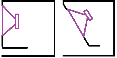

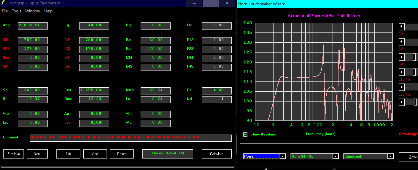

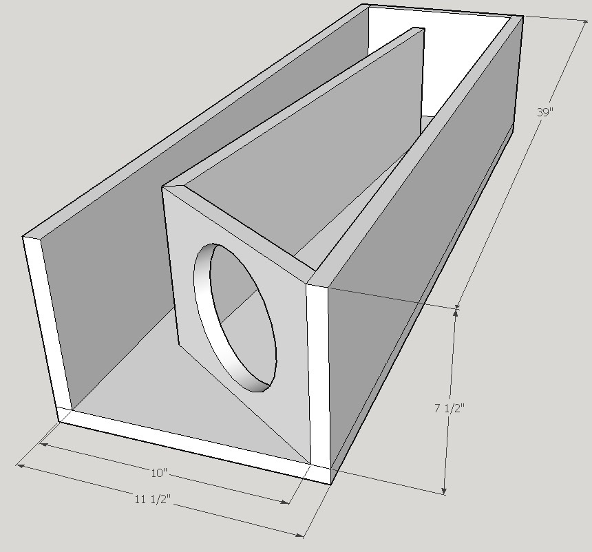

Hi, i have a simple question... i have seen bass many reflex design with tilted speaker facing BR duct:
Now my question is: is not a full horn, but is still not more a reflex... depending to speaker angle.
How response change? how can i simulate it pratically ?
Someone can help me to understand this design?
Is not only about duct shape or area, my question Is also about effect that woofer do facing on It.

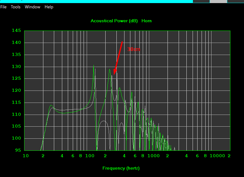

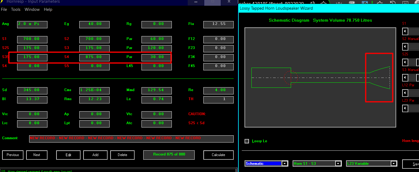

(My example is a lot ‘longer’, so I could see what might be happening at lower frequencies in horn response )

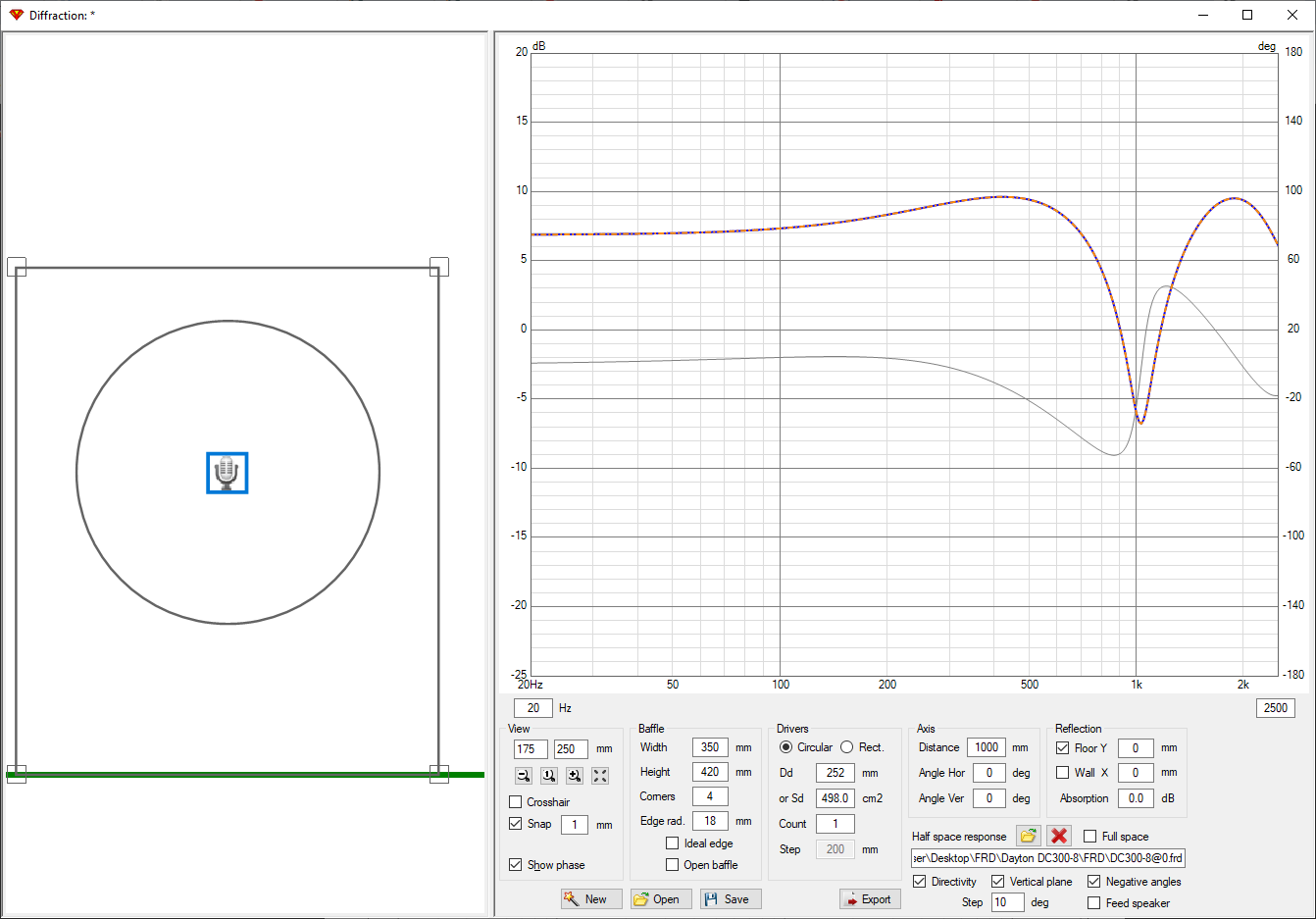

It is a normal reflex, the excessive flare would hardly do anything.(My example is a lot ‘longer’, so I could see what might be happening at lower frequencies in horn response )
The driver would be 20 to 30 degrees off axis. And with a ground plane the response is flatter.
That sim shows resonance of a typical fart tube. Or a port that is too long.
looks like wrong alignment for the woofer shown, and not modeling leakage with the excessive Q in the lowend response.
Assuming the vent would be a everyday slot port, sharing 3 walls, end correction would be the usual 2.27
which would just make the needed length slightly shorter like any other slot port
This is just diffraction of a 12" on baffle, with a ground/floor plane added

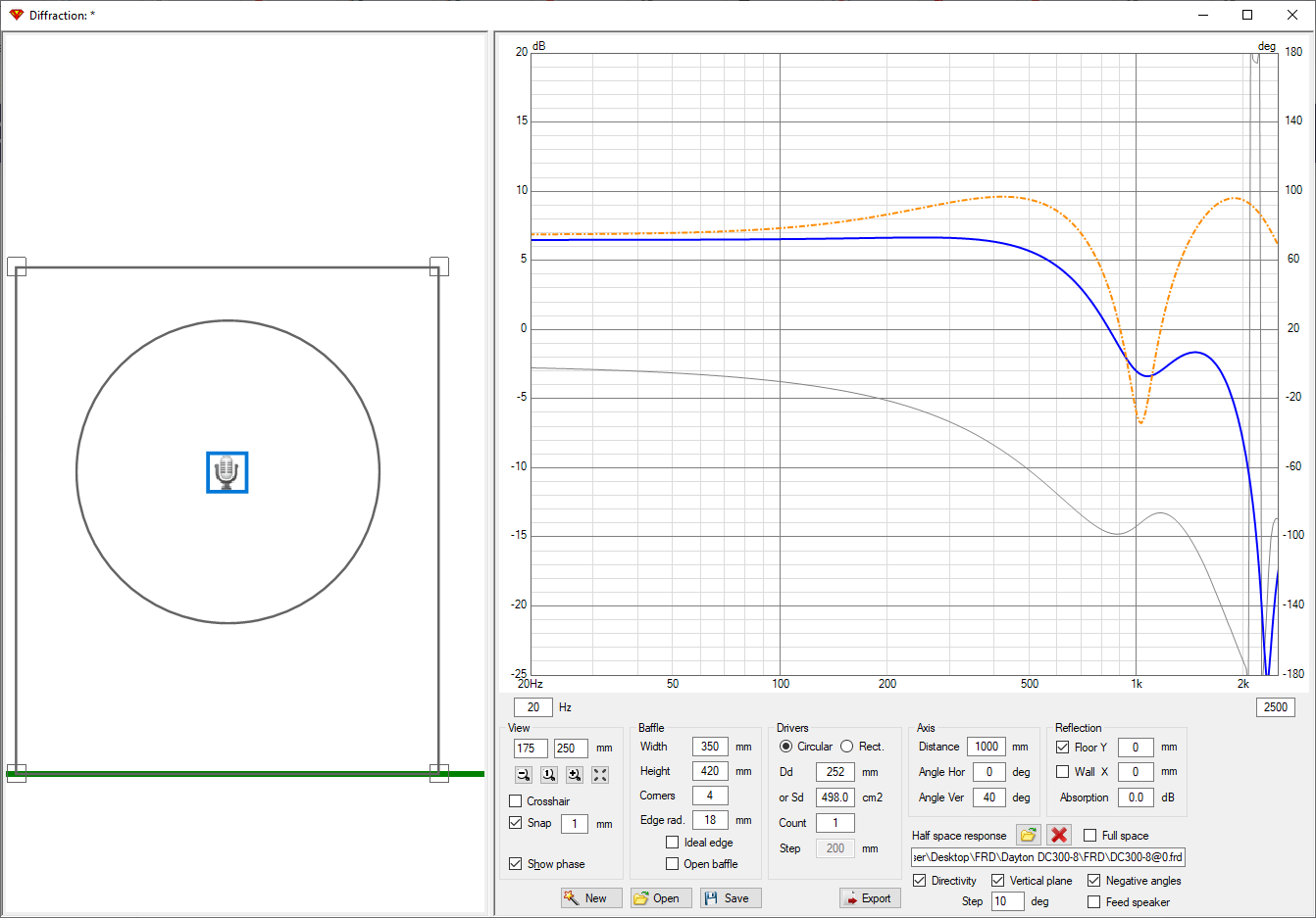

This is 40 degree Vertical tilt ( Blue) with 0 degree overlay( Orange) with ground plane.
So I correct myself 40 to 60 degree is ideal.
Just putting the driver response off axis, plain and simple.

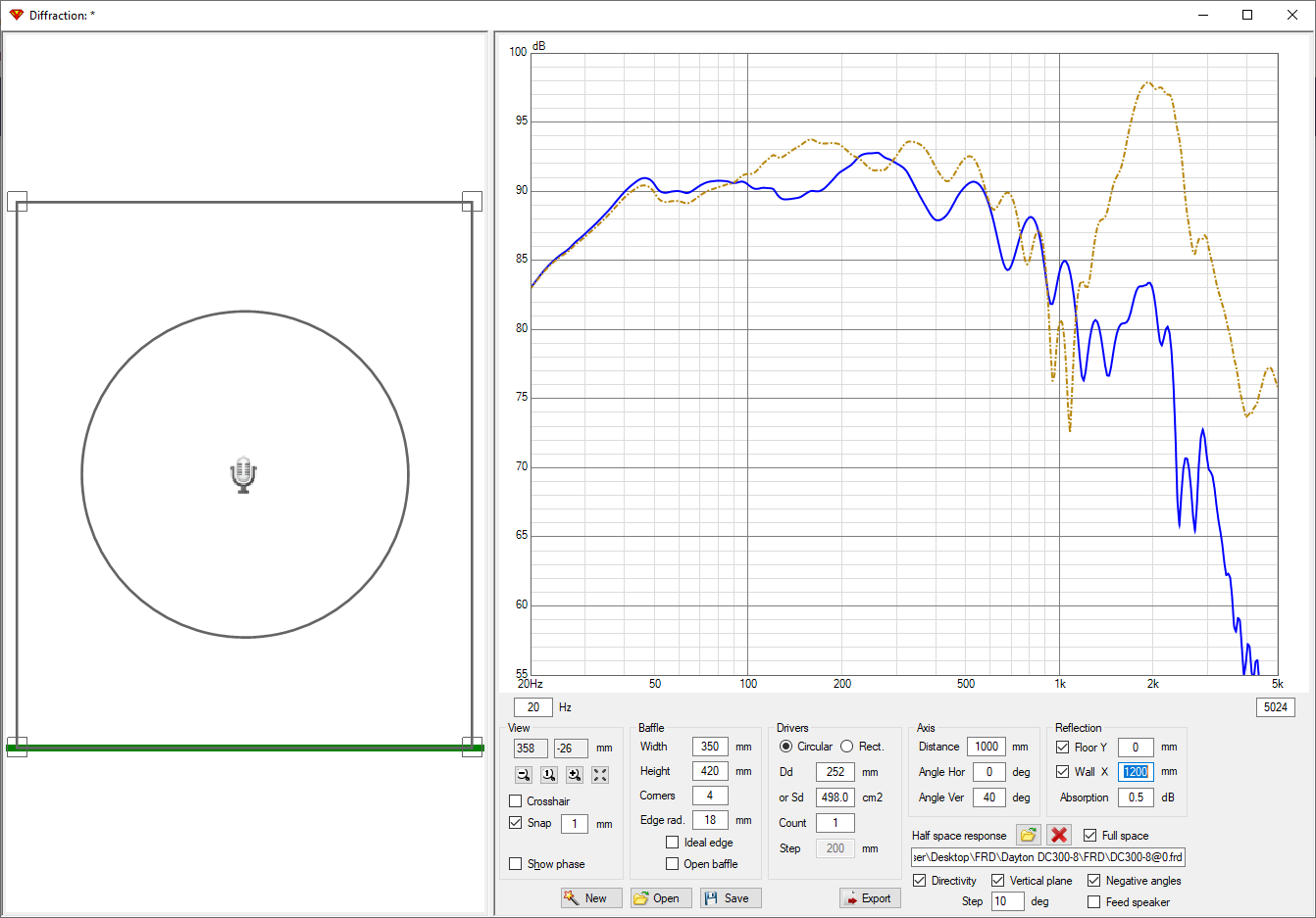

Adding a ground plane and a sidewall at 4 feet (1200mm)
reflection is rather evident.
(Orange) 0 degree ( Blue ) 40 degree.

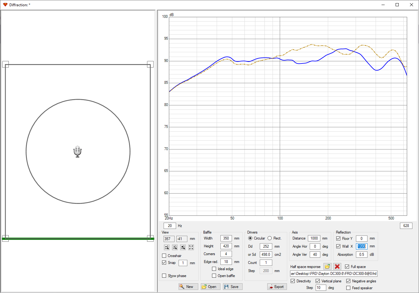

And showing dirt basic 12" speaker response full space ( DC300-8)
But if we look at the real world bandwidth below 300 Hz
The baffle step is flatter,
(Blue) 40 degree ( Orange Overlay) 0 degree
And you slightly gain back about 1 dB of losses to full space at the low end.
Crossover region around 250 / 300 Hz be flatter.
So pretty generic 45 degree tilt be more than fine.
