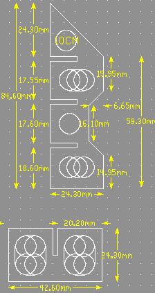

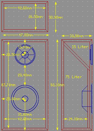

Hello
This is the plans for my future speakers.
The driver will be Manger MSW and Eton 11-581/50 HEX.
The crossover point will be around 150Hz using an Active crossover.
I will use 22mm Finnish plywood for the cabinets and the bracing.
Any comments are welcome.

Nice design. Seems like you´re going for a closed design for the bass right ? Tried a reflex myself but the result wasnt as good as i hoped it would be.
Manger + Vifa 8"
Also, active crossover is a excellent choise. Had a very complex filter for my speakers ( wich you can see in the pic above ). Even though it was optimized, it removed ( for lack of a better word ) some of the "life" the mangers do have.
Good luck =)
Regards // Mattias S

You might want to consider shifting the XO point to 315Hz. That gives you a few benefits:
(a) The MSW gets less of the power, leading to less distortion, and less compression. At the same time, it still carries the human voice.
(b) The phase response in the bass region will improve, provided the bass driver is chosen carefully. You will notice that the MSW has flat phase down to about 300Hz.
(c) The bandwidth of the MSW is slightly reduced, for less IMD.
(d) On a small baffle, the baffle step point is likely to be in the 300Hz region, so it might be simpler to adjust (by lowering the response of the MSW by 0-3dB, depending on listening position).
(e) Smaller capacitors in the crossover for the same resistor size, allowing you to either save money off the caps, or to use smaller resistors for lower noise.
I'm sure there are others I've missed, just as I'm sure someone will be kind enough to point out some drawbacks.

The acoustical crossover frequency of a usual Manger setup is around 150 Hz or slightly higher.
The first-order highpass is indeed placed at 300 Hz giving a 3rd order highpass, together with the MSW, that is 6dB down (approx) at the crossover frequency. The MSW has a rising response at it's lower end due to it's resonance (it's QTS is quite high). That's why the first-order HP is placed that high.
The 3rd order lowpass is chosen accordingly to achieve a flat response.
Angel wrote:
Have you actually done any measurements or listening tests to compare different crossover frequencies ?
While imagination tells me that you are basically right, you should also keep in mind that the MSW has an x-max of +- 3.5 mm and that it is almost a fullrange driver. The latter one being the main reason for using it (I have heard systems consisting of nothing more than an MSW, driven by a single-ended tube amp BTW).
If you relieve it from low-frequency content you increase woofer problems like IMD and resonances (specially with drivers using very stiff cone material) in exchange.

proposal
I would start with a Zerobox 109 kit as a basis for your own design. Chances that you will match or better the performance of the 109 with your first DIY attempt are pretty low. Besides that an existing and proven concept is always useful as a reference. From there I would first replace the passive crossover with an active one. Again start with the crossover parameters Manger proposes (1st order HP @350Hz, 3rd order LP @80Hz) and try to match or better the original result. Experiment with different capacitors (HP), different crossover points and different amplifiers to drive the MSW and the woofer. Keep the passive crossover to compare it with your active bi-amped version.
Once your familiar with the sound and have an idea what's good or bad I would start experimenting with different woofers and different concepts (sealed, reflex, dipole) while still using the original 109 cabinet (MSW only). After you have found an optimal driver and integration you will be ready for your own final cabinet design.
Looks like a long way (it is!) but you will have a working speaker at any time and the risk that your endavour will fail is much lower.
these parameters can only be used if its the passiv version, the impedance plays a role here - but not in an active solution.....
and when you are designing a new box, you are starting all over again - all parameters have changed.....so your stuck with the same problems once more.

tbla: I don't say that these are the only best parameters for any application but this is what Manger recommends for it's Zerobox designs and I was referring to the 109. Apart from that nothing prevents you from keeping the impedance correction part of the passive crossover. The 1st order HP filter is anyway for free and only a matter of the right value of the coupling cap between the preamp and the power amp driving the MSW.
My proposal was in the direction of "prototyping" based on something that already works pretty well. You are proposing the "big bang" approach that (in my opinion) only works if you are very experienced and all important parameters are known in advance. Your new baby will be more or less immune to serious modifications and if getting the desired final result is not only a question of fine tuning you will be in trouble. By looking at Calebay's (thread starter) plan and Charles' warning regarding designs with an "exhaust" you will get an idea what I mean.
Thats what i´m doing now. Going for a closed enclosure for the manger and trying different solutions for the bass. So far i´ve got a focal audiom woofer in a onkenenclosure and 4 peices of 12" peerless SLS drivers that would possibly fit nice in a H-baffle. At least i hope so but then they were cheap to buy.
