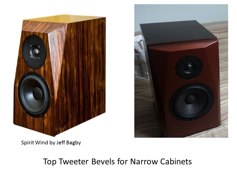

Top Tweeter Bevels for Narrow Cabinets
"Mandolin Cabinet material: Front Baffle is 1", the rest 3/4" MDF"
You will probably get the most crossover-accurate sound, plus good reduction of edge diffraction distortion by increasing the front baffle thickness to 1.5" - 2" and cutting an "Avalon Style" Truncated Pyramid to the top section around the tweeter. You will need to route out the THICK baffle behind the midbass to support easy air flow.
Good Example = Spirit Wind by Jeff Bagby

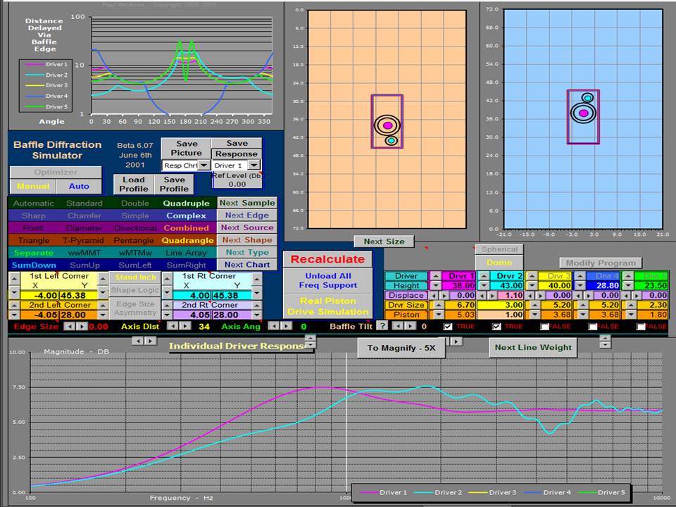

If you start moving drivers around on the baffle you'll cause issues with the crossover. They might be audible, they might not. Jeff Bagby wrote a baffle diffraction simulator the would help you model the effects of driver location and edge diffraction.

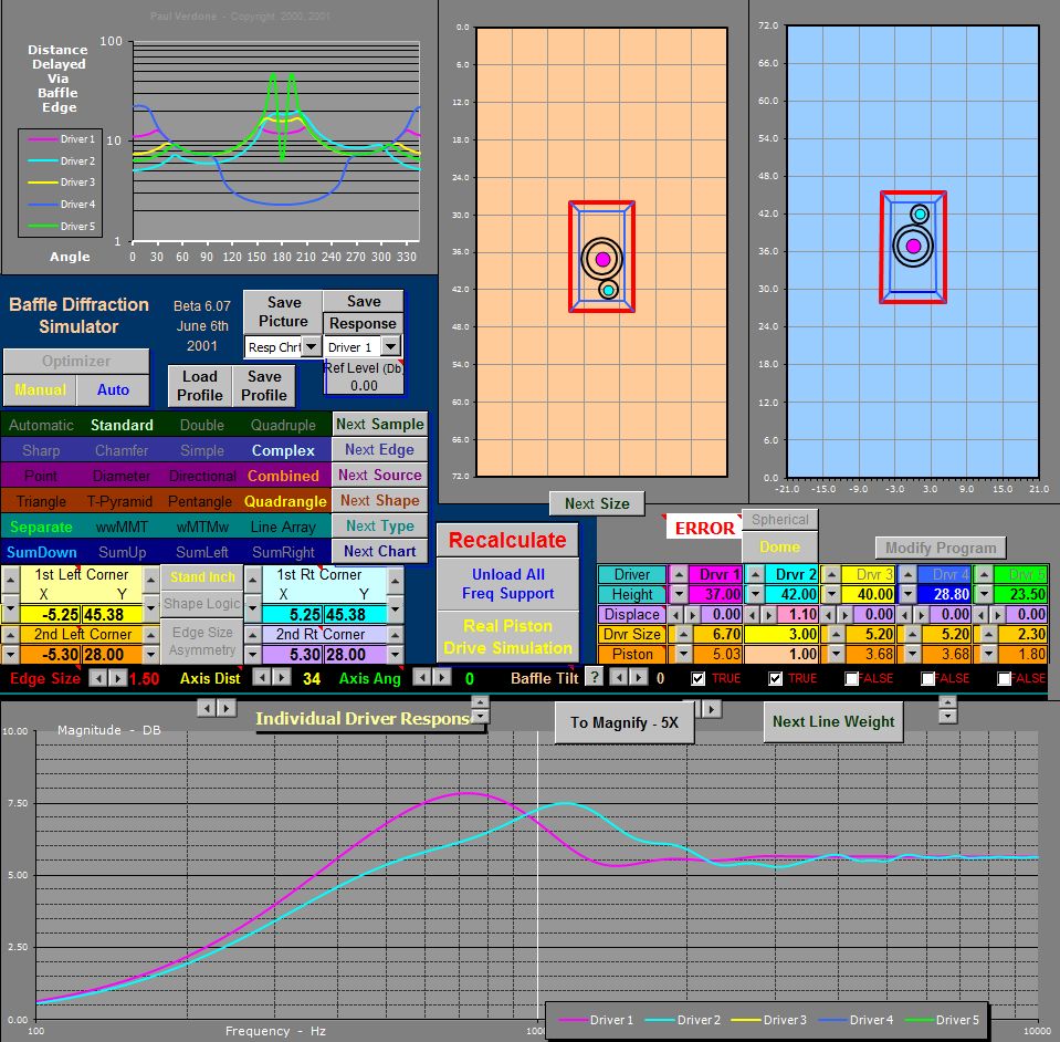

Attached. Simulations of small box with sharp edges vs. beveled edges illustrating edge diffraction distortion.
The measured in-room SPL will be smoother with the beveled baffle than with the original high-diffraction square edges. To cut the top downward bevel to mimic the Spirit Wind front baffle you will need to mount both the tweeter and midbass about 0.75" lower than the original baffle... a small change.
