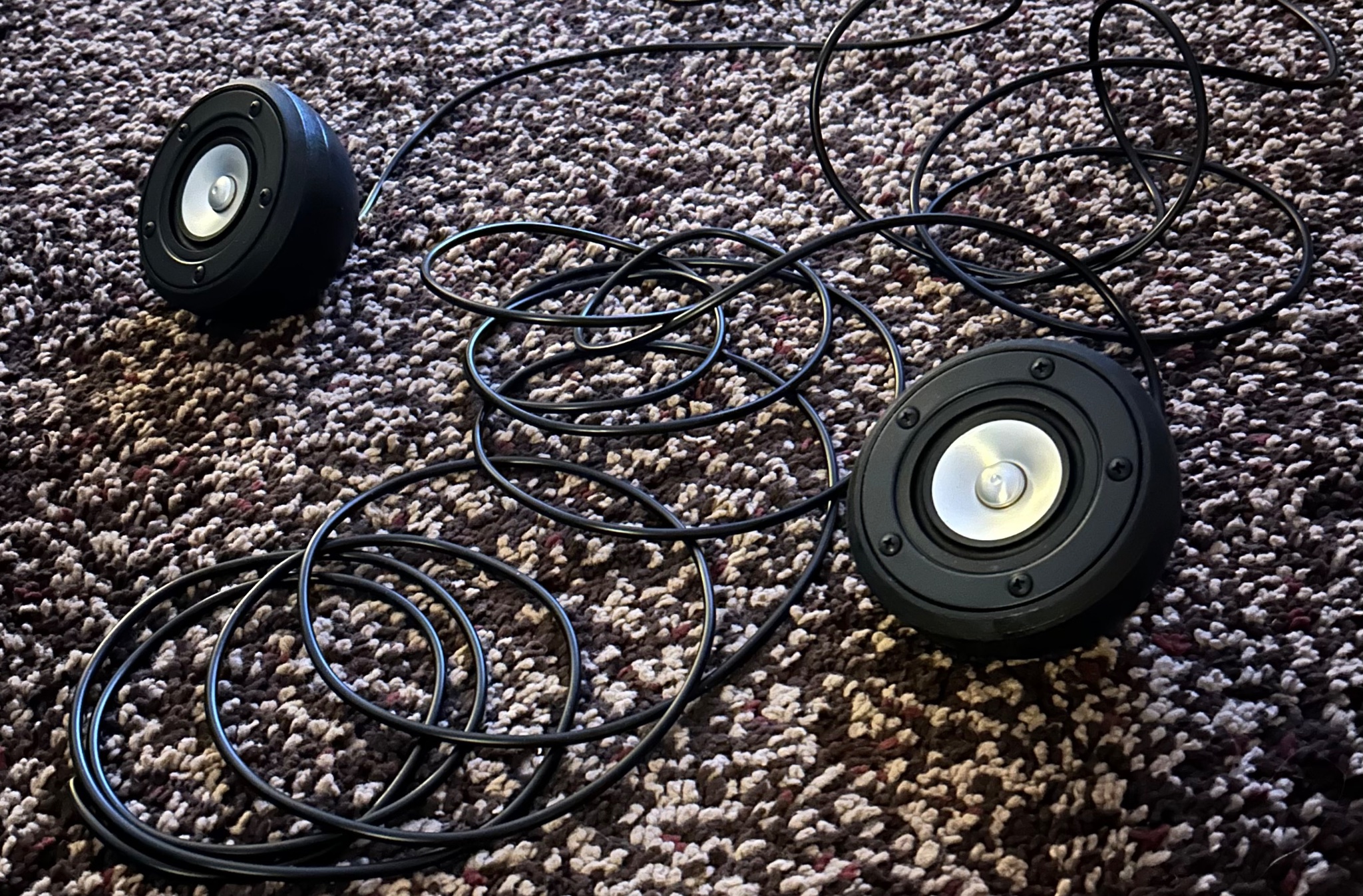

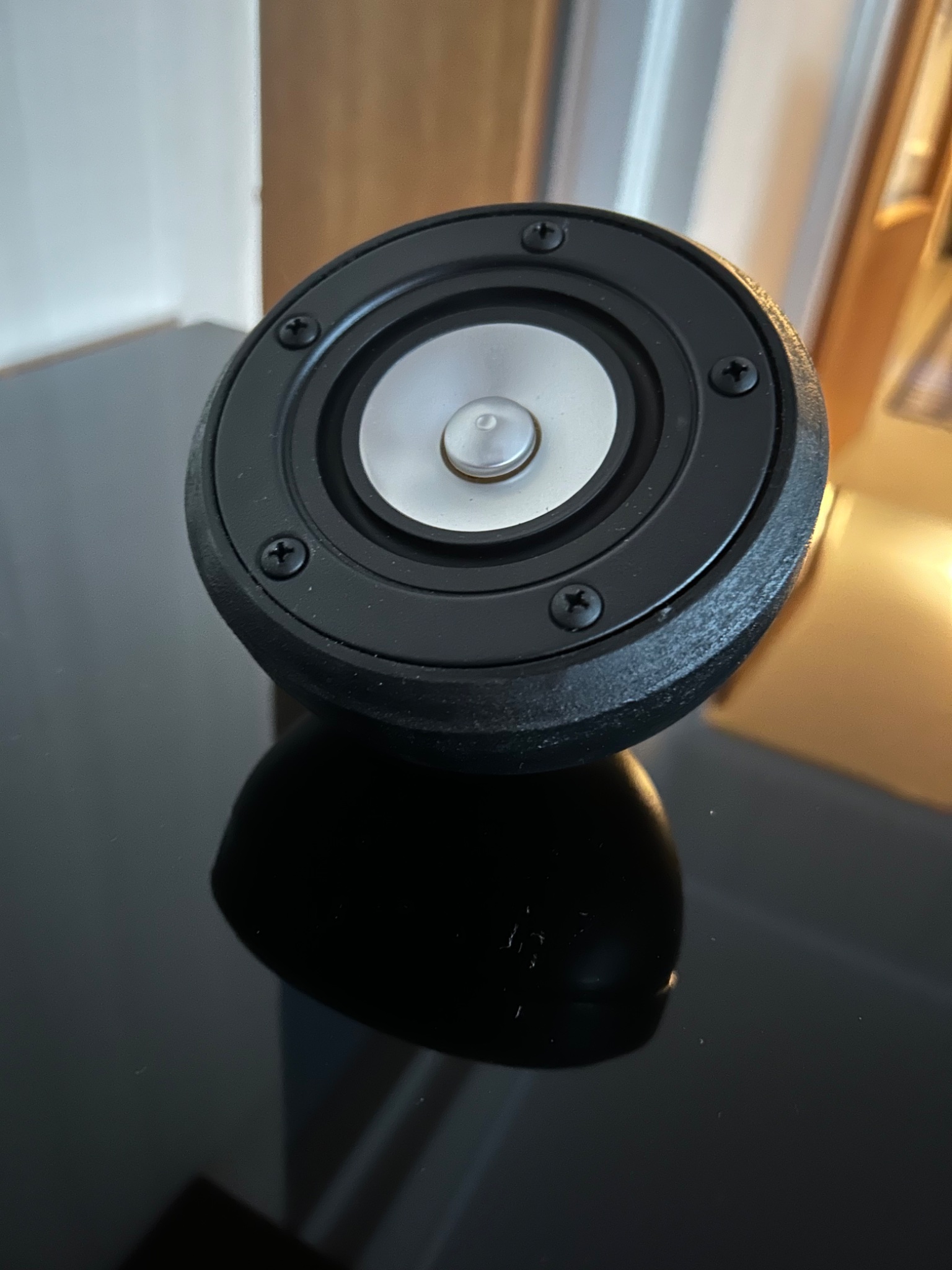

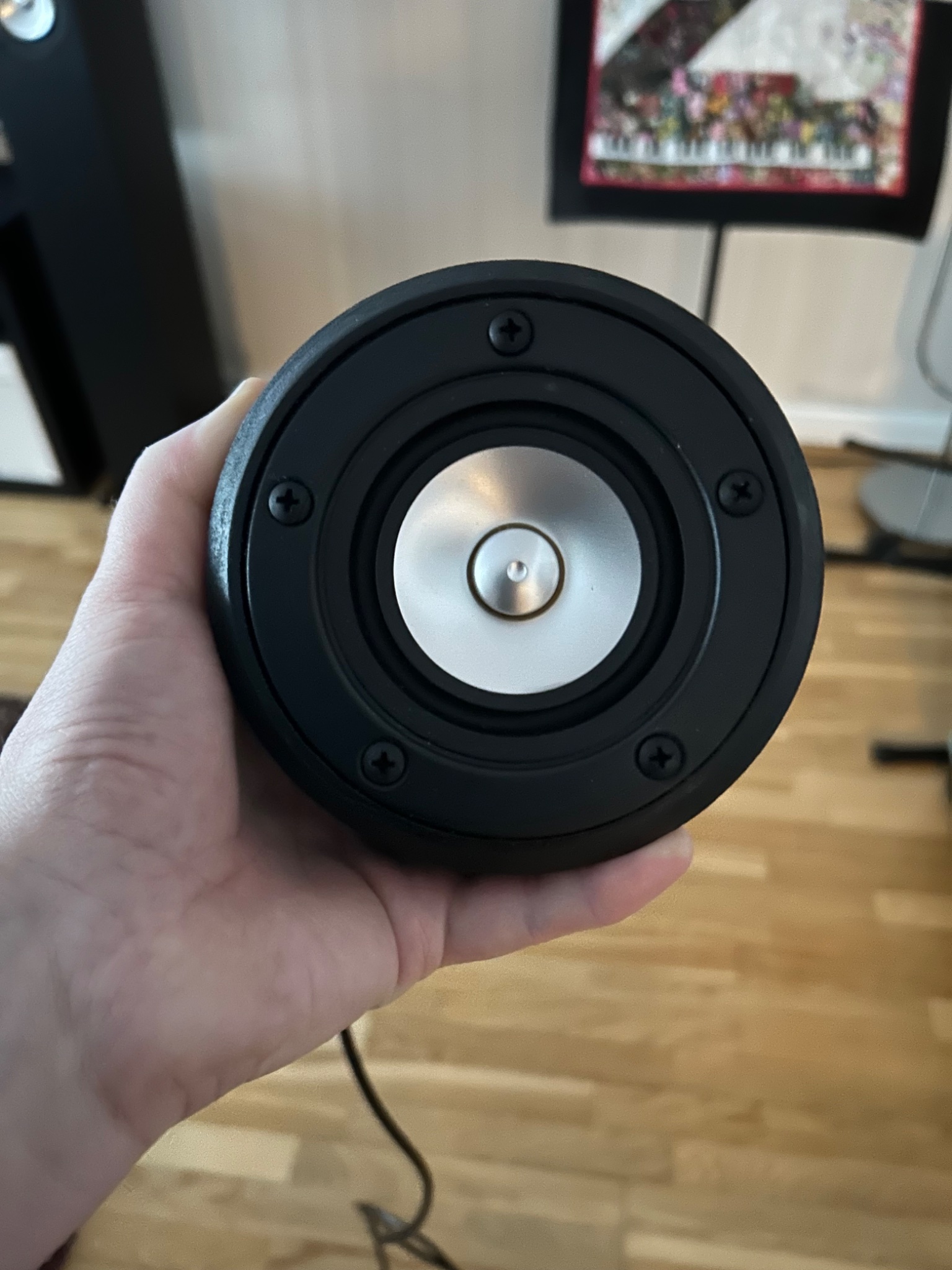

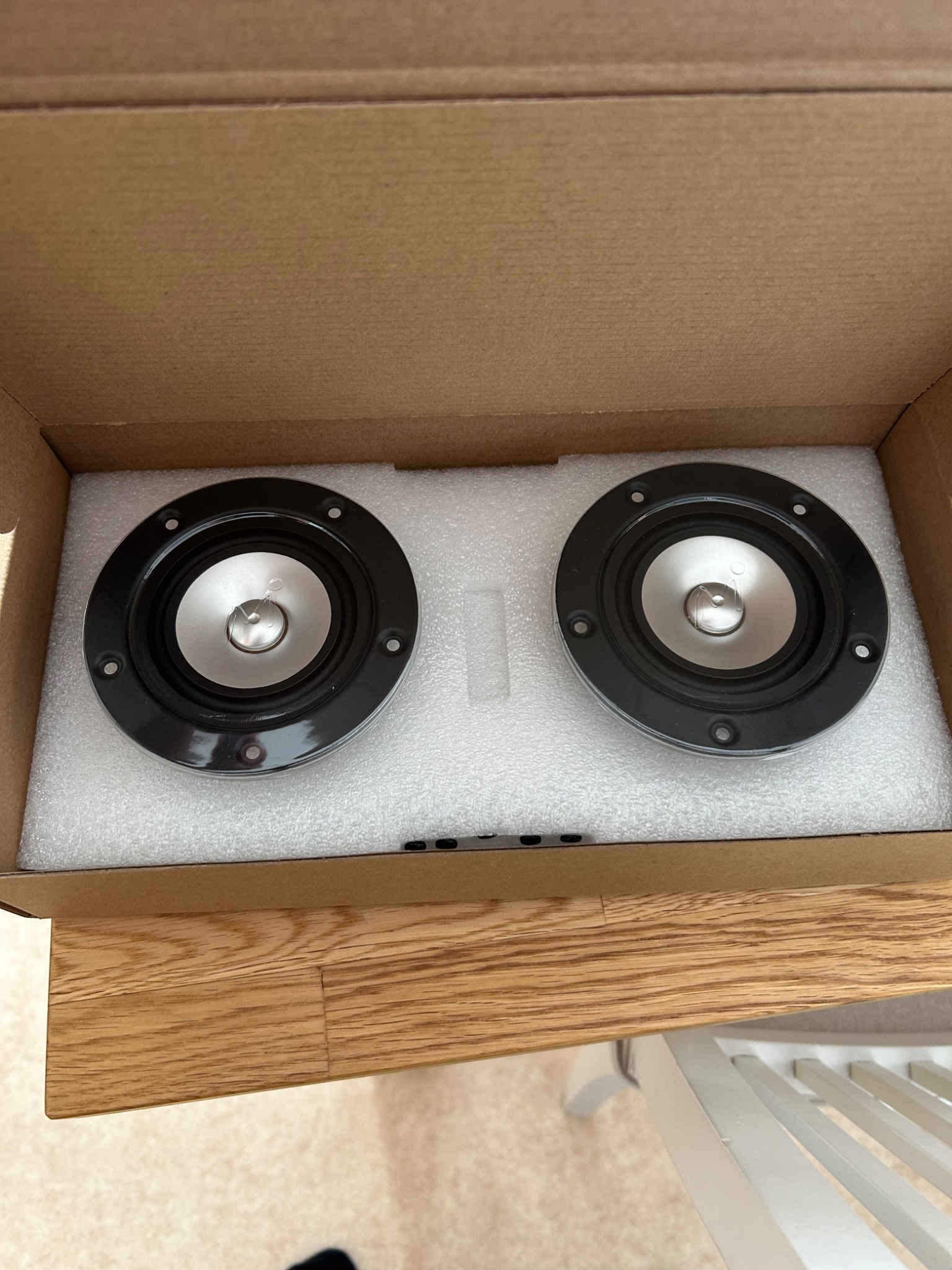

I have made two surround ”eggs” to complement my chn110 tower speakers , using the similar looking but much smaller chn50 driver in a small cabinet.

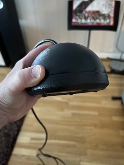

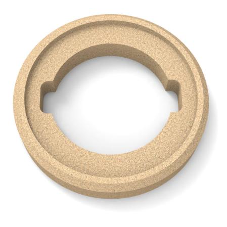

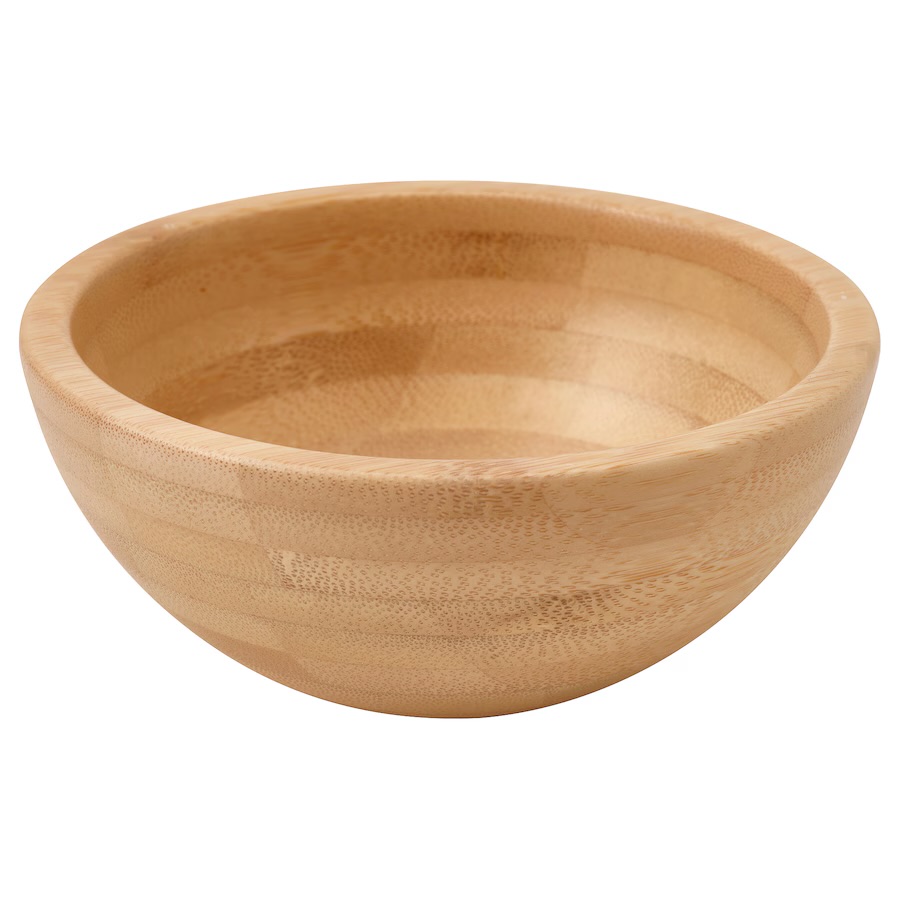

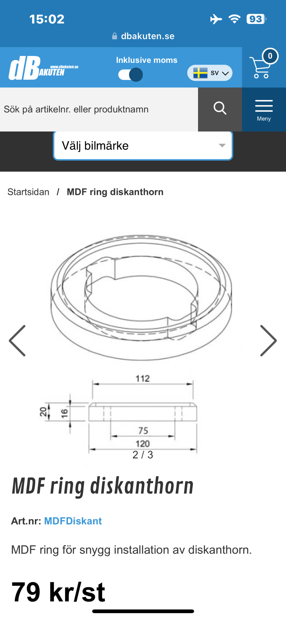

Two IKEA 12 cm wooden bowls and a 3 inch 22mm Mdf ring was glued and painted in black. I used a round black cable and making the drilled hole in the speakers very tight so they dont need any connectors. Inside there is sheeps wool and no crossover at all.
These speakers will be mounted on two speaker stands with a round base.

Very beautiful! Nice and solid bowls as well, good choice. How do they sound?

They sound very good for the purpose .
They are really small ( smaller than optimal ) so no bass below 100 Hz . One can use room correction in the Wiim pro to have it flat 100-20000 Hz .
