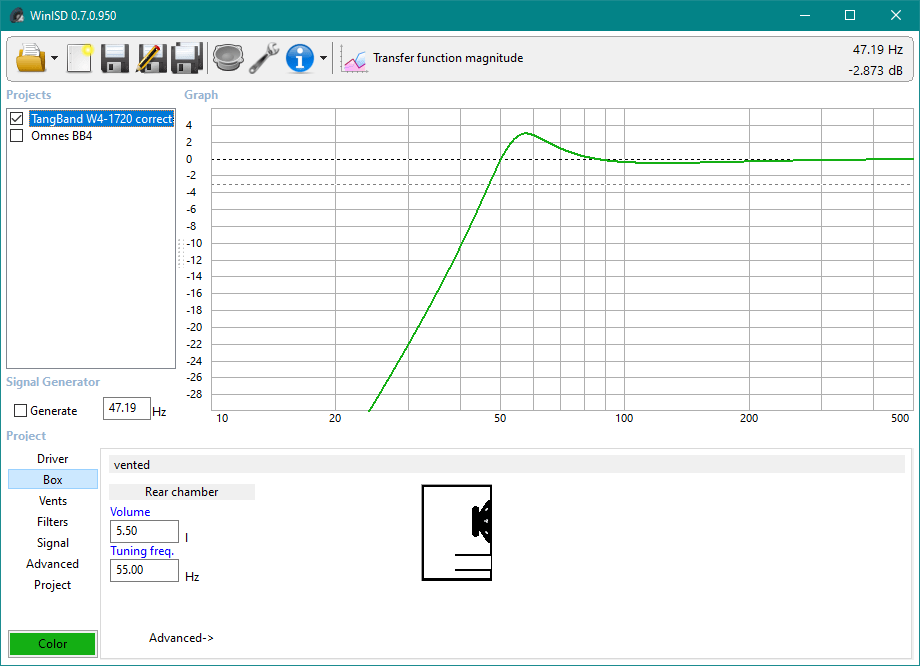

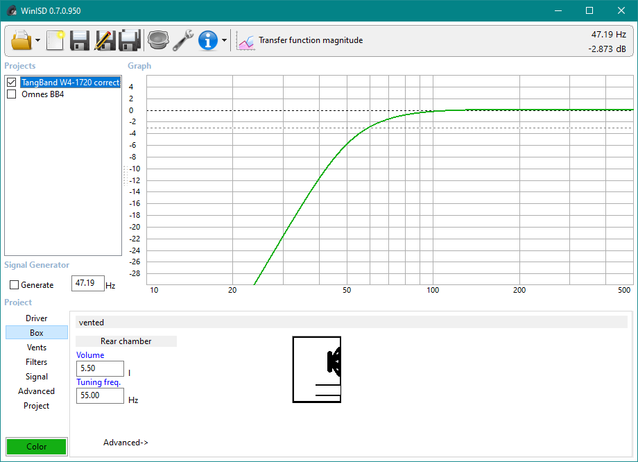

A 40ish F3 with a 4" woofer in cabinet that small? Impressive! Surely I can aim for a similar result, once I get a hang of this whole DIY thing? And so I decided to feed the T/SP, box and vent data into WINISD to verify that this could actually work. WINISD won't let me specify the port length but everything else, and in fact recommends an even longer port. This is how it looks:
That's nice and smooth graph for sure, but with a steep and early dropoff. Nowhere near 45 Hz at -3dB! The Speedster's crossover doesn't seem to play a role in that (or does it? I'm only just learning how crossovers work, with XSim and SPL trace and everything, so keep in mind that I am exactly as clueless as it seems). Anyway, I've looked for other explanations. Incorrect TSP (or units) were the prime suspects. But they are all in line with the specsheet.
Except... this posting on parts express' techtalk caught my attention:
Not that smooth anymore, but it looks more in line with that infamous F3. Air speed looks good... cone excursion not so much, but that also applies to the original VAS. Now, all this reeks of confirmation bias. A woofer so widely used and nobody except one dude noticed this? Don't think so. What am I missing?

(Alas, there is very little on that later.)The enclosure for the Speedster is 5.5 Liters. It has a 1.375" dia port that is 4.5" long (mounted directly behind the tweeter). This tunes the box to about 55 Hz. The -3 dB point of the W4-1720 in this size box is in the mid 40 Hz range, which is quite satisfying (more on that later).
Changed the VAS in WINISD, and sure enough:I measured 4 of these W4s about 5 yrs. ago. The T/S specs actually were quite close to factory, eXcept Vas - it was considerably smaller (less than half of TB's spec), so much so that even Paul's 5-6L Speedster box looked a tad large! ... Vas 0.07cf (some were closer to .08, but NONE close to TB's 0.2 !)

Vas can be hard to measure accurately, especially tiny drivers, and its spiders can take a long time to break in, so the pioneers determined that a closed box that raised Fs at least 1.56x would be most accurate, ergo with a raw driver its Fs needs to be pushed at least 1.56x lower, which can bottom out a small, low Fs driver, so 'caught between a rock and a hard place'.

The most thorough tests of the W4-1720 that I've seen were performed by John Krutke (Zaph) here: http://www.zaphaudio.com/smalltest/compare.html.

@ernperkins: Zaph measured Vas = 1.93l = 0.68cf! More evidence that the factory specs are off. Also, Fs seems much higher than specified (75 vs. 60Hz). Another possible explanation is, as suggested elsewhere, that TB altered the drivers at some point in the past. Depending on which is correct, the port length suggested by WINISD varies a lot. Will have to give it some thought and compare with other woofers.
