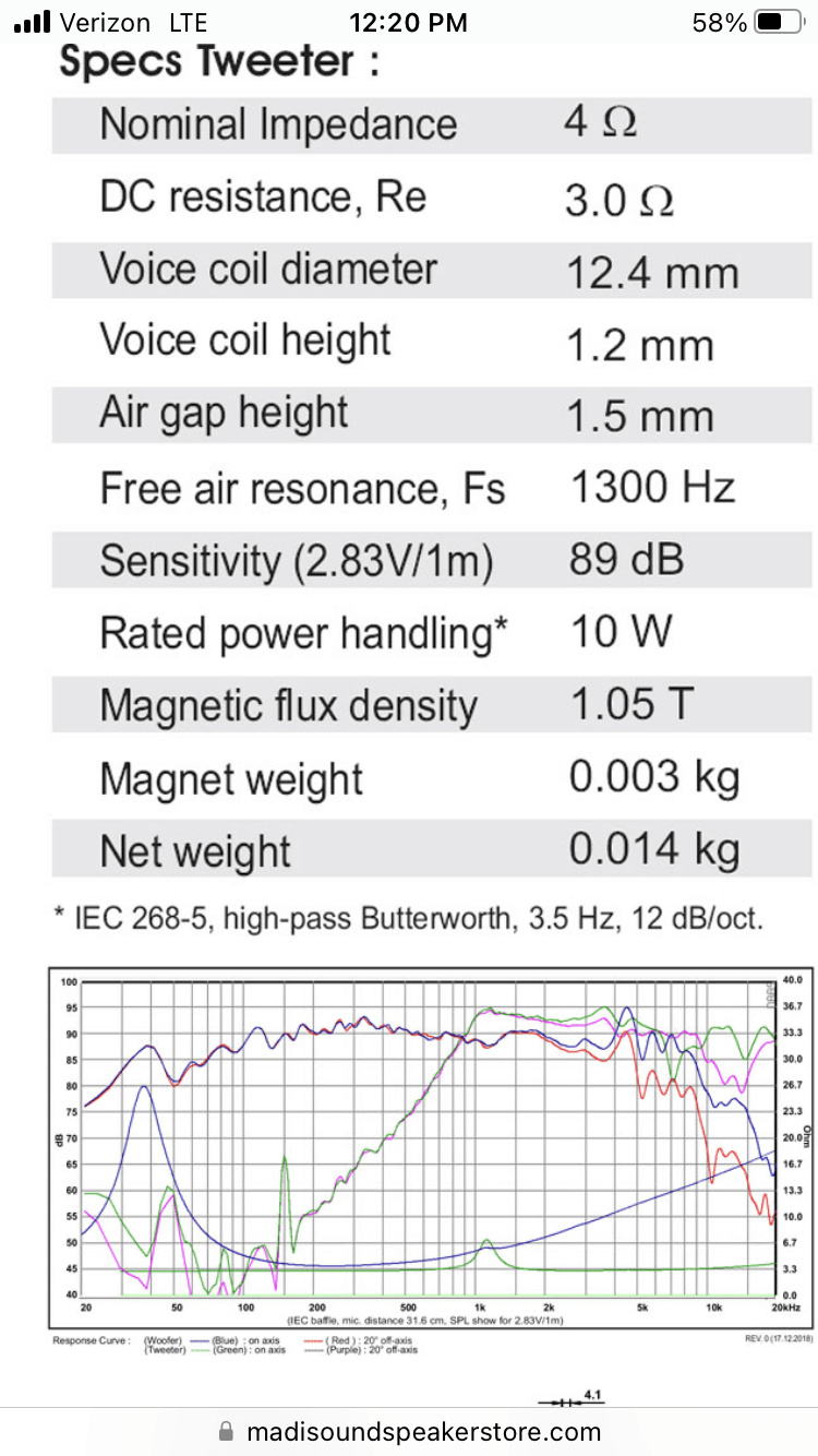

I’ve looked at many coaxial drivers thinking that the tweeter would be horn loaded by the cone but just about every response graph looks super ragged compared to the separate component drivers I usually would consider. I must be missing something here. For instance, I see tweeters having a recommended high pass of like 3.5khz in the middle of a 6” or 7” woofer. So the woofer looks to be breaking up in or around the filter as well as beaming. Some high end coaxials seem to be designed in this way, does it all come together in a well behaved power response that the raw graphs don’t demonstrate?

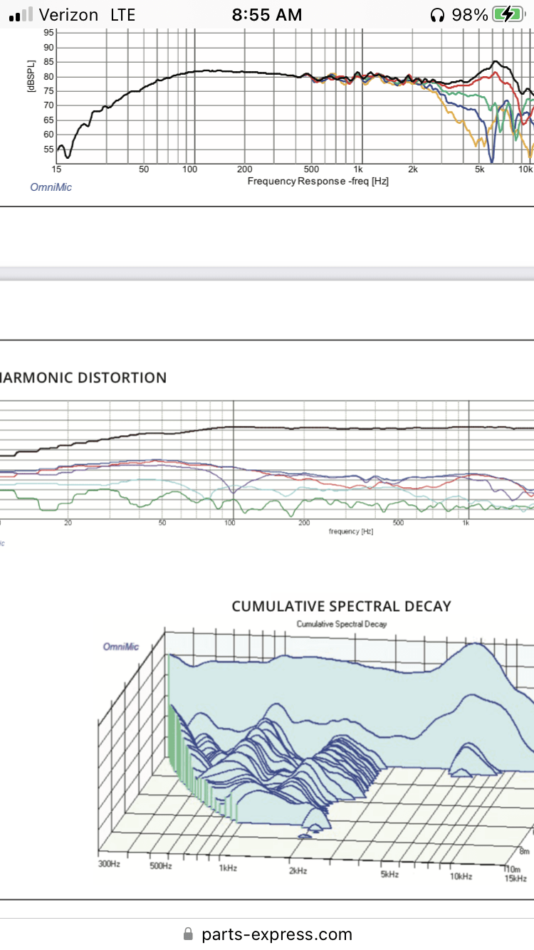

I’m not shopping in this range but it’s a good example that what I think I’m seeing is across the board in price with coincident style drivers.

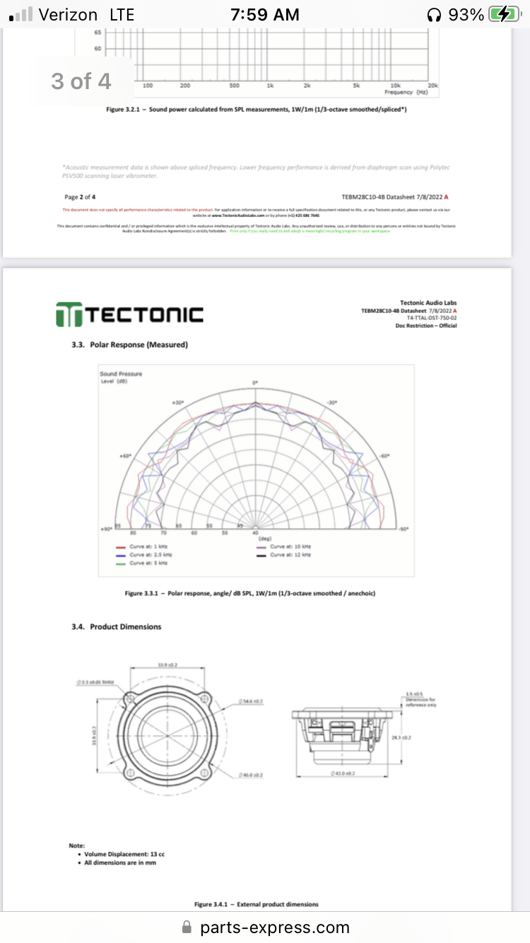

I also wonder how a small full range would work in this waveguide. Erin h measured the Tectonic bmr 2” with surprising results, this smaller version may perform well also.
The horn description states to high pass no lower than 1,000hz. Do we get destructive standing waves sub 1,000hz or does the horns effect become moot?
I’m a little weary about crossing in the meat and potatoes of the vocal range, especially not being an expert on the subject. If a horn just ceases to control directivity then it will be very tempting to try a small bmr in a waveguide. But then again I could choose a large format tweeter, cross around 2k and be fine. I realize that with a coherent crossover one can generally have said crossover nearly anywhere.

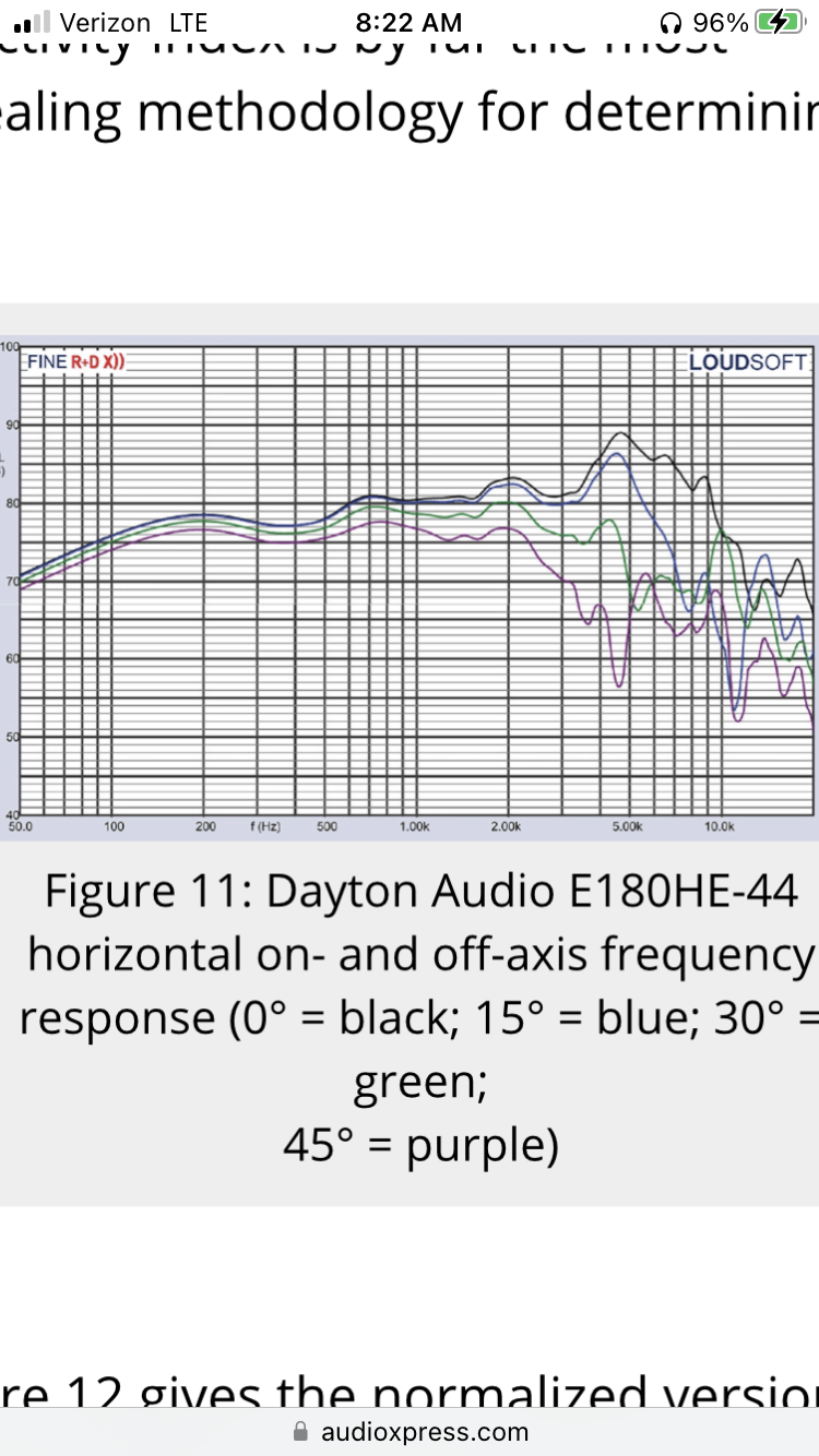

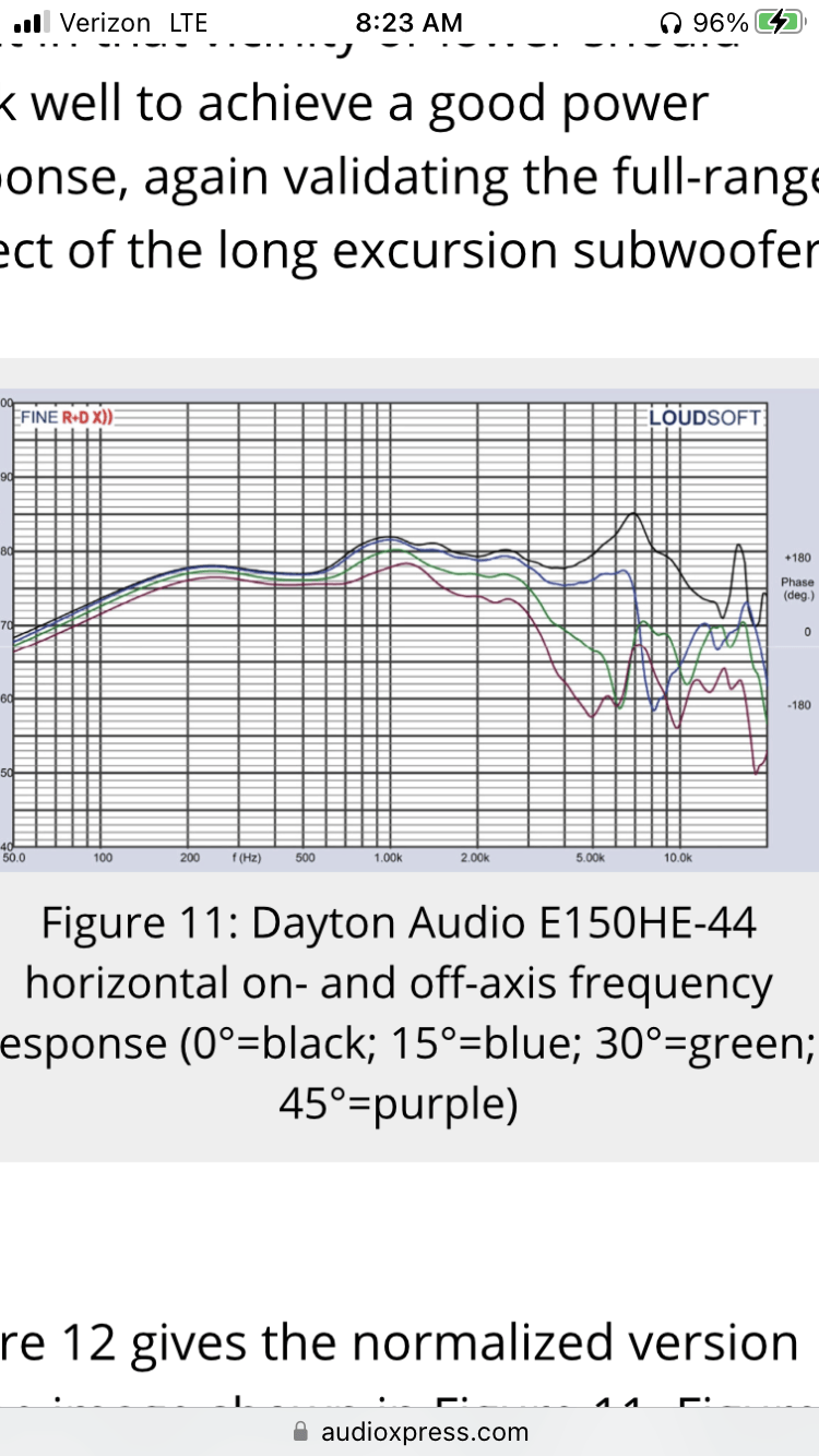

The Epique graphs above are from audio express, they’re the only ones I’ve found that show the actual dispersion in the lower frequencies. All of the other graphs seem to normalize the response below 1khz-2khz making drivers appear to have perfect 180* radiation up to around beaming. With what appears to be true dispersion data I feel more confident in trying to match a horn and woofer. For example, the Dayton graph shows a perfect 180* dispersion up to 2khz…

A lot of this is related to throat/cone discontinuities and woofer surround effects. There are multiple reflection points in the geometry that wouldn't be there in a normal horn or waveguide. This tends to look worse on graphs than it sounds. If you look at the KEF LS50, all the stuff that looks kind of strange compared to a normal woofer and tweeter is there to smooth geometry and improve the response flatness. Without a nearly flat surround and additional waveguide elements, it's hard to get the raw response flat in a coaxial. Though even in the ragged ones some do a better job of it than others.just about every response graph looks super ragged compared to the separate component drivers

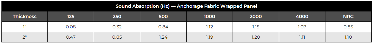

The absorber idea is interesting, but I'm thinking of it in a different way. To do much of anything in the bass, you have to have a ton of thickness, so that's not really relevant.
But even 1 inch of acoustic foam absorbs well from 500 Hz and up. If you extend the absorber out around your speakers, I think you could absorb a good amount of the first reflection energy. Kind of like a mini Live-End Dead-End setup.
