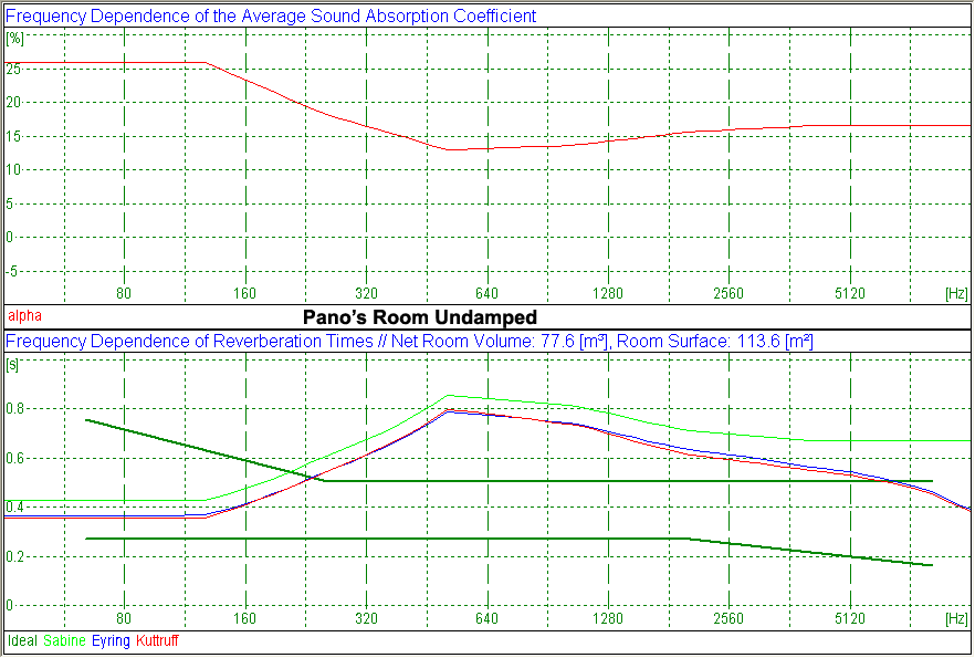

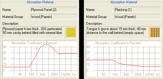

One of the reasons I ask is because I have the CARA room simulation software. And since I now know exactly the materials and dimensions of my new room, CARA is giving me an accurate model, or so it seems. Below is a graph of what how CARA sees my room acoustics. Very live thru the midrange and even the highs. That's what I hear in the room, the mids ring and the room seems live and bright. I need more mid/high absorption. So what to use?
Looking thru CARA's library of materials leads me to 20% perforated hardboard with mineral wool behind it. This seems to have just the right absorption for my needs. And is basically 1" center pegboard with 1/4" holes. Also seen is a tongue and groove board for comparison.
Has anyone used a pegboard over mineral wool or fiberglass panel like this? Placing a few of these around the room brings me down to almost ideal acoustics, as least as far as absorption, so I'd like to try.

Thanks Dave, cool idea. I had thought about going with shelves full of books behind the speakers. Similar idea. I used to have the whole left wall lined with shelves of random stuff which broke up the reflections very well. So your idea of a random diffuser wall is something I know works well. Just had not thought of hiding it behind a curtain.
As nac134 notes, the pegboard may not be too good for breaking up reflections. That's my worry. Maybe strips of wood over it to cause some disruption. I've seen a number of DIY acoustic panels around the web, but most are soft panels. That may be what I need to do. Kill some reflections and soak up reverb above 500Hz. I was intrigued by the pegboard/fiberglass panel as being absorptive right were I need it.

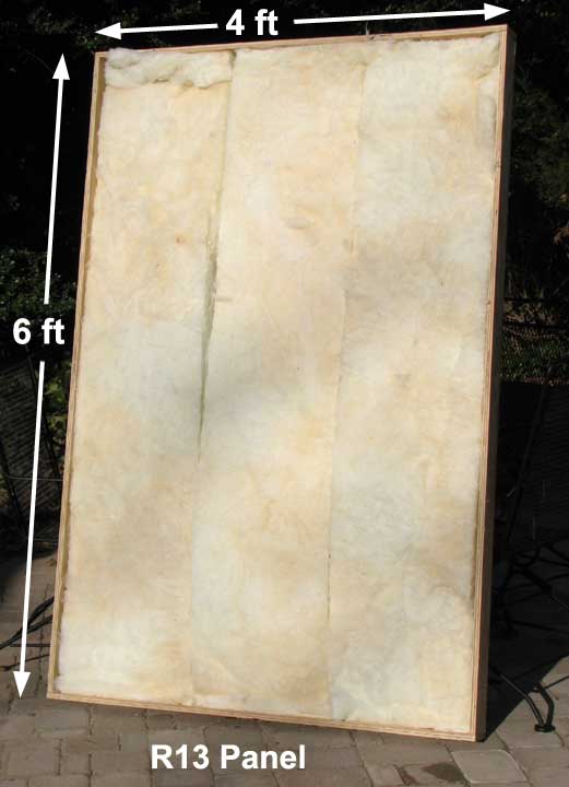

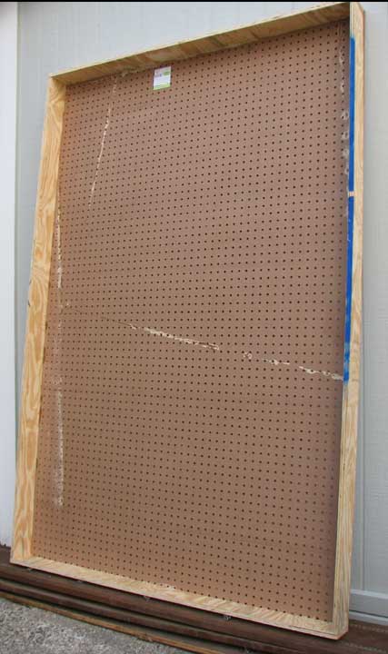

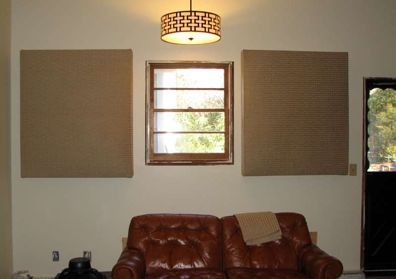

OK, I decided to build some of these things. 5 panels are now ready to be loaded with fiberglass and covered with cloth.
There are three 6x4' panels that are 4" deep for R13 insulation, and two that are 4x4' and 6" deep for R30 insulation. It's stuff I had left over from building the listening room.
They are basically just a shallow open face box with a pegboard back. I went to a large surplus fabric store and was overwhelmed with choices of cloth to cover these with. The plan was for good old burlap at $2-$3 a yard, but I found some nice upholstery fabric on sale for $7 a yard. Nice looking, thick, strong. Would normally sell for about $20 a yard or more. I'm hoping that it damps well, like heavy curtains.
Funny thing is, just getting the panels built and stacked in the room is already an acoustic improvement. No fiberglass yet, so it promises to work well.
I plan to mount them soft side out. But can always flip them for pegboard out if that sounds better.
There is pegboard left over so I may build a few more small panels for the ceiling or something. Also bought thin ply to build a diffuser behind the speakers.

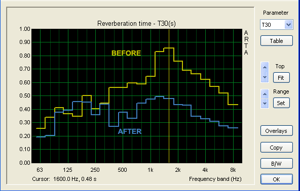

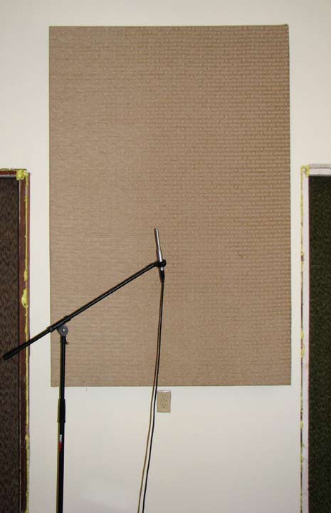

The panels work very well indeed. Below is a graph of the room T30 reverberation before and after the panels. Mic in exactly the same spot. Both speakers playing.
As you can see, the hot frequencies have their reverb time cut almost in half and the curve is much flatter. That's what the CARA software predicts. However CARA predicted the peak about 1 octave low.
This is a huge improvement. The sound is much cleaner and smoother now. The "Ping!" is gone. I will post photos of the panels and their construction tomorrow.
Some photos of the insides of the panels.
Rather crude, but is now covered by cloth.
The back is pegboard, the sides are 1/2" plywood. The insides are filled with normal household fiberglass insulation. All held together with brads (air gun) and glue. The fiberglass is held in place with a coat of glue on the pegboard. That should keep it from sagging. So far, so good.

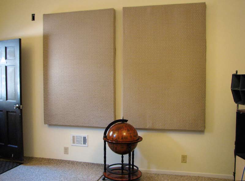

I'll take some photos of them on the wall today.
Do you have a worry about breathing micro bits of fiber, since the cloth covering has to be porous?
What's the space between pegboard and wall?

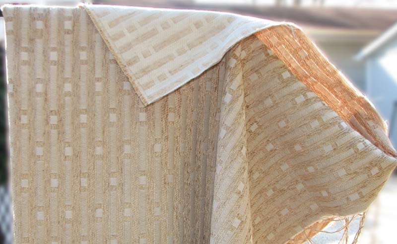

Maybe. But I used a thick upholstery fabric which does not seem to let any fibers thru. (photos coming). The thicker fabric seems to be no impediment to the mids and lows, and may absorb a lot of highs before they ever get to the fiberglass. Originally I wanted to used the Bonded Logic "Ultra Touch" cotton insulation, but could not get it locally. If you can find it, I recommend it. Some of the projects online use a layer of poly batting over the fiberglass. That should also help.
Good question!What's the space between pegboard and wall?
At the moment, basically nil. So I doubt the holes in the pegboard are having any effect. I do plan to try some spacers behind the panels to see if it makes any difference.
My magic 8-ball says it will. Try a few inches from the wall.

Here are the panels in action.
As you can see, the room is still pretty bare and needs finishing, but it sounds good. The panels look a little better than in my photos, but they are certainly not a slick, factory made item. And they are heavy! The tall ones weigh in at almost 40 pounds (18Kg).
Also pictured is the cloth used to cover them.
One mistake I made was to build the 6x4 panels too wide. Could not wrap the fabric around the back on both sides. Remember that!
I'd be curious to see you try spinning them around and measuring to see if it is closer to the CARA predictions. I always thought pegboard was used in the front to minimize HF absorption. Distance from the wall should affect LF substantially.
A good idea Ron, and the original plan. Turn them one way or the other depending on acoustic need. Didn't work out that way, tho. The are so big and clumsy that once on the wall, I'm leaving them!
However, I may been lucky. They seem to do exactly what I need. CARA was wrong about the peak reverberation frequency, but it was very close on the before and after T30 times.
