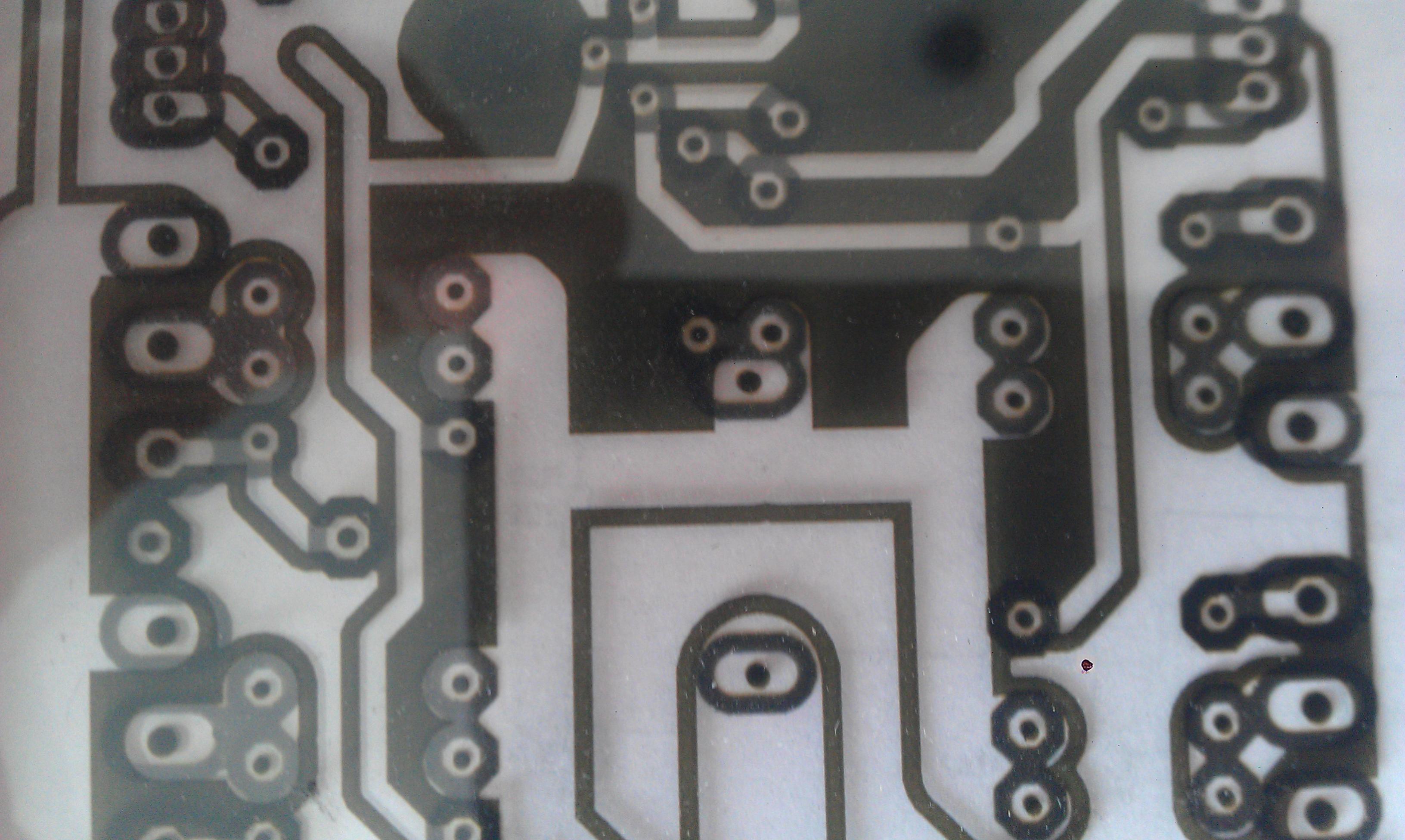

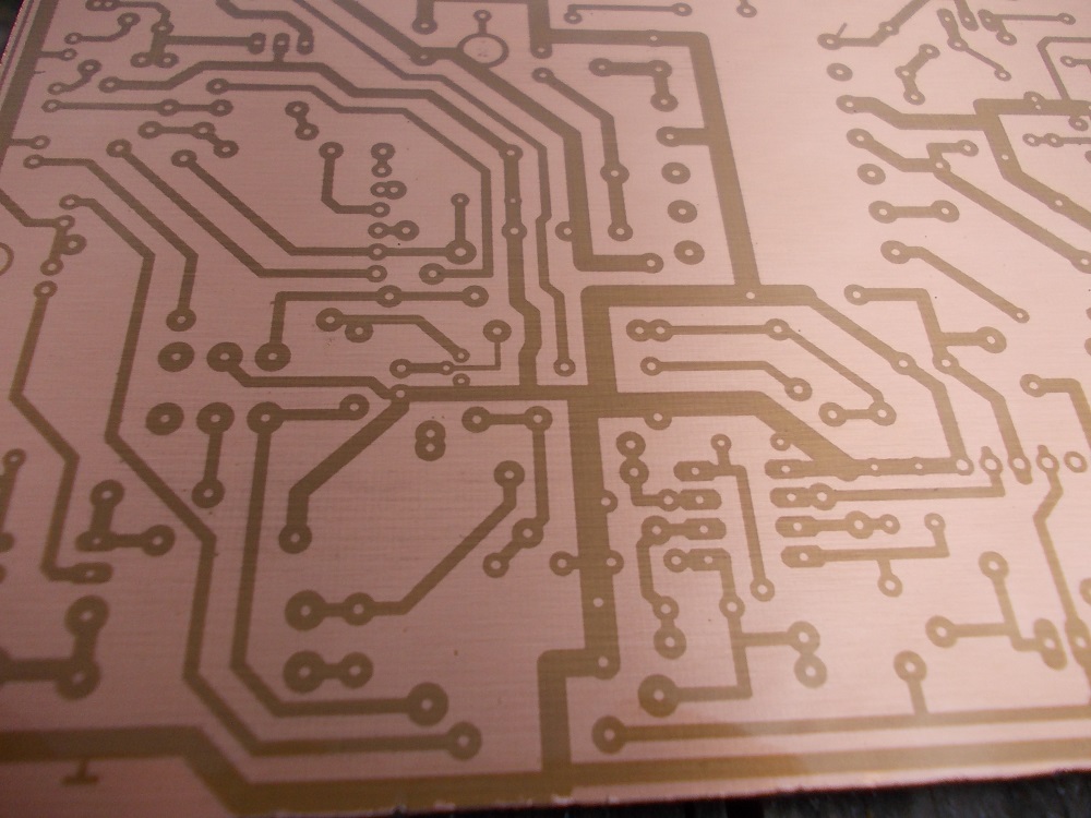

I have done a pcb with a inktjet printer, when you do print color grayscale and not use the black cardtridge, (on special folie from ebay in my case) do make good prints even when it is not complete dark, the yellow do block the uv making nice outcomes.
I have do with this pcb extreme test, I did lighting it for over 10 minutes, let it 15 minutes in solution give this, very nice, this means the grayscale do block uv light very well even if it seems not dark, it does, over lighting did not ruin it.
photo is made with mobile phone so it is not complete sharp, but it is as sharp as a inkjet can. even when print only yellow it works I think, this I go try soon.

Have you tried using black ink and inkjet transparancy? And this greyscale method is better?
Yes I have, with black if shines through (particles) with gray not because yellow do block UV, I want to try yellow alone to see if that holds.
As you see I did light pcb very long and still it did came out well, I have heard from someone that yellow is the way to go, I did now use three colors to make gray. You need dye ink, not pigment.
see picture, not so sharp because of mobile phone.

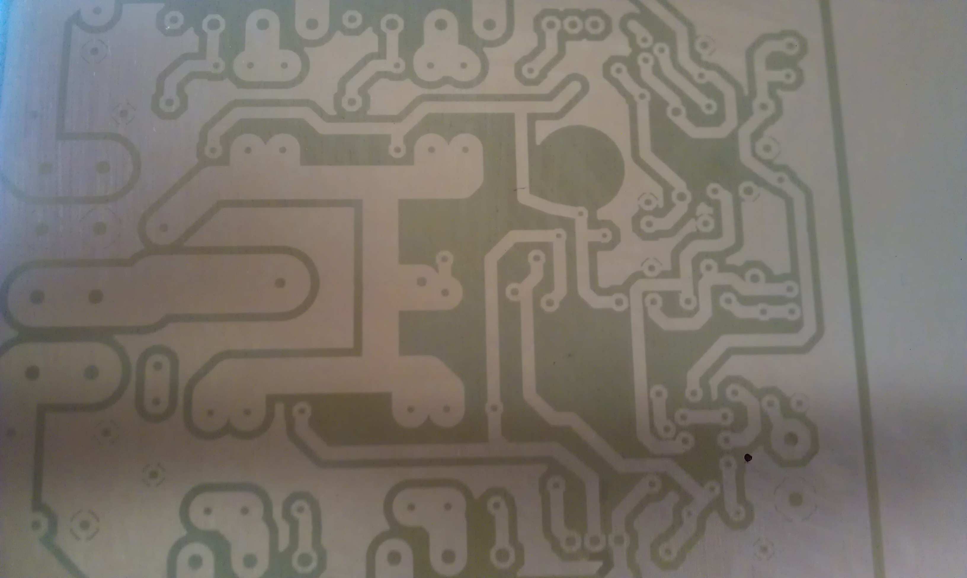

I have done a new one with inkjet using only color cartridges in gray scale settings photo and using glossy photo paper, however my epson dx8400 refuses transparancies so I need to trick the printer by gleu a transparanty on paper.
it do wel as I see, I did light the pcb with UV for 10 minutes, this is very long without damages.

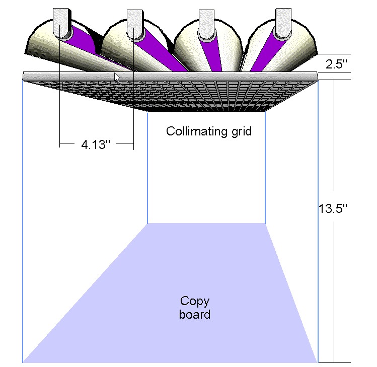

I did have a issue with the negative resist, it go of difficult after exposure, in my case 2 minutes, I think the lamp is to close, I have used a normal tube exposurebox with 5 uv tubes in it who are quite close to the artwork, so it possible do go a little under the traces and make trouble.
I have order 200 uv leds and go make a box special for these negative resists.
because of it do not develop completely etching go wrong .

The inkjet plots night black, no light do pass, i have tryed with a 1000 watt lamp it do shine very very little through. Because of small lines it has to be furhter away from the lamp who is a normal light tubes for normal pcb exposure.

I, too, had troubles with a simple light box as a source. Collimation is a big deal. I modified my light box by adding an "egg crate" style lighting grid between the tubes and the artwork to collimate the light. See the THINK & TINKER website for the how to .....
Home Built UV Exposure Head
Worked very nicely, solving my problems.

I have look at it and saw that the lamps are 13,5 inches above workpeace, my problem is the box is just 5 cm above workpiece and so I can not use collimation grid the right way?.
Special for negative resist it is needed distance is min 5 inch above workpiece, or film.

Cut the grid so that it is rotated about 45 degrees. Then you can simply set the grid on top of the tubes, Works nicely. I cut the grid with my table saw ... wear a face guard as plastic chips will fly!
Quote from THINK AND TINKER:
"Rotating the grid so that the rows of cells form an angle of 30° to 45° with the tube axes will eliminate Moiré fringes altogether and allow to collimating grid and copy board to be positioned wherever is most convenient. However, trying to cut the fragile grid material on an angle will significantly increase the difficulty of fabrication."
