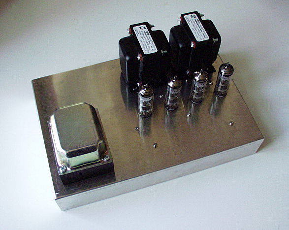

I say go for this kit. TPower1
Find it here: Dantimax (elektronik) - Tube_pre-_-_poweramps
The company is in Denmark and the price is right!
