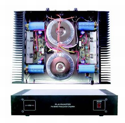

Hello,
I just finished 2 500W in 4 ohms amps. I measured at 8 ohms but I forget exactly what the output was.... I think around 266WRMS. Since my rail voltage is lower than the design called for, I only get 408WRMS into 4 ohms. It was from an August, Sept. and Oct. 1997 issues of Silicon Chip Magazine. Dick Smith Electronics doesn't carry the kit any more. I ordered the boards from RCS Radio. They are in Chester Hill NSW Austraila. (+61 2) 9738 0330 I suppose that's the phone number. RCS Radio is on the internet. Bob Barnes is the fellow to talk to. I bought 2 boards and shipping to USA for $50.00 US. Not bad at all.... I think that comes out to be $35 Aus. dollars. Look him up! The boards are fine quality. You will need to get a copy of the article though. There is no silkscreen on the boards. I took a fine, permanant marker and did my own silkscreen and made it very easy on myself. The amps are very quiet and no hiss or hum. I love it!!! I will be writing about them some more when I get my pictures developed. I have started a couple threads on them under "500W amp" look em up man!

Hey,
Since I bought the boards, the only wiring I did was for the power supply parts. Other than that, just stuff the boards with parts. It would take a lot of time if I had to hardwire all the parts on proto board.😉 If you do decide to do it, there are many smart people here that will help!

That skinney boy..... What a smart-***..... 😉 Building 1.21 jigg-a-watt amps is serious business... LOL ROF Yeah skinney boy, try building a real mans amp for a change!!!!! just kidding.......
RCSRADIO@cia.com.au Mr. Bob Barnes The board number is SC01208971 500Watt Amplifier. Bob's a pretty cool and interesting dude. Tell him "The Okie from Muskogee" sent you. He'll get a kick out of that....... 🙂
I'll post pictures when I get them scanned in. I just got them developed today.........
Chris
Chris

called them.. but how much do i have to do?
hey,
It sounds pretty good, he said I could probably get transformers than a bit less than previously thought 🙂
I was wondering how much the voltage recommended to be put into it is (after transformers), so I could know just how juicy transformers I need....
I was also wondering how many other things need fixing, patching up or adopting to suit my needs. I would be running probably two of this amp (i know, gonna cost me) one per channel. I actually don't need it to be this powerful, so I could consider running at a maximum of 300-400 watts RMS if it would help from the transformer front. He did kind of scare me by saying something about treating it good, well of course, but how would this differ from any other amp?
I was also wondering if there was an alternative built more for my needs, that is to say 350, 400 watts rms x 2? Ah, this is probably pretty good. I dont know honestly, but if I can make this work for a decent price I will, to save complications of looking around more for another alternative.
