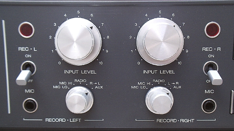

For the toggle switches I made 'fakes' by filing & machining down two glued-together strips of acrylic, cut from an old cracked turntable cover; I needed double thickness, so two strips. Then I drilled & painted these metallic silver. A short section of 2mm welding rod connects these new fake dollies to the original switch toggle mechanism, into the centre of which I drilled a 2mm hole.

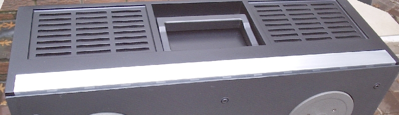

The burned cabinet top I 'hid' by carving out a rectangular recess, using a chisel & craft knife. Into this recess I slotted a section of aluminium extrusion from the hardware store. It matches the pinch roller cover flap perfectly.
I removed all the Nextel with methylated spirits, and re-sprayed it in Satin Black aerosol paint (2 x $5 cans).
Various scrapes and scratches on the amplifier face and reel taples I touched up with Humbrol model paint & a tiny brush.
It looks pretty now!
