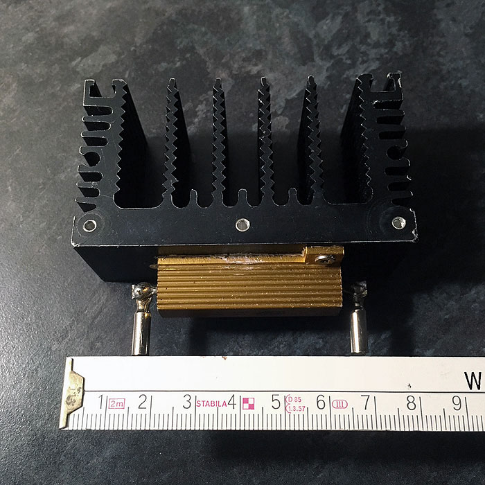

I completely agree with the above- but do note, a 100W resistor will require a decent heatsink to dissipate its rated power. 400W of test load requires reliable cooling if you are going to approach its full capacity.
You can cheat a bit on that point though... attached below is a photo of the one I use most often - this is an Arcol 4.7ohm/50W resistor, attached to a small heatsink from a small amplifier - a destroyed creek 4040. In free air, it is just about enough for the rated dissipation, but adequate for the uses I have, most of the time.
When I need more than that - I just immerse the heatsink fins-down in a small bowl of water, and used like that - I've had no issues dissipating 150W for extended periods of time!

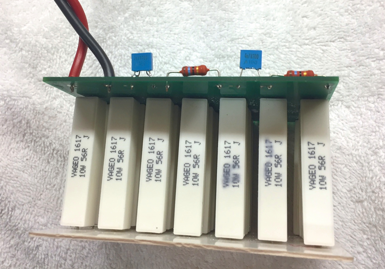

I used twenty eight resistors, each one 56R and 10W. Cheap, wirewound, cement encased, resistors. (14 in parallel) series (14 in parallel)
Then I connected a frequency compensator in parallel with the 8R0 resistor, to cancel out the inductance of all those wirewound resistors.

This needs a 'like'. Very economic, and efficient, solution.

For my own pictured earlier -its a non-inductive wound part about 50mm long, it might contribute up to 1uH with leads attached* -and at that level, I really don't care for the things it is used for.
* 1 m of wire in free space is about 1uH, ballpark; say 50cm/18" of wire (x2 - there and back.). That figure drops by a factor of 10 or more once you are using a closely-bound pair, like speaker wire, or a twisted-pair of cables as I'd usually use. It is the loop area the circuit describes as a 'round trip' that dominates - above and beyond, what each load resistor contributes.
