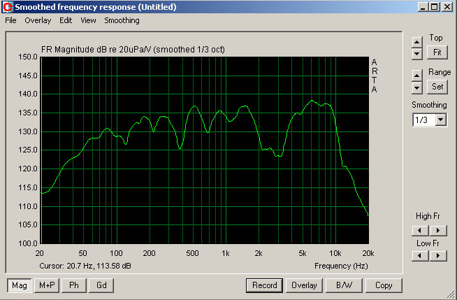

This is the on axis response of the first shape used on my Wharfedales, using a rat shack SPL meter. ie 0db at 10 K, -18 dB at 20K
