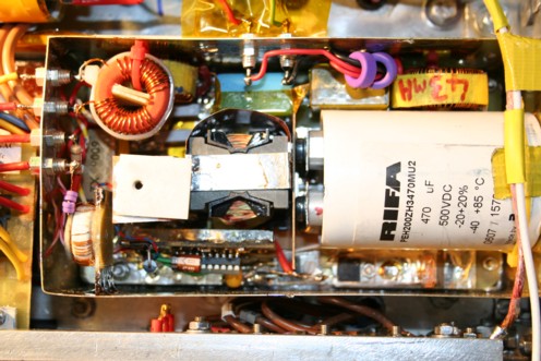

Makes one wonder if a SMPS delivering B+ regulated might become welcome in the valve amp world?
Ay, this is my philosophy. Switch mode doesn't come without a brain storming tag plus EMC. The performance is excellent but to keep the whole darned thing to size in a chassis is the main challenge. The best tackle is to use SMD to reduce space but I don't like working submin with strong glasses.
