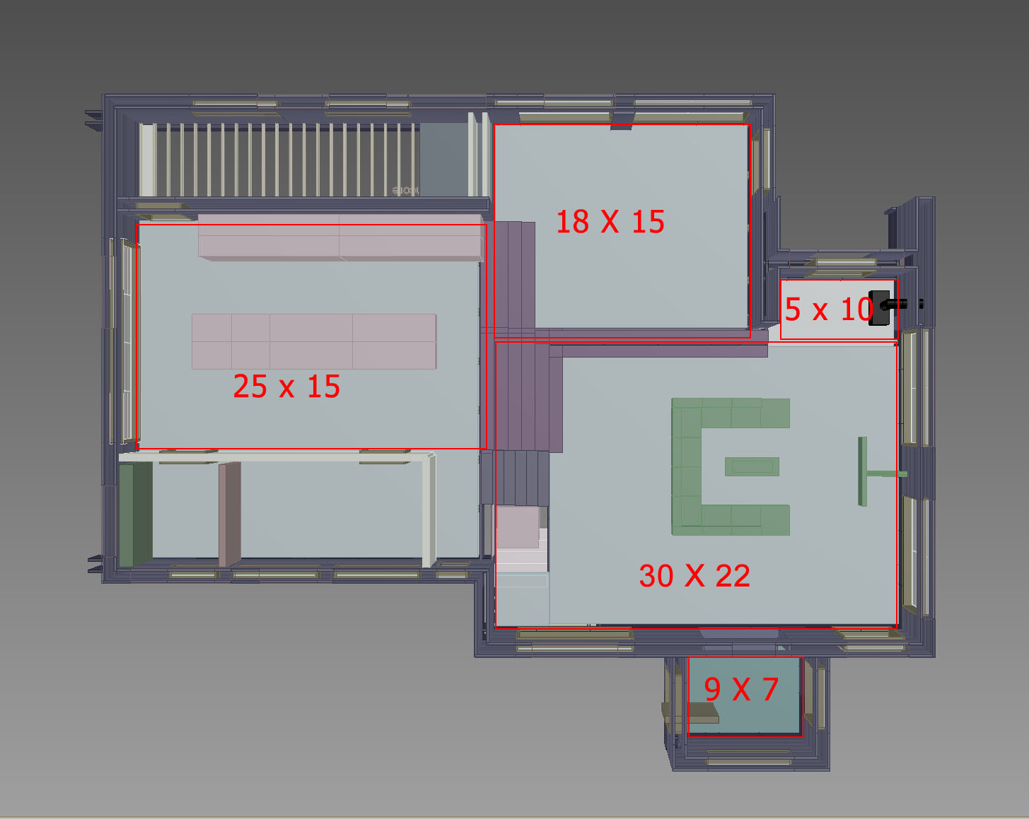

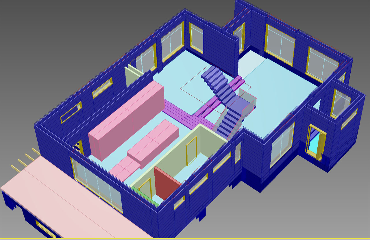

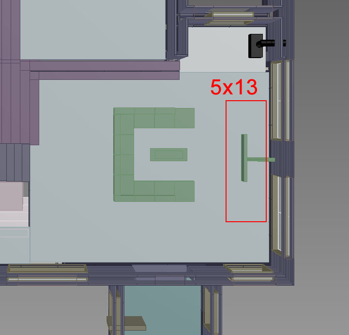

Here are a few quick 3d and plan with dimensions
the red square would be the " ideal " available space for the system
( including under behind the TV ..prob ~ 65" screen )
I have no problem placing subs elsewhere around the perimeter and i can add power outlets as required ( i did all the elctricity of the house, i made it so i can easily add as needed from the room under : )

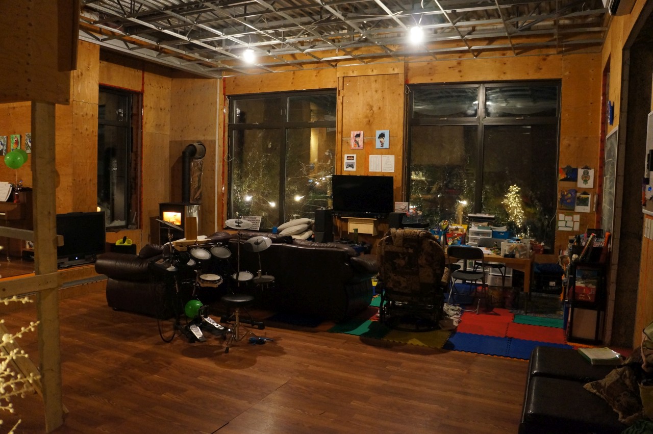

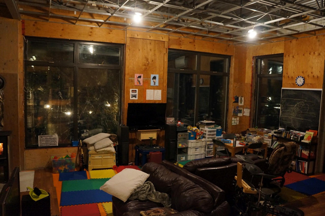

and the current state of the room
( i am currently starting the interior finish .... )
walls will be alum composite sheets and porcelain tiles
floors porcelains tiles
stairs are quartz
ceiling to be decided but that's my only chance to diffuse
and absorb
Please note the many windows, all are around 8X8 size .. i am pretty sure
i'll be getting some nasty stuff back from those
( but also need to keep in mind that we don't want to break them with the bass thank you ! ahha )

we home educating the kids so please don't mind the mess and tons of stuff 🙂
