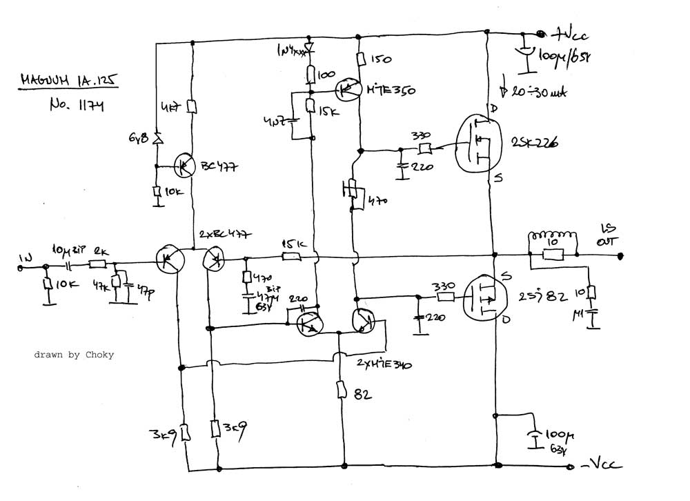

line stage is basically LTP with buffer ;
rest is MC stage with small bjts , few OPs as supply reg for MC stage , two SIP OPs for MM stage , rec buffer OP
power amp is slightly tweaked Hitachi schematic from their Application notes , but with typical Olde England diminutive Iq .
if you're interested - I can post schematic ( power stage is floating already somewhere on DiyA ) , for preamp I need to scan ......
recommendation - leave it as is - you can hardly squeeze anything better sounding in that case/heatsink
or - remove entirely preamp pcb , make decent input selector and attenuator and use just power amp as integrated .
I'm writing all this presuming that your IA120 is similar to IA125 , which I owned somewhere in the past

This amp seems somewhat different to the model you describe i would be interested in the schematics you have and would gladly send you a PDF of my schematic if you wish to compare them.

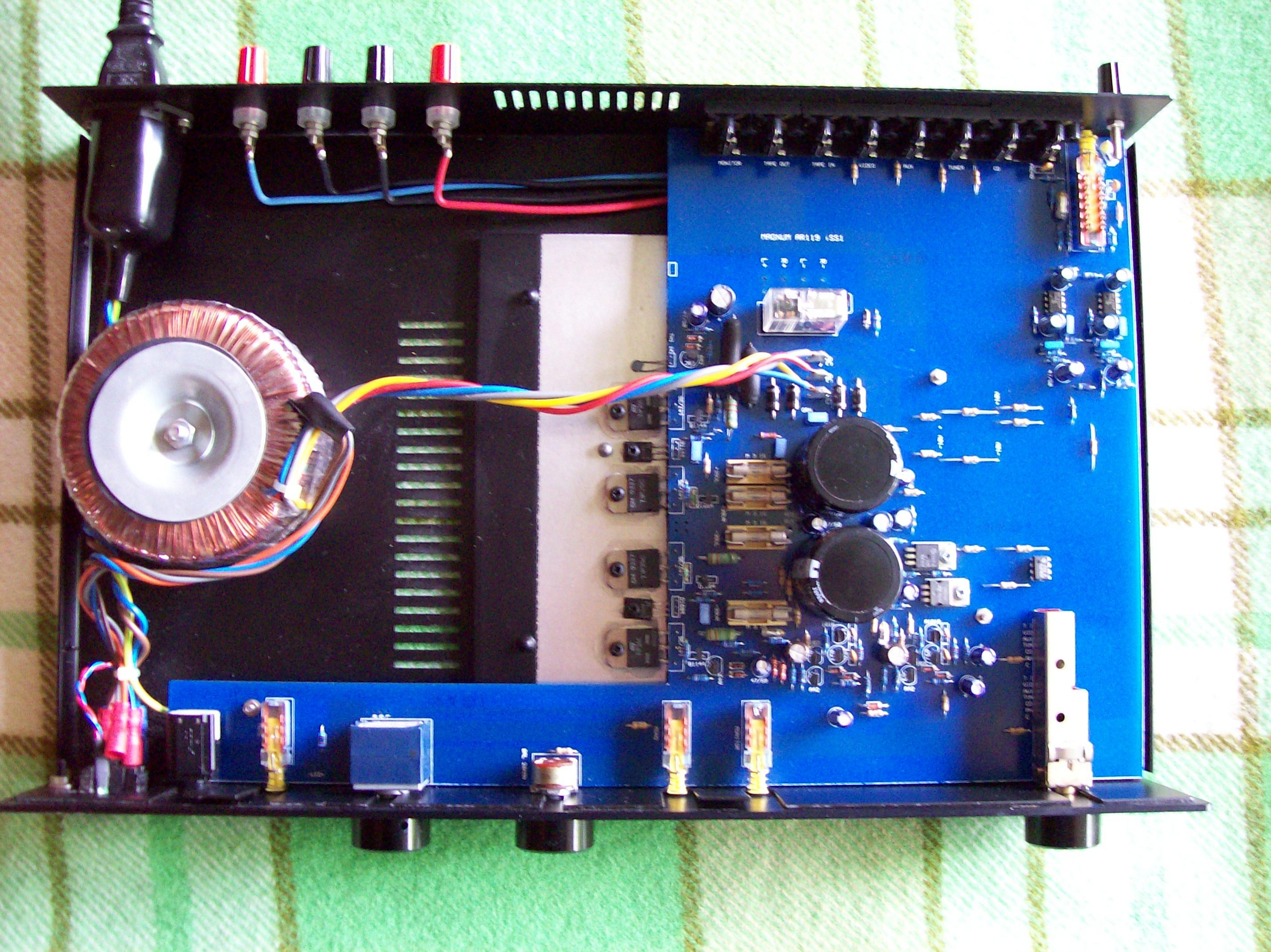

Hello, I just walked in your community for a problem to my Magnum IA120 amplifier, the mine has a different scheme and the chipset broken, you can know the name of this chip because I can not read the letters. Thank you
vincenzo
P.S. I can not insert a photo of the interior of the amp

i'm repairing a MAGNUM IA120.
One channel is working, the second has a DC offset of -44 V. Surprisingly the loudspeaker relais is on.
Many of the components are broken or burned, so that i cannot change it.
First I was happy that I found here a circuit, but i am not able to read the component values.
Have anyone the circuit diagram with a better quality?
