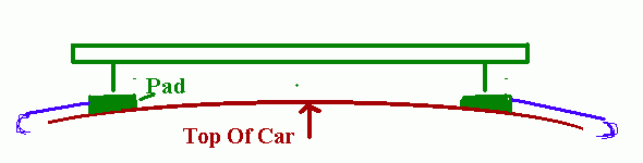

I have a second car, well used, on which I usually keep a simple ski rack-actually just two simple bars with pads on them. Crude drawing of one below. The pads are 2.5" by 4.5" with rubbery plastic on the bottom. The racks attach to the car by hooks which hook under the top of the windows.
The ski racks are useful in case I have to transport anything like plywood or ladders. The ladders I usually use are a simple 10 foot step ladder and the occasional-very occasional-20 foot extension ladder.
The problem is that I got rid of my old second car, for which the ski racks fit beautifully. My new second car does not have anything for the ski racks to hook onto in the window area.
I really, really don't want to glue anything or drill anything to the car rooftop. I've looked around for some comparable ski rack which might work, but I haven't found one.
I was thinking of taking flexible magnet material as anchors and gluing the bottom pads onto that. If that is not strong enough, I was thinking of several small solid magnets to be glued onto the pads.
A) Does anybody think the magnet material will be strong enough? I imagine a flexible magnet material piece of perhaps 4" square per pad.
B) How about some hobby small magnets, say one inch flat rounds Would several of them work glued to the bottom of the pads??
C) I would like to attach some thin material to the bottom of the solid magnets if I use them. Felt would be nice except I don't think it holds up to rain and snow well. Anybody have an idea for a fabric material to glue to the bottom of the magnets to prevent the roof from getting scratched?
I realize I am not giving you much in the way of specific figures here, but I think a lot of people on this forum have worked with magnets and can guess what flexible magnet material and hobby type solid magnets can and cannot do.
Any advice would be appreciated.

Variac said:How will you get them off?
Thank you for asking. 🙂
My basic plan is as follows.
Take piece of plywood a foot long by six inches wide, with a small piece of canvas underneath it, and place a few inches ahead and to the side of one of the pads.
Take tire iron or perhaps longer piece of steel pipe, slip between ski rack crosspiece and car top, and put one end down on plywood. The ski rack cross member should bisect the lever much closer to the end contacting the plywood than the end you will be lifting.
Lift the crossmember, which will cause the pad to separate from the car top.
With the lever still holding the crossmember in the air, slip a piece of two by four with a towel wrapped around it under the pad.
The first pad should now be separated from the car top by at least a couple of inches, well outside point where the magnets make much difference.
Repeat for other three pads.
I figure it might take five minutes or so to get the rack off, but I don't put it on or take it off the car that often, so it shouldn't be a bother.

There are a couple of things to consider with your idea KelticWizard. All of them point to don't.
First, with a lot of magnets, their force is in holding them together, which means pulling them apart is diificult, but you can slide them apart. Now, in your application, what direction are the main forces going to be in? Perpendicular to the magnet, meaning, while it will hold the roof rack down, it won't hold it in place. Particularly if you put felt in there to protect your roof.
Second, in addition to the strength of the magnet, you also need to consider the roof itself. There may not be enough metal in the roof to be able to hold the magnet well. I found out about this by watching a Mythbusters episode where they had magnets that worked great on 1/4" steel but on 1/32" sheetmetal ducting, they couldn't hold.
Third, if you're going to use the very powerful magnets others have pointed to, have you thought about what its going to do to the contents INSIDE the car?
Finally, the magnets you talked about have nowhere enough strength to do the job.

As mentioned previously, the holding force of the magnets is perpendicular to the face of the magnet. Friction is what keeps it from moving laterally. If your roof and the magnets have a large coefficient of friction then it might work. I have some neodymium - iron boron magnets (about as strong as they get) and they slide over finished steel quite easily. Stopping or turning sounds like a big risk, plus damage to the finish of your vehicle.
If you must do this, make sure the magnets have a large surface area, the larger the better, then roughen the mating surfaces to further maximize friction.
