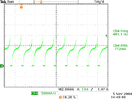

Tha FAN is DC 12V, but the current is fluctuating. Check the attached picture!
Sajti

DC brushless fans are not DC. They have a circuit inside that creates 3 phase pulsed AC.
