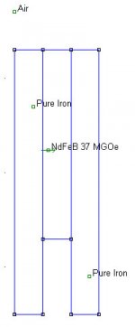

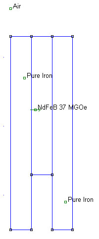

Hello,
I want to experiment whith planar and ribbon and want to do this kind of magnetic circuit :
(The schematic is not in scale.)
I wanted to know which metal to use for the best field in the airgap, pure iron, stainless steel, silicium steel, and where to find it...
Thanks a lot
Hugues

Hello,
Any regular mild steel will work well... it has low cost... and is relatively easy to cut and form.
Because your magnetic field is constant (not moving), the "magnetic" properties of the steel are not important.

Actually, pure iron is rather hard to find and poor to work with... What will work for you is "MILD STEEL". Steel is essentially Iron with a small amount of carbon.
And yes, the thickness will matter. The steel should be at least as thick as your gap is long (not the thickness of the gap). The shape is extremely important though. These days the shape of magnetic components is designed with software... it is rather complicated, but there are people on this site which can do magnetic modeling. It is also possible just to sketch something out and get a decent result.

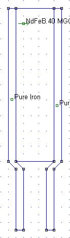

The problem is that I have to do something like this (picture bolow, in scale, one dot=1mm) and I have not space on both side to put so a lot of iron.... The best I can do is 1,5mm of thickness for the iron.
Do you think it wil work properly???
No, I do not think it will work well.

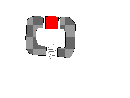

Try to imagine a shape like a "C". Cut the "C" in the back and place your magnet there.
Why must your design be so narrow?
Sorry but I don't understand. Can you make a sketch if possible?

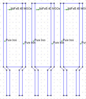

Because I have to put some same other magnetic system just near this one, something like this...
Stainless steel is not a useable material. Just model with mild steel and don't worry about pure iron or permendur which is probably unrealistic to source and machine.

You will have to comprimise your shape. The flux goes where it wants to... you can only help guide it.
