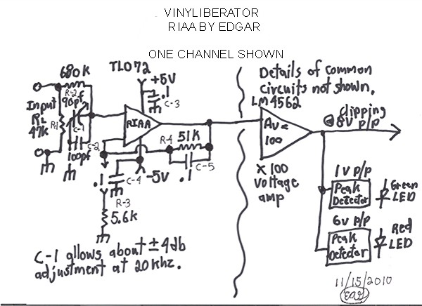

I will soon have a turntable and cartridge that I'll be able to install my proposed Cartridge Interface Buffer in. Does anyone have experience with placing resistor/capacitor loading with a unity-gain LM833 buffer intimately, in a head shell, immediately behind the cartridge. My theory is that such an arrangement will provide optimum, stable cartridge loading, while converting the cartridge output to low impedance, sharply reducing tonearm wiring and interconnecting cable hum pick up. It should, at least, sound good, so I should be able to post results on You Tube in a couple weeks. What do you think, Guys. Thanks.

I'll have a standard 47k at the buffer's input and while I'm not sure what optimum capacitance is for the AT92ECD, I'll probably go somewhere between 270 and 470pf, also at the buffer's input. I think the mfgr's allow for 100-200pf cable capacitance and I'll take that into account, too. I'm watching this thread and still comtemplating how to go about this project. I'll be building on a less than 1" X 1" perf board, so the board shouldn't weigh more than a few grams, hopefully allowing total cartridge/buffer weight to still be within limits for the Akai AP-D2's tonearm. Best Regards To All, Edgar

Hi, fair enough, but I cannot see any real advantage over the usual arrangement, rgds, sreten.
(And I can see some noise issues with a less than ideal buffer op-amp.)

I'm a bit wary of the potential for noise, myself, and I think noise should be minimal, as the buffer stage will run at unity gain. There is, of course, some noise added to the system by a unity gain stage and one objective of my experiment is to determine if the added noise can be heard, and if audible, do any sonic benefits outweigh the added noise. Advantages are only theoretical at this point, but I expect less hum pick up from tone arm wiring and greater immunity to electrostatic hum pick up by less than perfectly shielded interconnect cable between turntable and amp because of the LM833 buffer's less than 1k output impedance. I'll also be able to "cut n try" various loading capacitance values. Best Regards, Edgar
You are simply adding noise, weight and complication. The cartridge itself has a low impedance at hum frequencies, so a unity gain buffer won't help there. The cable will already be at least pseudo-balanced so pickup should already be largely cancelled. Capacitive loading is not a problem as the cartridge is designed to require it. All the normal reasons for a local 'head preamp' don't apply. If the problems you are trying to 'solve' really existed then you would not want unity gain anyway, but 10-20dB. People don't even do this for MC cartridges.

Hi Guys, my Akai AP-D2 turntable and AT92ECD Cartridge have been here a few days. The non-removable headshell, while small and having little mass, has "thong" coverage and obviously no space for even my very compact interface board. I didn't even consider using my interface. I built it beforehand, so I may test it, external to the headshell, at a later time. I did design and build my VinyLiberator pre-amp board, as demonstrated in the You Tube Video.
I had absolutely no problem in empirically determining the proper component values for proper RIAA Playback response by simply using my Audio Generator and 'Scope. The 90pf trimmer is quite noisy while being adjusted, but gives a sweet +/- 4db or so "fine tuning" range at 20khz to bring overall response to optimum. I didn't use a cartridge load capacitor because recommended load capacitance was 100pf and is approximately the value provided by tonearm wiring and output interconnect cable. The pre-amp seems only a little noisy and sounds really close to RIAA, as far as I can hear. Thanks, Guys
