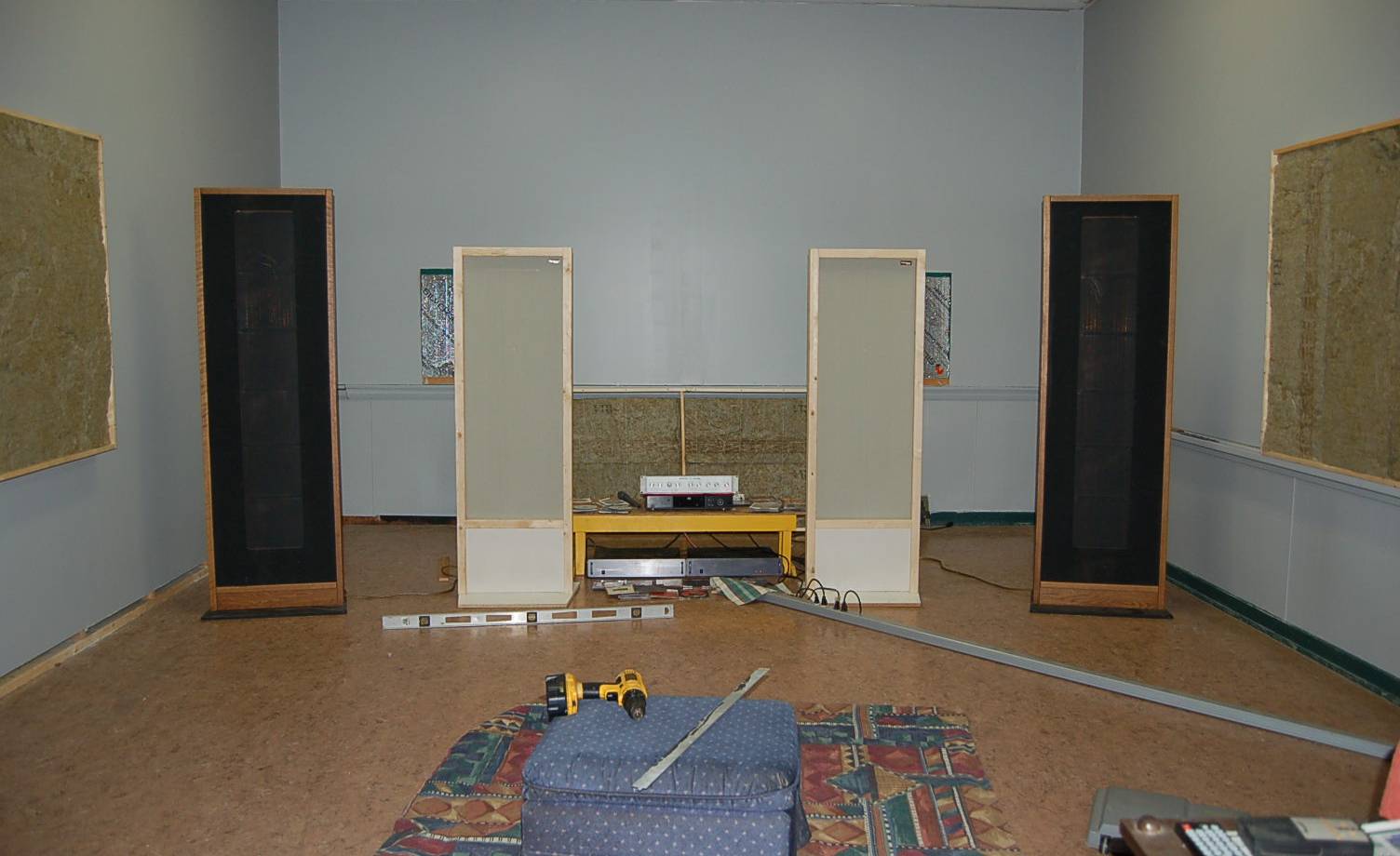

Just bought a pair of Maggie SMGA’s. In good condition with no delamination.

using a lighter material to wire a mid/tweeter section should not be of any concern but the bass panels depend upon the physical mass of the wire and the adhesive to lower the resonant point of the diaphragm so that they can make bass.
