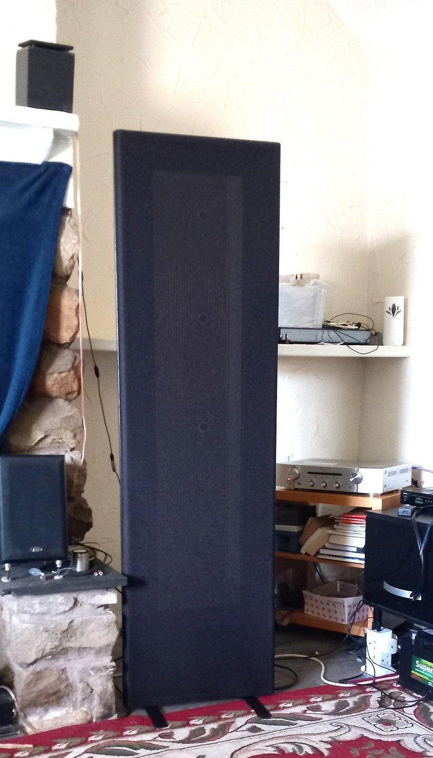

and decided to take a chance on the MG1.6i QRs from a busines seller. They arrived yesterday in their original packaging and were soon unpacked and left to acllimatise for an hour. At 64" tall and 19" wide, they dominate my modest lounge and were located 1m from the wall and 1.5m from the side walls, angled in slightly.
I knew my 35w PP valve amp wouldn't be happy driving the 4ohm power hungry load so I connected them to a Marantz PM6007 integrated amp using it's onboard AKM dac to convert the optical SPDIF output from my LG tv.
Theen i sat back, not knowing what to expect or even whether they would be defective but wow, memories of the Aeons came flooding back with their great transparency, accurate 3D sound stage, smooth frequency reponse and absence of exxcess treble or bass.
I was certainly hearing more than my Naim SBLs delivered, in particular, the ambience of the recording venue was very noticeable.

Yes, as they have been unused for possibly months, I may well hear differences after a few weeks. However I can say that they go low, no sub needed.

Congratulations! The MG1.6 was a very successful model for Magnepan.
They convey the ambience of the recording venue extremely well (on recordings that have natural ambience). The impression is not one of listening to speakers. This can be a revelation.
The MG1.6 really does need the low output impedance and high current drive of a solid-state amplifier.

I have a calibrated mic and REW to do some measurements. There is quite a sharp peak at a room eigentone around 60-70Hz which may be difficult to damp but it's not overly troublesome. My room is a bit on the small side for them.
I might experiment with some absorbers on the wall behind (not for the LFs) to see if the imaging is even better.
