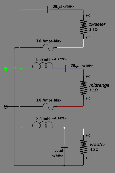

Magnepan 2.7QR xover
Not sure it right....this did not come from Magnepan….but I bet you could get one from them .

ideally, transparency and possibly to bring the midrange forward
i have an apogee stage with a north creek xover and that brought the performance leaps and bounds
i heard that the xover component from maggies of that era are adequate and aimed at cost savings, so thought maybe going fancy and posher would yield a better performance after all

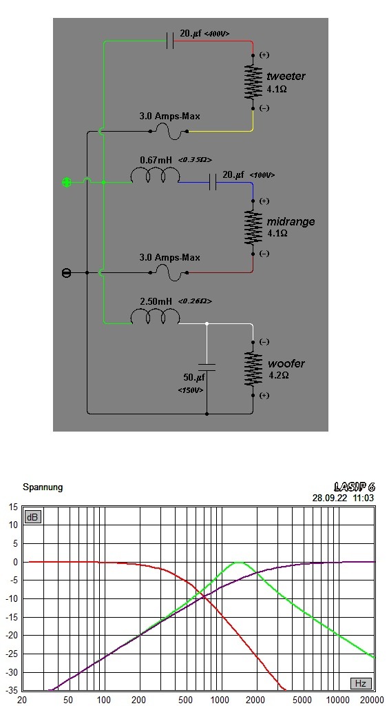

To have the midrange more forward, you need to decrease the bass and tweeter. That can be done by going to an active crossover and use double power amps. For instance one stereo amp per speaker. One channel for the bass and the other for mid/tweeter. The passive crossover bass to mid will not be used. You keep the passive crossover for the mid/tweeter and have the possibility to set the tweeter level with a series resistor. The level between bass and mid/tweeter can be set at the line level active crossover. The active crossover could be a little miniDSP. It has a lot of possibilities!
A question as I have no personal experience of the 2.7. Do they have the magnets in front of the diaphragm or behind? If they are in front, you can turn the speakers or the drivers around. That changes the tonal balance a bit when there are less obstacles in the way to your ears.

Magnepan where the bass, mid and tweeter share the same sheet of Mylar is a bit different than separate drivers for each register. There is little to gain using an active crossover mid-to-tweeter. I would begin with following the original slopes and take from there.
I had a pair of gunned 2.7s for a few years. To my ears they were far better than the stock speakers. One thing to consider is he tied the tweeter and mid together to turn them into a 2 way. If I am remembering right the mid and tweeter were both out of the QR wire.
