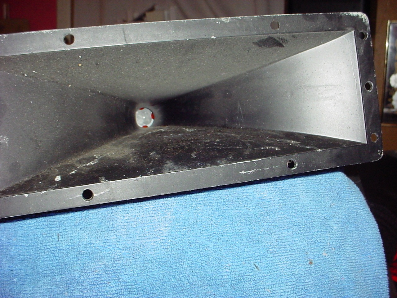

I have a pair of Magnavox 580088-1, 70.50 horn's and I,ve been looking for specifications on them, so that I may try to design a proper crossover.
Also, If any one has any driver recommendations, this would be really appreciated.
I did some googling and searched here, but did not seam to find much.
The pic attached is close to what I have, but not them. I found this pic in a ebay auction, and decided to use it as its a much clearer picture that what my poopy digi-cam can do.

I have a pair of those. They were made by Foster.
Real screamers! Can be super harsh. If crossed up high enough, they're OK. At the moment they serve as rear firing tweeters on my open baffle. You can help them some by damping the back plastic cap and the outside of the horn throat. But a lot of the harshness comes from the driver itself. A resistor will tame some of the peaks.

Any more written on them? Indeed Foster made some of them, but i have also had the same made by Jensen & by Heppner.

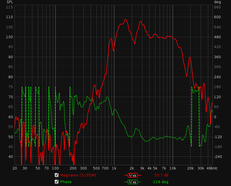

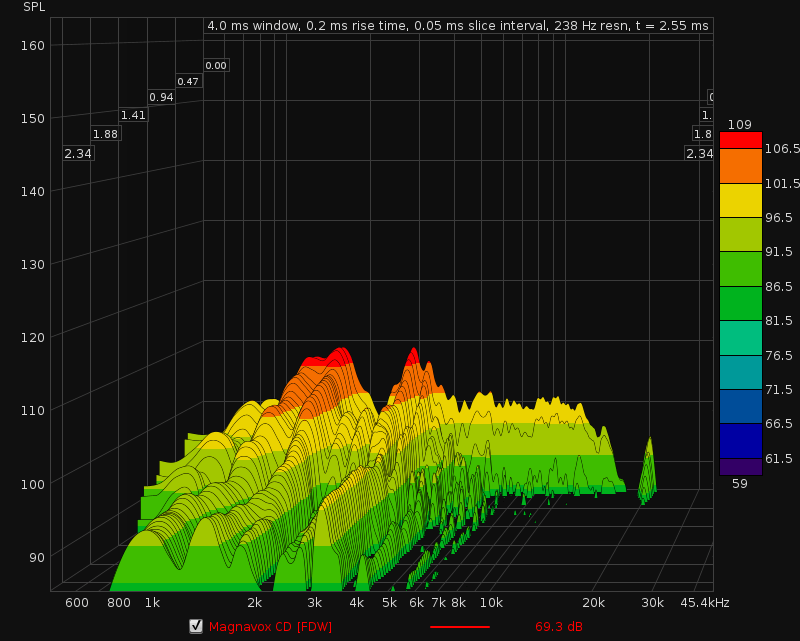

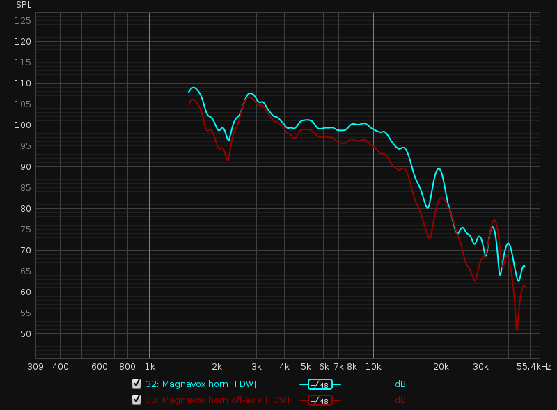

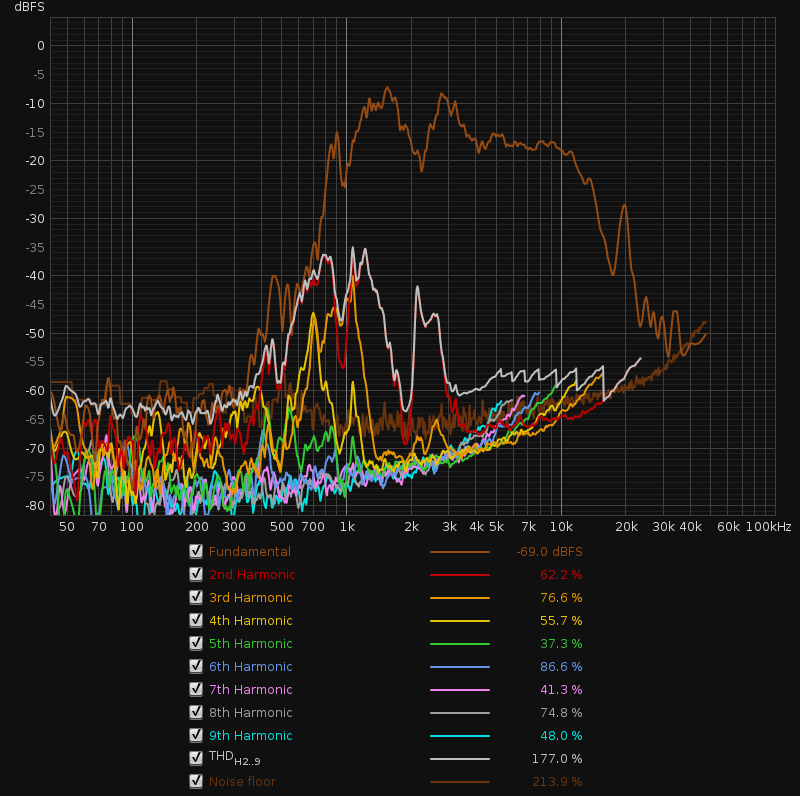

Just in case anyone cares about these horns, I guess I'll drop this here. Magnavox 580088-1 with Foster logo.
SPL is not calibrated but it shows smooth response above 4k, even the waterfall chart isn't too bad. Distortion below 4k is very bad and very audible. This is without a baffle, not sure if a baffle would make a meaningful difference. Holding the back cup in my hand makes no difference to the distortion or response.
Unfortunately it looks like there is really only one octave of good performance in these horns, and they only go up to 12k or so. Maybe 2 octaves if I'm doing something wrong to ruin 2k-4k.
