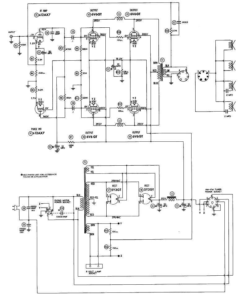

Picked up a 1957 mono Magnavox 142-BC a couple of months back. I've been thinking about making it into a guitar amp. It uses four 6V6 GT tubes in a push pull set up. Would it be possible to separate it into two channels, one clean and one not so clean that use 2 tubes each?
The 142-BC is only a power amp. A very fine power amp! Do NOT start cutting it up!!
A quad-team of 6V6 can be a very fine sound.
For guitar you need a preamp in front.
A "two channel guitar amp" is (almost always) two *preamps* into one *power amp*.
So build two preamps, mix/switch them into the Input of the AMP142AB.
Yes, it would be "possible" to make two power amps out of the 142AB, but you would need to scrap the probably-fine output transformer, buy two new output transformers, add an additional 12AX7 for 2nd channel driver, and it still would not be a guitar amp without preamps.
The "Tuner Power socket" can supply power to a reasonable number of preamp tubes. (Or a JFET or opamp: it has 18VDC bias on the heater lines.)

I do have the 165-AA pre that came in the console. I brought it up on a dim bulb tester, it passed with flying colors. Yes, I will do a proper chassis ground.

I'll probably just go ahead and rebuild the amp as it is and let my son try it using his Pod. If is doesn't have enough volume or he needs more tone control, I'll build a pre.
