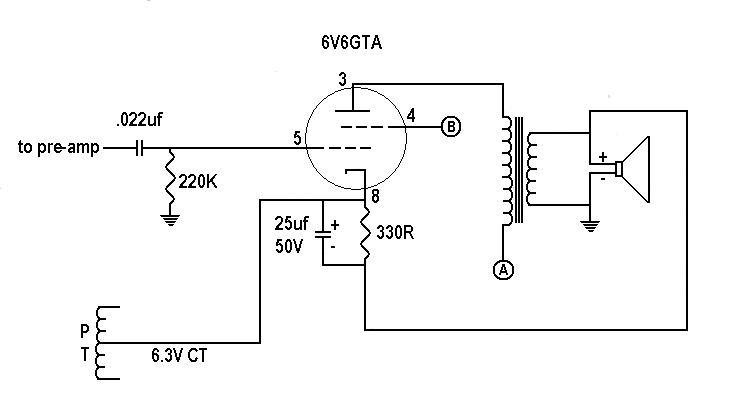

I was just looking over this amp for restoration and found very little documentation other than a rough hand drawn schematic.
Anyway, I thought someone might be interested in this power section. Oddly rather than directly grounding the cathode & bypass cap on the power tube, they route it through the speaker/ot secondary?
Can someone give me any insight as to what the influences of this might be?
See picture.

It's a form of negative feedback. You'll see it in some HiFi amps. If they are push pull, the 4 ohm tap will be grounded, the common terminal goes to one tube and the 16 ohm tap goes to the other. Before you ask, the 4 ohm tap is the center tap of a 4, 8, 16 ohm output transformer. Do the math, it takes twice as much voltage to make the same power in 16 ohms as it does for 4 ohms. There is a mod for the Dynakit Stereo 70 that uses this.

OK, That makes sense,
This is just a simple 4-5W SE amp, no extra taps, but I assume the concept is still the same.
First time I have ever seen this in a guitar amp.
