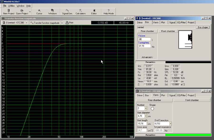

I am thinking about this good price sub magnat XTC 300 for a home theater use and so i run a simulation with it.The problem is tha i dont have all the T/S parameters and i would be very happy if someone knows anything about them.

Any coments about the simulation ?does it look ok? What about the sub?Has anyone used this sub for any use???😕 😕 😕
I don't know, but being down -22dB @ 20Hz doesn't sound like a good start for a subwoofer system.
Yes your right but i didint expect beter Considering the price from this sub.With my little expirience i think that the F3=40Hz isint so bad or is it??? I traid to for a lower F3 but i couldent do somthing beter in vented. Is it posible to do something els to improve it?

looks like a small box and a high rolloff. What does the excursion graph look like at 250W? I would try for a larger box and lower tuning. Something like 60L and 25-30Hz?
DcibeL said:looks like a small box and a high rolloff. What does the excursion graph look like at 250W? I would try for a larger box and lower tuning. Something like 60L and 25-30Hz?
The excursion graph showes nothing because i dont have the Sd parameter of the sub.Is there a way to find it ???I couldent make the grap linear for a biger box and lower tunig. Maybe i am
mistaking somewhere🙁

You should geta good idea for the area of the cone (Sd) by measuring the diameter of the cone and using the area of a circle formula. I think it is area = pi*radius^2.
