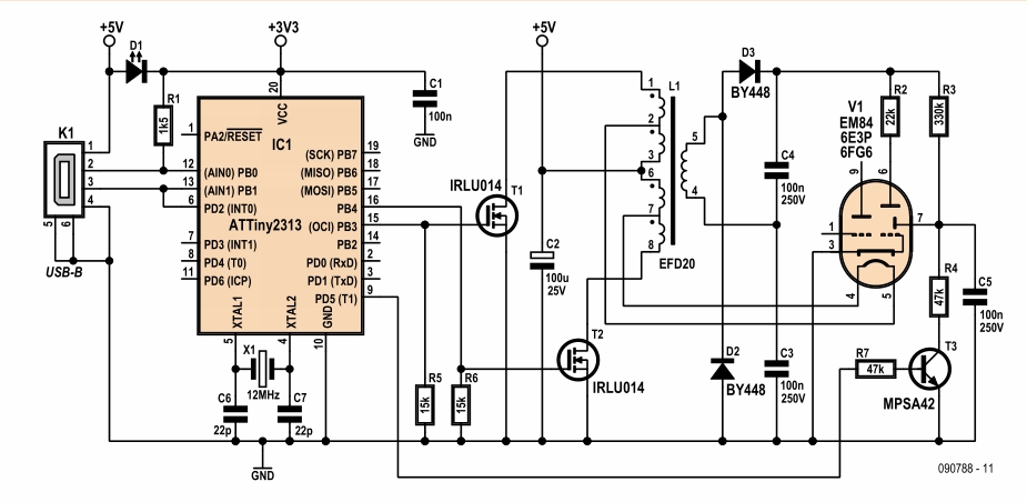

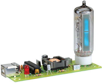

Hope this is the correct area to start this thread...anyway in the January 2010 Elektor magazine it has an article on a PC USB load indicator using a EM84 Magic Eye tube.
http://www.elektor.com/magazines/2010/january/usb-magic-eye.1191254.lynkx
I was after some advise to use this as a base for an audio line level VU meter.
The main advantage is it works off the USB 5V supply so was after keeping this and running it off a 230/5V plug in mains unit.

No mention of where the tube is powered from, but it's gotta be one heck of a step up power supply to get 250v from 5v. Never mind the 6.3v heater. I don't know what the min plate voltage is for these, but I've always seen them running more than 200v. I had one of those tubes but the phosphor was completely gone. There is a Russian version available.
It is 250V, but at relatively low current. USB can source up to 500 mA to a registered device so consumption should within standard specifications.

The 6.3v heater and the 250v is supplied from a self wound pcb mounted transformer via the USB supply but would like to ditch the USB part and run off a 5 or 12V mains plug in unit, and line level source.
Note pin 1 and 9 is not used in this configuration.
