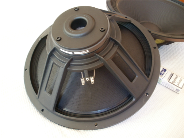

Allow me to introduce MAG M1510 the FIRST Ukrainian Free-Air speaker size 15" or 38cm.
the Main advantages of our design over the competition are:
1. Aluminum cast frame.
2. Double-sided winding voice coil with a diameter of 51mm.
3. A surge in core Magnet System to increase the stroke of the movable system.
4. A sufficiently large stroke of the movable system and to develop sound pressure.
5. Light and stiff paper cone.
6. Very linear frequency response over the entire range of frequencies up to 4 kHz.
7. The advantage of this bass-midrange speaker in that it can easily provide smooth frequency response and sound in the band from 20 to 3 kHz .
8. Higher sensitivity in the bass !!!
9. Very low resonance frequency loadspeaker.
10. At a comparable cost with competitors is a much better design and of technical and musical settings.
11. The continued availability and minimum delivery time of a particular speaker to the buyer.
12. High repeatability of parameters in the products.
13. Quality control of manufactured products.

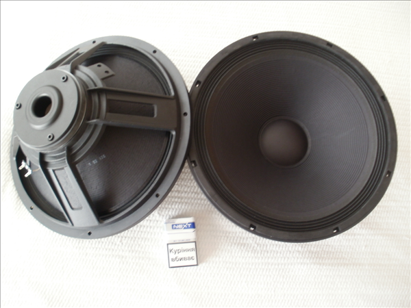

Low-mid-range 15" speaker MAG M1510-F
Structurally, these dynamic MAG head consists of two easily separable and self-centering of the component parts: aluminum die-cast frame with glued movable system and the magnetic system. This design was proven successful and allows you to quickly and easily make a diagnosis, and (if necessary) and repair of dynamic heads.

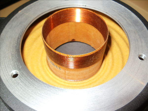

In voice coil used bilateral winding (with inner and outer sides of the frame). This design greatly improves the cooling of the windings of the coils. The hole in the core of the magnetic system has a diameter of 35 mm. Measuring complex CLIO Italian company Audiomatica, which is located at the factory, allows you to perform all the necessary measurements in the development of new speakers, and control the parameters of the speaker units and speaker systems in the manufacturing process.

Works great in the clear Box of 100-150 litres or shield for example 1200x1200 mm or x mm. In the first case (Open Box) resonance frequency drops to 27-28 Hz, and the quality factor is increased to 1.

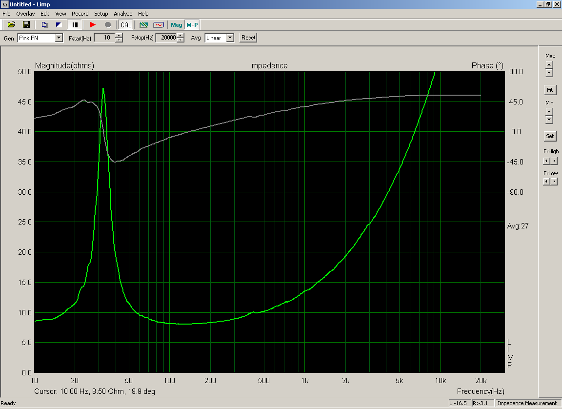

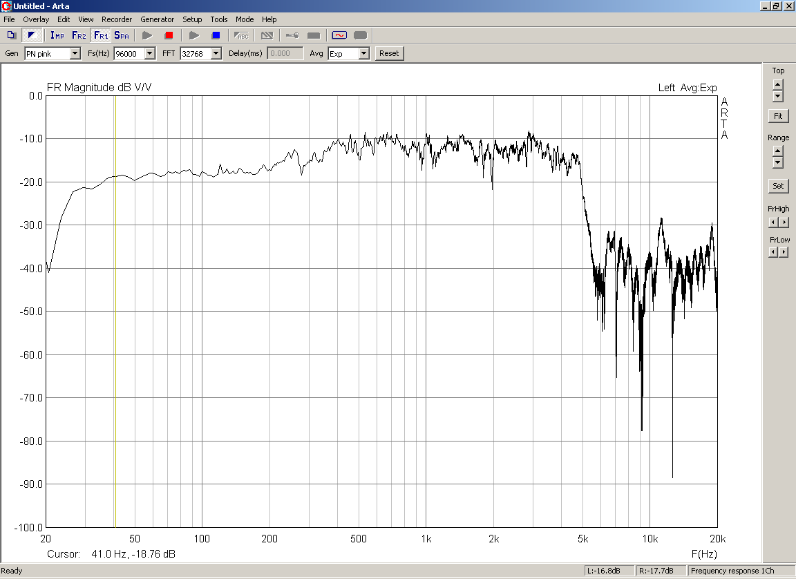

Below are photos and Impedance Frequency Charcteristic, Amplitude Frequency Characteristics unheated dynamics.
AFC removed the speaker in open space, with a distance of 31cm.
As can be seen the influence of the Acoustic Short Circuit starts to affect with 300 Hz and below.
