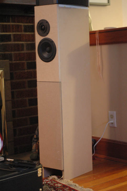

Just completed a transmission line using this kit. (I'll post photos and info when I have more time).
They sound great. When I'm listening to these I keep thinking its insane how much they cost.

hi Prasad,
Here is a brief description:
internal width - 6"
top - 10"
bottom 1"
line length 39"
the overall height is 40"
the line opens at the bottom
I placed the mid at 12" from the top which may be slightly high. Im not sure if this has negative effects. I haven't been able to do any measurements since setting this up will take too much time and we have a four month old baby.
They are stuffed from the top to about half way down the line. I think I'm leaving it this way.
I'll post the pic before I go to bed.
I've never built a TL before and there are people around here that know alot, so if your interested in building this, get some other opinions and look for the thread on here titled something like rb kit transmission line. GM posted some specs which were close to this.
If anyone has any thoughts on this project, please speak up. I intend to rebuild this cabinet with better material and contruction at some point.
